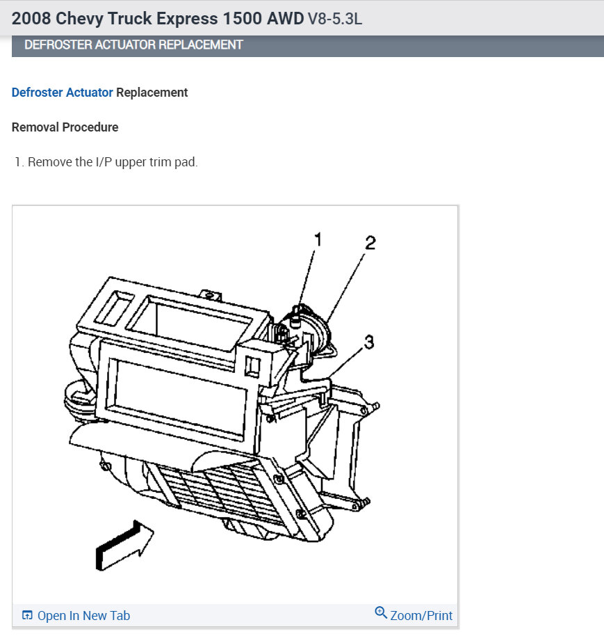

Temperature blows correctly, but air stuck on defroster.
Nov 3, 2022 at 10:40 PM
  • 55,202 POSTS
This happens when the HVAC system loses the vacuum supply to the system. Check under the hood and looks for a small vacuum line that heads into the cab this will be the line that is broken. here is a guide that shows what I am talking about, and I have included the defrost actuator so you can check that out as well.
https://www.2carpros.com/articles/air-vents-stay-in-the-defrost-position
Check out the images (below). Let us know what happens and please upload pictures or videos of the problem.
