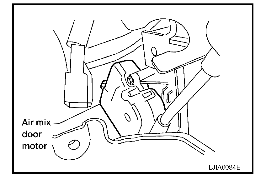

Hi:
First, here is a link showing in general how a blend air door actuator is replaced:
_________________________________
Here are the directions specific to your vehicle for replacing the blend air door actuator. The attached pictures correlate with the directions.
2005 Nissan-Datsun Truck Quest V6-3.5L (VQ35)
Front
Vehicle Heating and Air Conditioning Air Door Actuator / Motor Service and Repair Procedures Manual Air Conditioner Air Mix Door Motor Front
FRONT
AIR MIX DOOR MOTOR
Removal and Installation
pic 1
AIR MIX DOOR MOTOR (FRONT)
Removal
1. Remove the lower driver instrument panel. Refer to "Instrument Lower Panel LH".
2. Remove the center console trim panel.

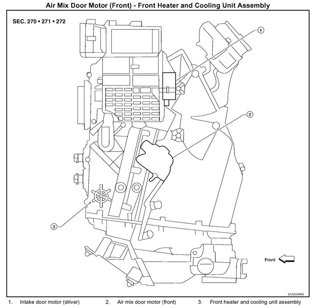

pic 2
3. Disconnect the air mix door motor electrical connector.
4. Remove the three screws and remove the air mix door motor.
Installation
Installation is in the reverse order of removal.
