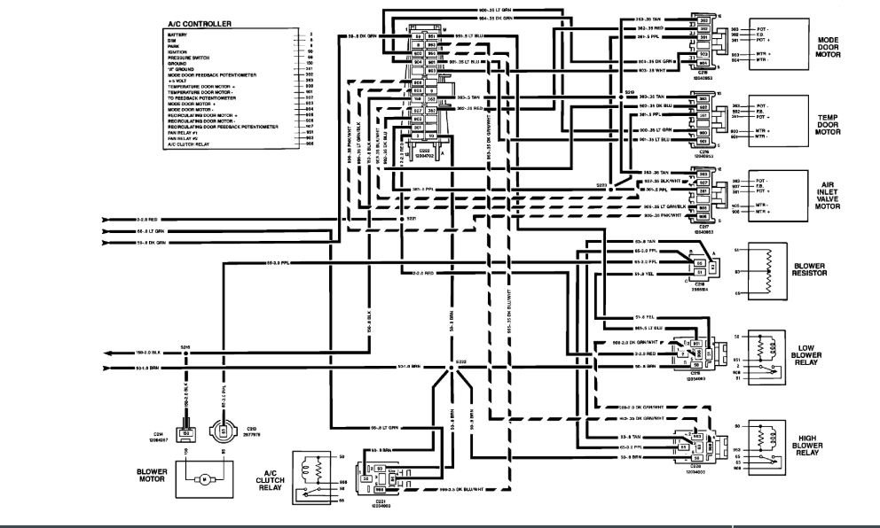

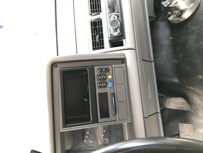

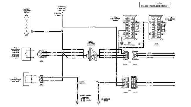

Started the car for the summer, battery was dead so i had to jump start the car.
Car starts, all electronics work exept for the display for AC/Heater. The fan will not start.
Checked fuses in the fuse box, they are all good.

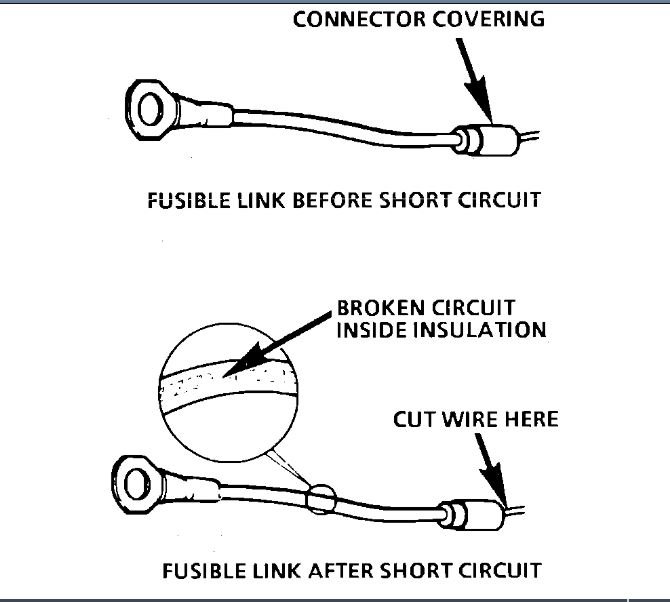

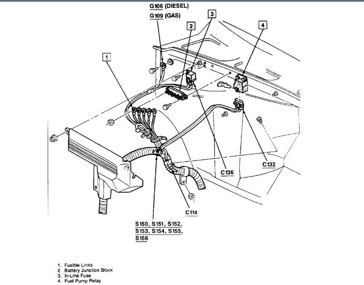

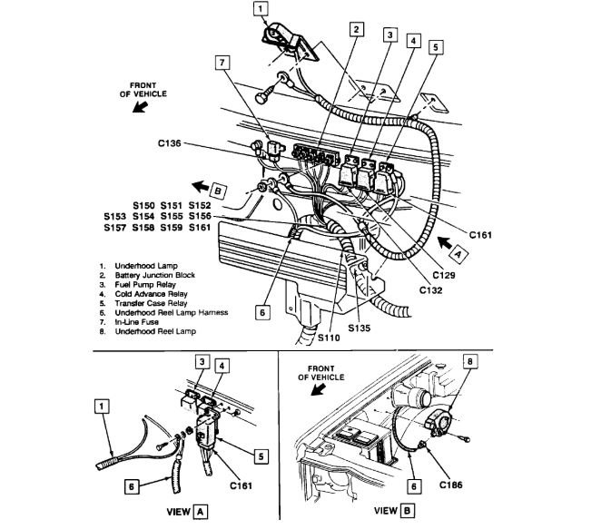

I read something about the fusible links under the hood, does anyone have pictures on these cables?

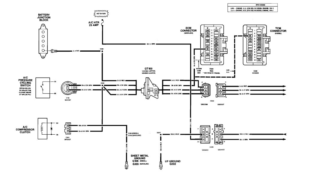

Good morning,
I attached diagrams of the connector for the control. You need to verify power to the connector in the terminal marked battery power.
If you have power, the control head is bad. If you do not, then it is either wiring or a link.
I attached the locations of the fusible links.

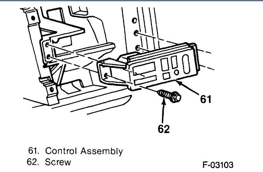

Okay, so where is the control located? Is that the display, so I remove the dash and check the back of the display?
Apr 11, 2020 at 1:05 AM
Correct. Remove the bezel around the control head and then there should be a couple of screws to remove.

Can i check the fusible links with the light pen? If so, how?
Apr 11, 2020 at 4:48 AM
You test for power on either side. The stud should show power and the wire at the end of the fuse wire should have power as well.
