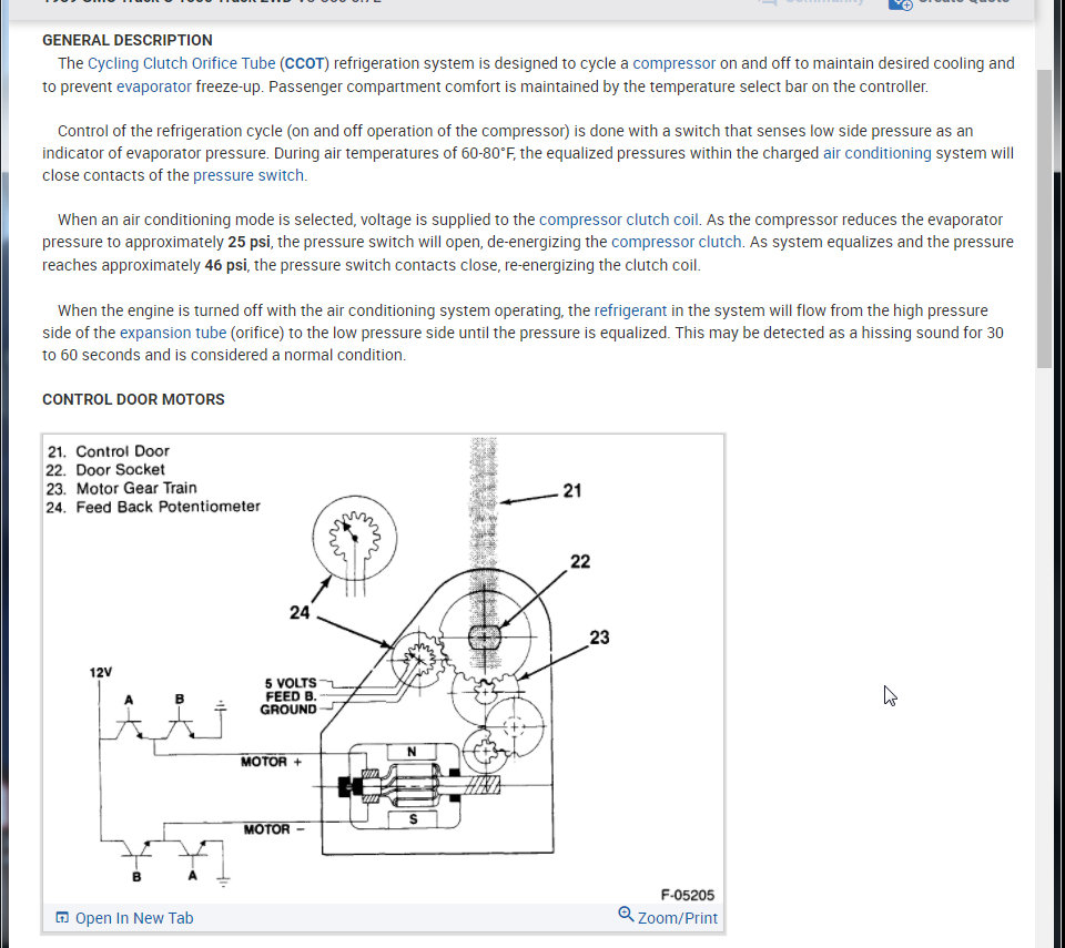

Here is a video that will help with this issue in more general terms:
https://youtu.be/SNRb6pSwYuU

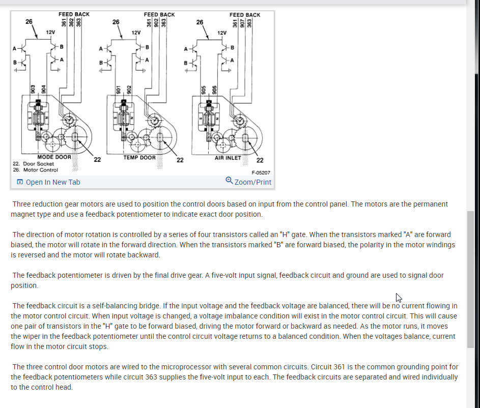

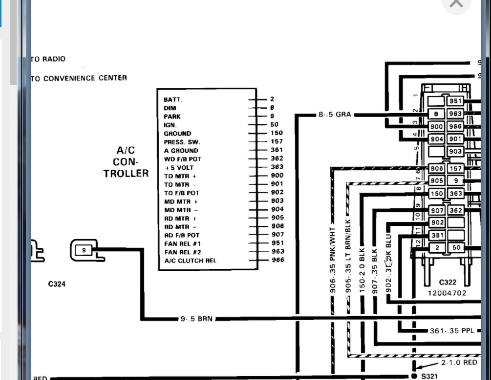

I attached below a pinout of the control module which I suspect we are going to have to check for power at the B+ and ignition feed and go from there.
