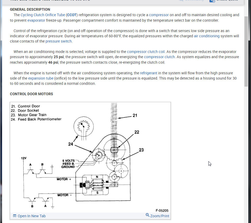

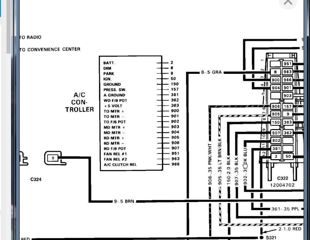

I attached below a pinout of the control module which I suspect we are going to have to check for power at the B+ and ignition feed and go from there.
