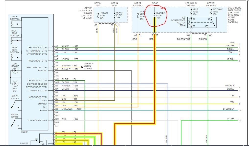

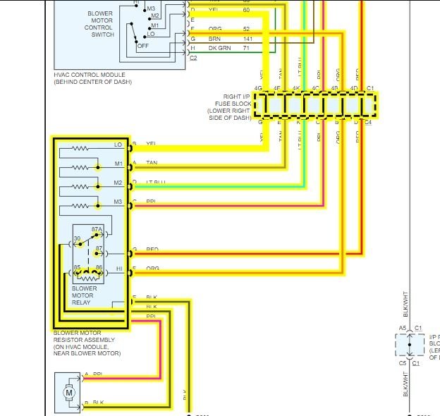

I have replaced all fuses and resistor pack along with replacing climate control . I am not getting any power to the resistor pack plug is there a breaker between the climate control and the resistor pack that could have gone bad? I am at a loss and can't figure what else to do.

Good morning,
I attached a wiring diagram for you of the blower system. The red wire comes from the fuse block for the resistor. I circled the fuse for you to test for power.
Let me know the results.

BOBBY BENWAY
Fuses were good , found a break in red wire.

Good find.
Is it working now?
Jun 10, 2020 at 5:11 AM
BOBBY BENWAY
Re-spliced red wire and re-synced blower doors . Works great, thank you.
