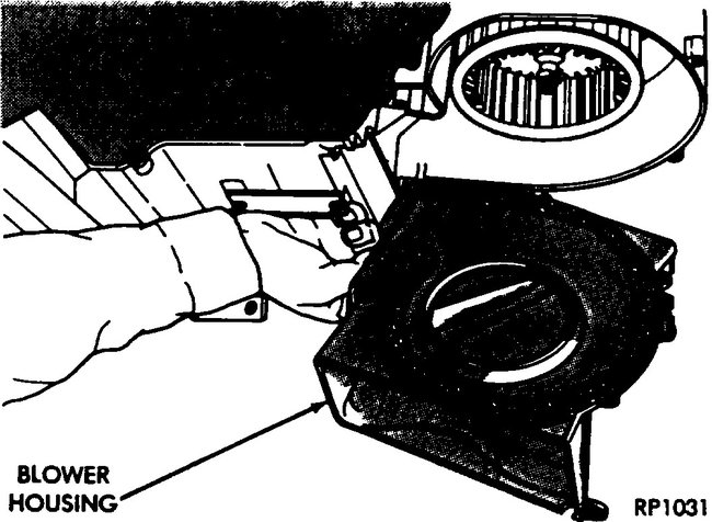

The previous owner removed the blower motor. I bought a new blower motor but can't figure out where it goes. I removed the glove box, but still can't see a spot where it would comfortably fit.

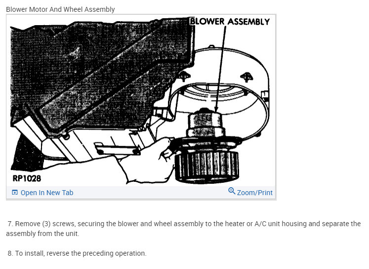

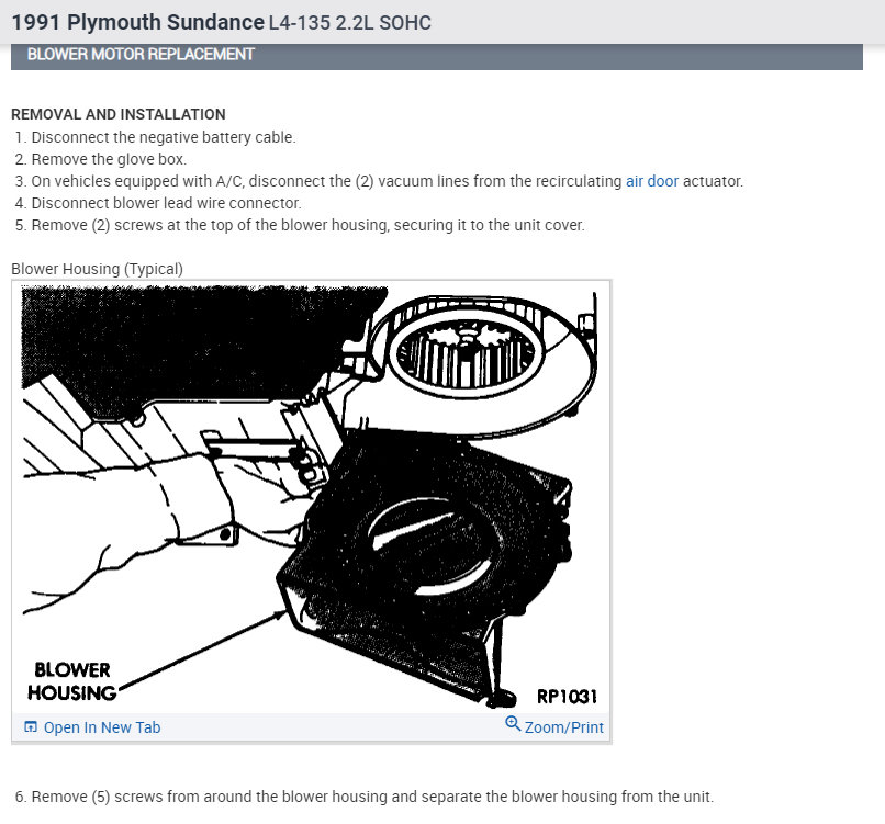

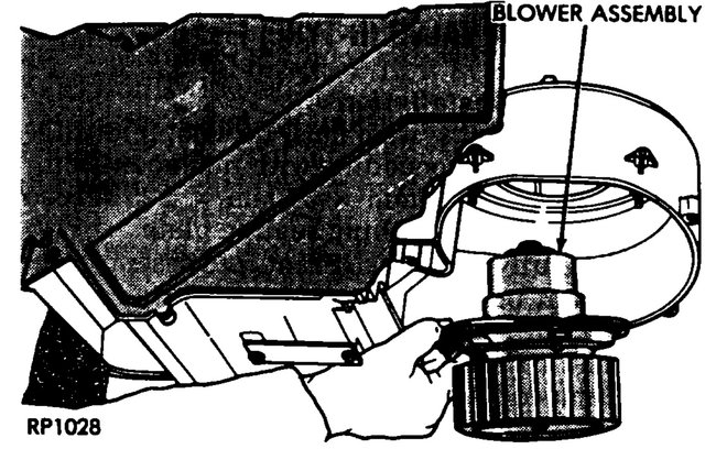

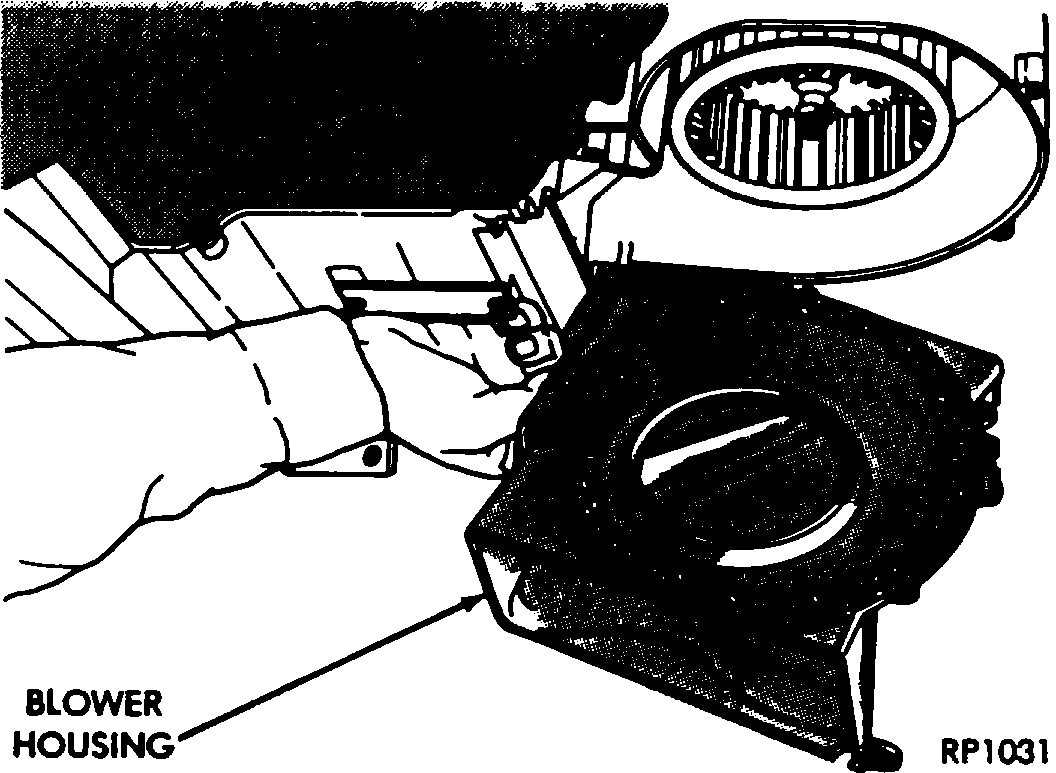

It actually fits inside the housing with the motor pointed up. With the glove box out you should see a cover held in place with a few screws, Remove that cover and look up inside the housing. You will see where the blower motor mounts with the motor up inside the dash. The electrical connection is up on top.

The blower motor for this vehicle is located behind the glove box.
You will have to remove the glove box to have proper access.
Also, there should be a housing that the motor will fit into.
Are you able to find the housing?
See attached diagram for reference.
Let me know of any questions.
