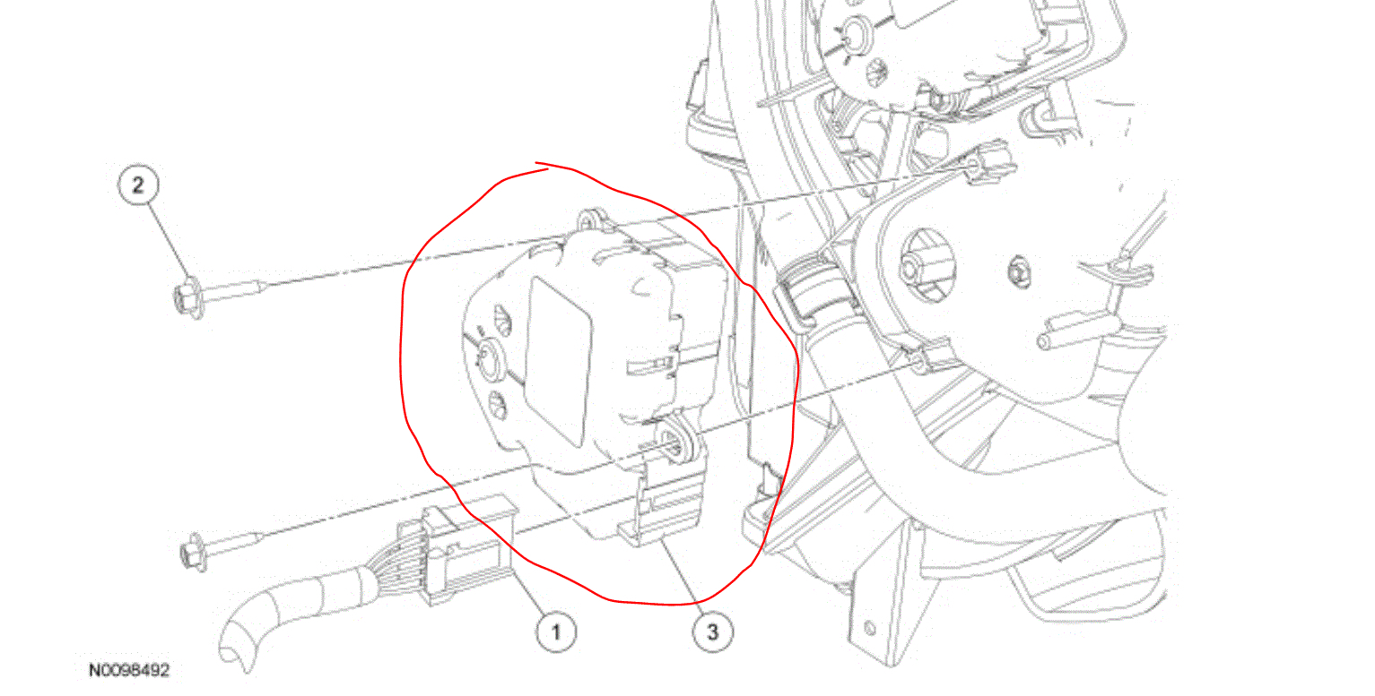

What you described sounds like a faulty blend air door. Has it started working again properly or are you still having problems?
The blend air door actuator is what is used to allow either cold air or hot air to enter the vehicle. It's located under the dash on the HVAC box. I attached a pic below of the one responsible for the driver's side of the vehicle.

Honestly, it sounds like the actuator may be going bad. That is my first suspect.

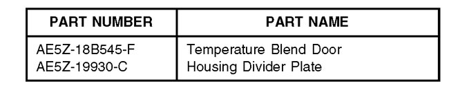

I dug through and found a technical service bulletin that seems somewhat similar. However, I don't know if you have dual climate control. If you do, take a look through this and let me know if the symptoms seem to mirror what you experience. Also, this includes diagnostics.

3.Reprogram the climate control module to the latest calibration using IDS release 62.09 and higher. This new calibration is not included in the VCM 2009.7 DVD. Calibration files may also be obtained at the website.
a. If the temperature on the passengers side remains in hot mode after DATC programming, proceed to Step 4.
b. If the temperature on the passengers side is corrected release the vehicle, do not continue with this procedure.
4.If vehicle was built on or before 4/6/2009 replace the right hand side temperature blend door and upper heater core and evaporator core housing divider, refer to WSM, Section 412-01 under removal and installation of evaporator core procedure. If built after 4/6/2009 proceed to Step 5.
5.If vehicle was built on or after 4/6/2009 to 6/1/2009 replace the right hand side temperature blend door only per WSM, Section 412-01, under Removal and Installation of Evaporator Core procedure.

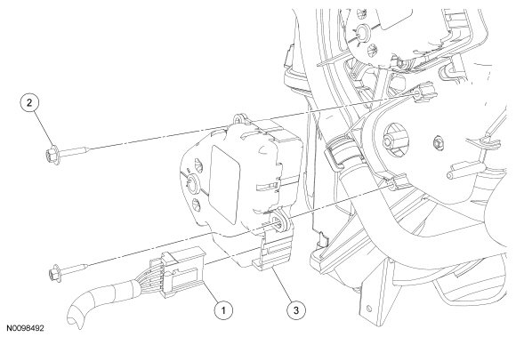

Then the one that is relevant is the left side. Here are directions for replacement. The attached pic correlates with he directions.
___________________________
2010 Ford Fusion FWD L4-2.5L
Temperature Blend Door Actuator - LH
Vehicle Heating and Air Conditioning Air Door Actuator / Motor Service and Repair Removal and Replacement Temperature Blend Door Actuator - LH
TEMPERATURE BLEND DOOR ACTUATOR - LH
412-01 Climate Control 2010 Fusion, Milan, MKZ, Fusion Hybrid, Milan Hybrid
REMOVAL AND INSTALLATION
Temperature Blend Door Actuator — LH
pic 1
Item Part Number Description
1 — LH temperature blend door actuator electrical connector (part of 19D887)
2 W712320 LH temperature blend door actuator screw (2 required)
3 19E616 LH temperature blend door actuator
NOTE: The LH temperature blend door actuator can be accessed from below the LH side of the instrument panel to the right of the accelerator pedal.
Disconnect the LH temperature blend door actuator.
Remove the 2 LH temperature blend door actuator screws.
Remove the LH temperature blend door actuator.
To install, reverse the removal procedure.
NOTE: The purpose of the module actuator position calibration is to allow the HVAC module to reinitialize and calibrate the actuator stop points. To carry out calibration, carry out the following steps.
Remove the Smart Junction Box (SJB) fuse 15 for at least one minute.
NOTE: When the ignition switch is switched to the ON position, the HVAC module will initialize and calibrate the actuators. Calibration of the actuators will take approximately 30 seconds.
Reinstall SJB fuse 15. Turn the ignition switch to the ON position and wait 30 seconds before verifying correct DEFROST/PANEL/FLOOR operation.
Let me know what you find.
