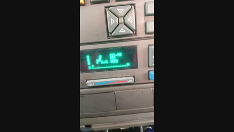

The AC/heat control unit keeps flashing when turned on sometimes it stops. Is it the head unit or the blend door actuator?
Jun 22, 2018 at 1:23 AM
  • 55,746 POSTS
It is flashing is trying to tell you a code can you count the flashes?

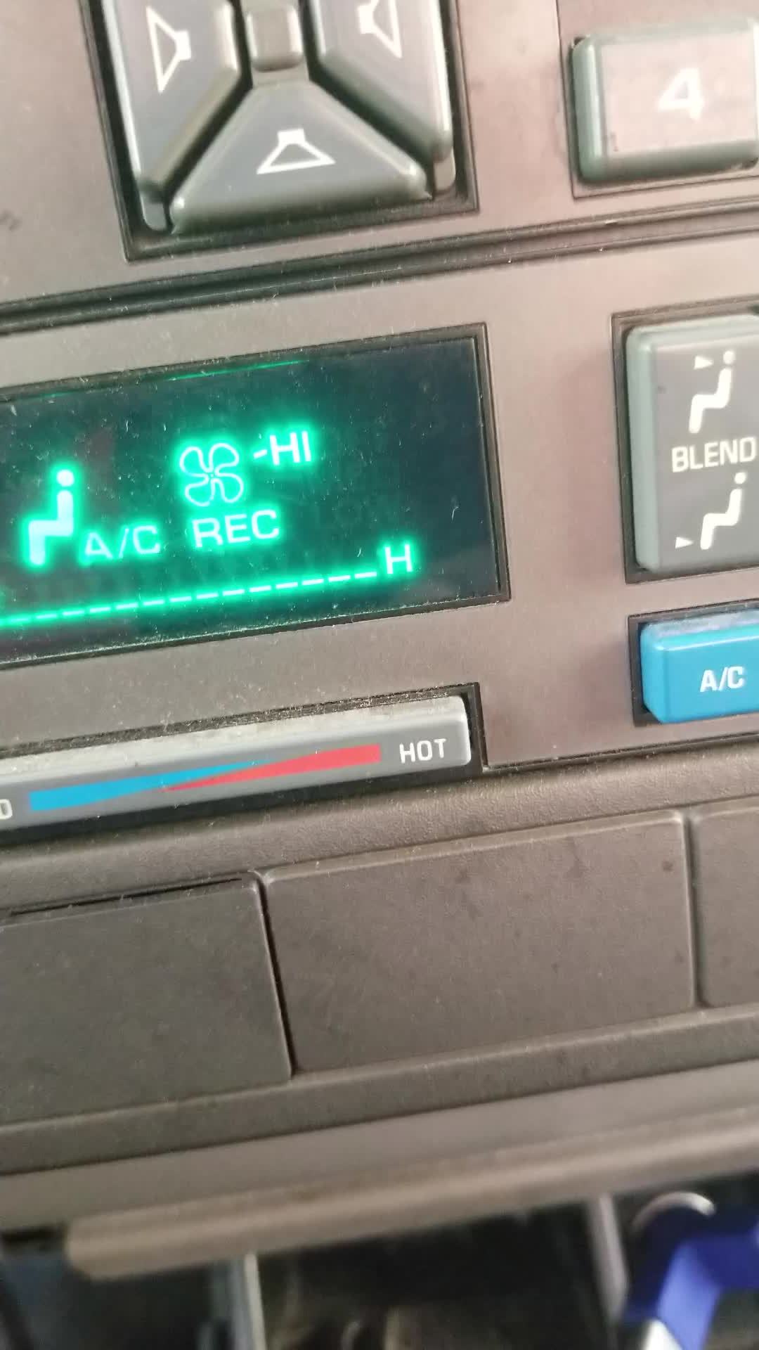

What does this mean?
Jun 24, 2018 at 8:23 AM
  • 55,746 POSTS

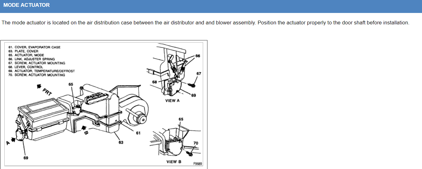

Thanks for the video! This usually means you have a mode actuator that is not working. Here is a guide to show you what you are in for when doing the job and the location of the actuator for your truck below:

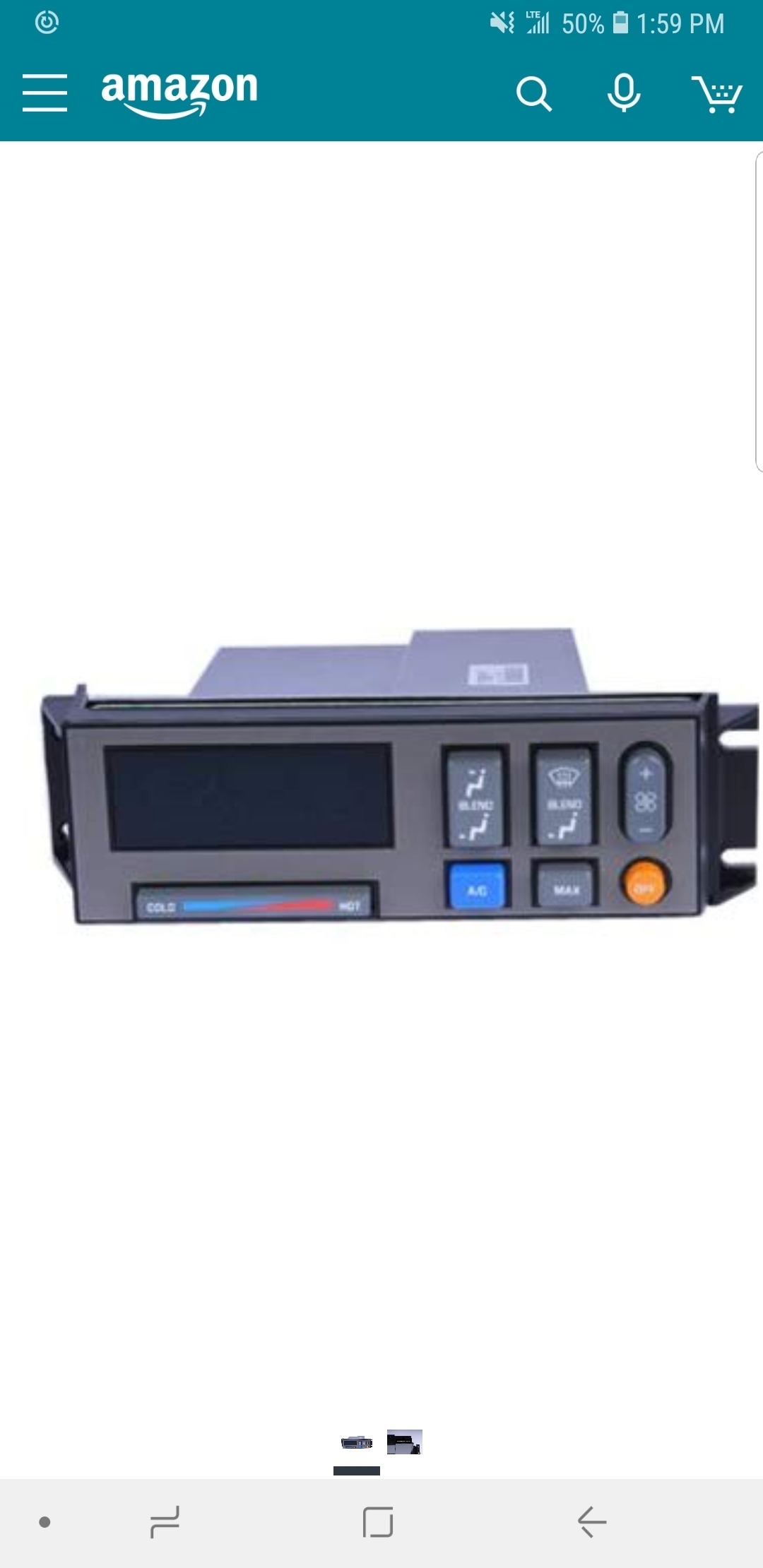

Is this considered manual or automatic controls?
Jul 1, 2018 at 3:05 PM
  • 55,746 POSTS
It says they are the same for either. Have you tried to replace the actuator?
Jul 2, 2018 at 4:55 AM
KEVNLKING
  • 26 POSTS
Not yet, they were asking me if my unit is manual or automatic which I think is manual.
Jul 2, 2018 at 5:02 AM
DANNY L
  • 5,648 POSTS
Hello, I am Danny.
Your application/unit is manual. Hope that helps.
