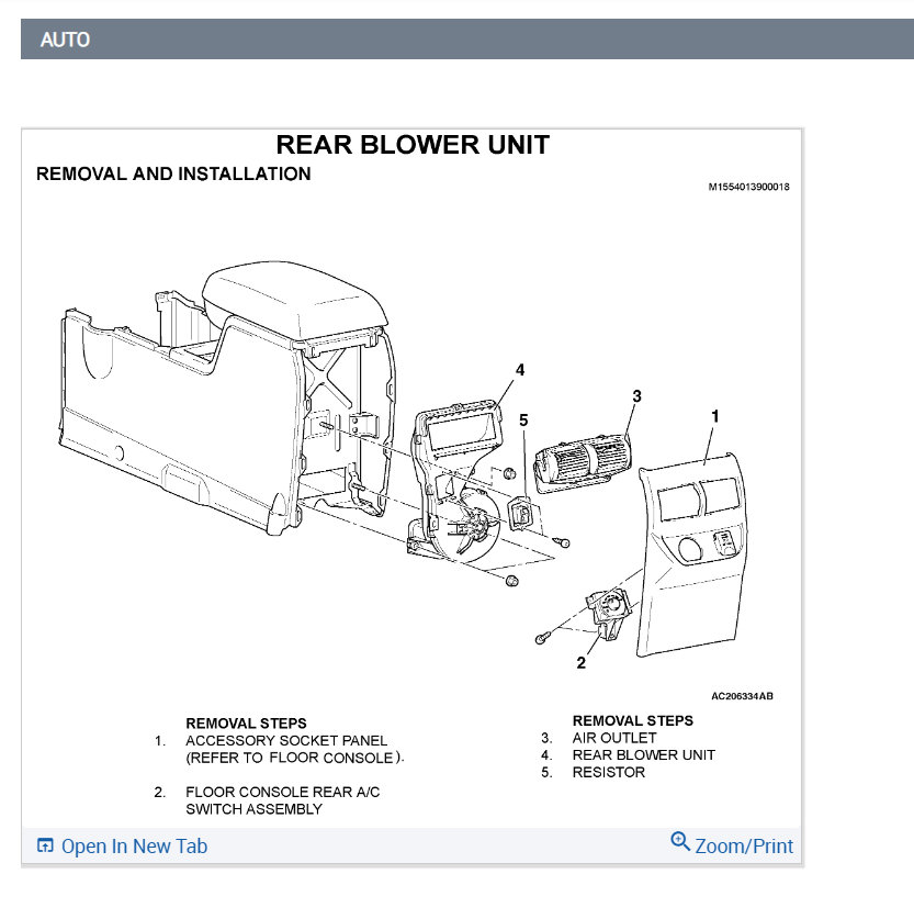

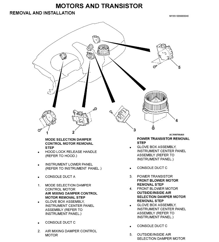

The AC /Heater and fan for them does not turn on?
Jul 9, 2022 at 8:52 AM
Experienced Mechanic
55,694 POSTS
This is common when the HVAC blower motor goes out. To be sure we can check for power at the motor using this guide. I have included the blower motor location and how to change it out in the diagrams below.
https://www.2carpros.com/articles/blower-fan-motor-works-on-high-speed-only
