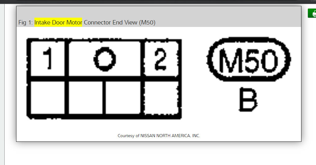

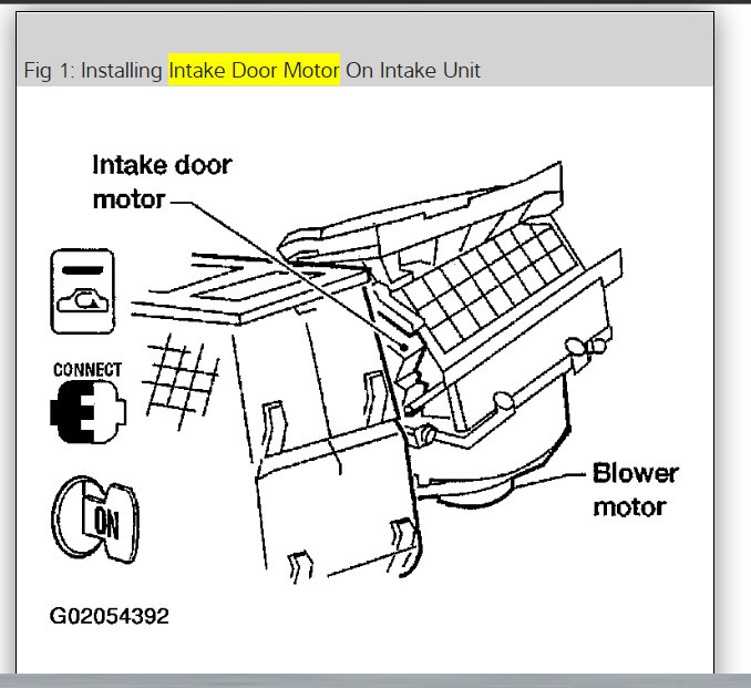

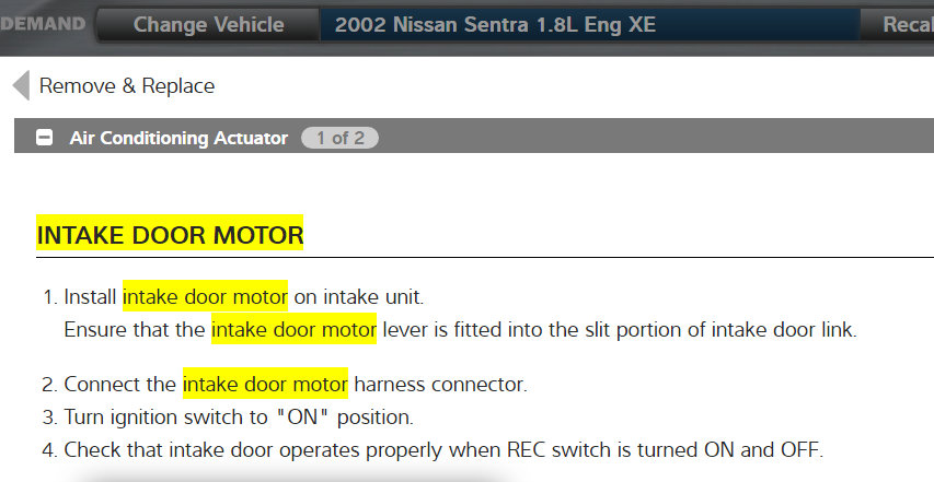

It stays on the defrost mode and only blows out hot. Thank you.
May 1, 2019 at 12:31 AM
SCGRANTURISMO
  • 4,897 POSTS
I have included the information that you requested in the diagrams down below. i have also included a link below for you to go to:
Please get back to us with how everything turns out. If you should have any other vehicle related questions, please, feel free to get back to us with it. It's what we do and why we are here.
