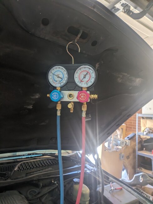

My truck was out of commission with a no crank no start. It took me a few weeks to fix it (thank you Joe). The problem was a broken ground wire to the starter relay. I have been driving it around and the air conditioning isn't working. So, I put my gages on, and I had 20 on the low side and 20 on the high side.
I looked for a leak using a spray bottle filled with dish soap and water used that to find any leaks, with the truck running and with it off and I didn't find any leaks. The low side was 20 and the high side was 20. I had a can of R-134a so I added some to the low side. That brought up the low side up to 30 and the low side didn't budge.
Last Summer I know that I put the proper amount of R-134a and oil in the system. And I confirmed I didn't have any leaks when I vacuumed the system before I added the R-134a. See the video.

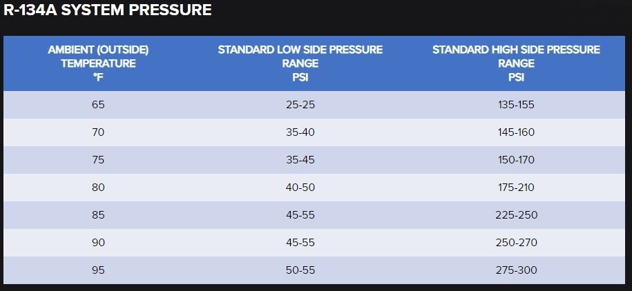

A very quick way to tell would be to jump power to the compressor and see if the high side goes up to normal. The image is a temperature and pressure chart to give you an idea of what you should see. If the high side goes up to say 130 but the low side drops below 20 it's a low charge, I would then recover the refrigerant and hunt for leaks under both vacuum and pressure. Then recharge with 1.8 pounds (28.8 ounces or 29 and the other .2 lost in the hoses) of 134A.
