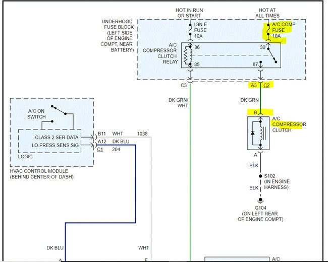

The A/C fuse in engine compartment keeps blowing. I’ve checked for broken wires and have found none. I can unplug the ac compressor and I check with a test light, and I do have power going to it. The truck has a new ECU. I thought compressor was shorting so I replaced two brand new Ac Delco compressor and it still blows. What else can I check? Is it possible the fuse block in engine compartment is bad? Because if it’s getting power there isn’t a short going to compressor?

Will the fuse blow if you have the compressor clutch disconnected?
I attached the wiring schematic for the compressor as a reference for you. Take a look at it I highlighted the clutch and fuse. Is that the fuse that is blowing? Is that the wire that has power that you checked?
Let me know

Yes, that’s the 10 amp fuse for compressor clutch.

Okay, have you inspected the connector at the compressor clutch? If the fuse doesn't blow disconnected, something is shorting when it's connected. I say that because you indicated replacing two compressors already. I wouldn't think you got two bad ones.

No problem. Let me know what you find. I'm interested in knowing. Also, when checking, make sure there is nothing coming in contact with the wire as well.

Hey Joe, it was a broken wire shorting out in fuse box in engine compartment I’m in process of fixing it. I’ll keep you guys posted.
