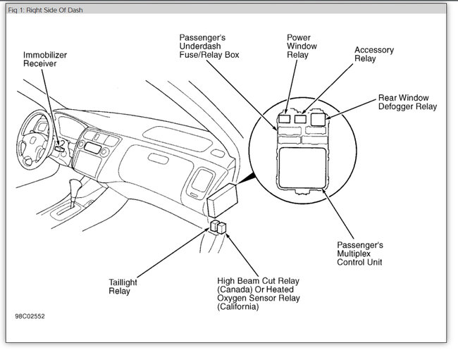

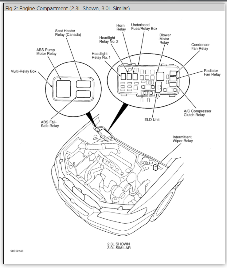

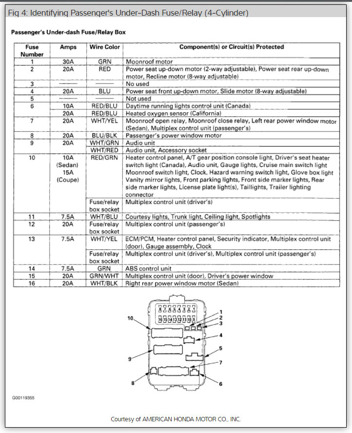

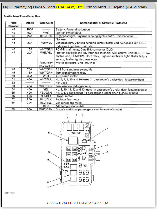

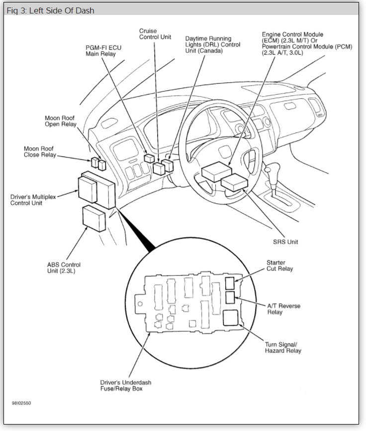

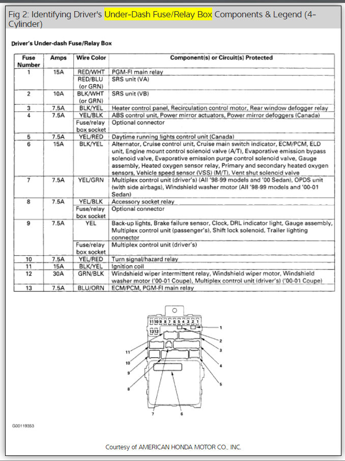

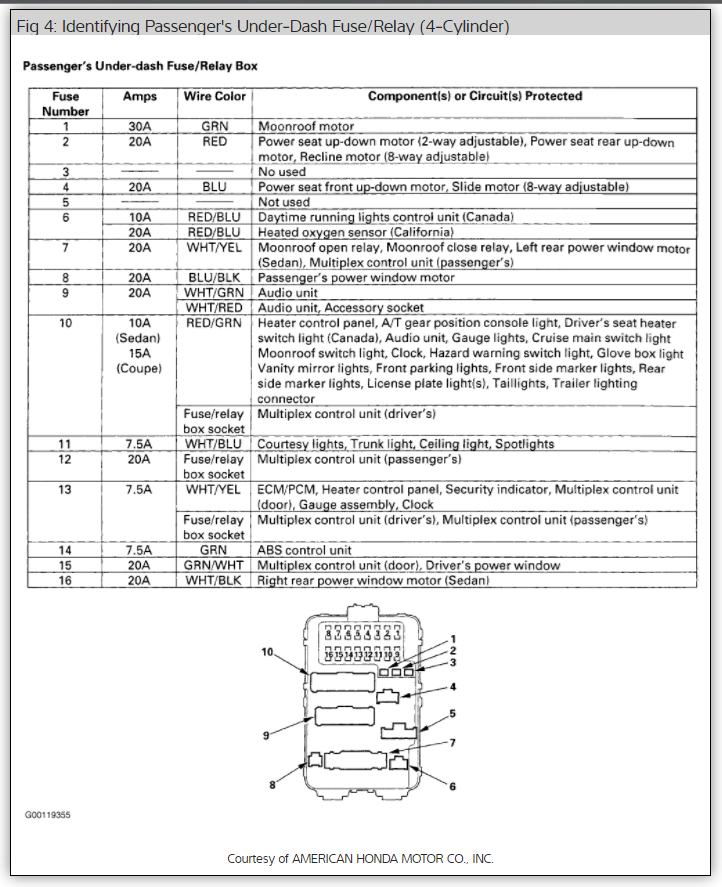

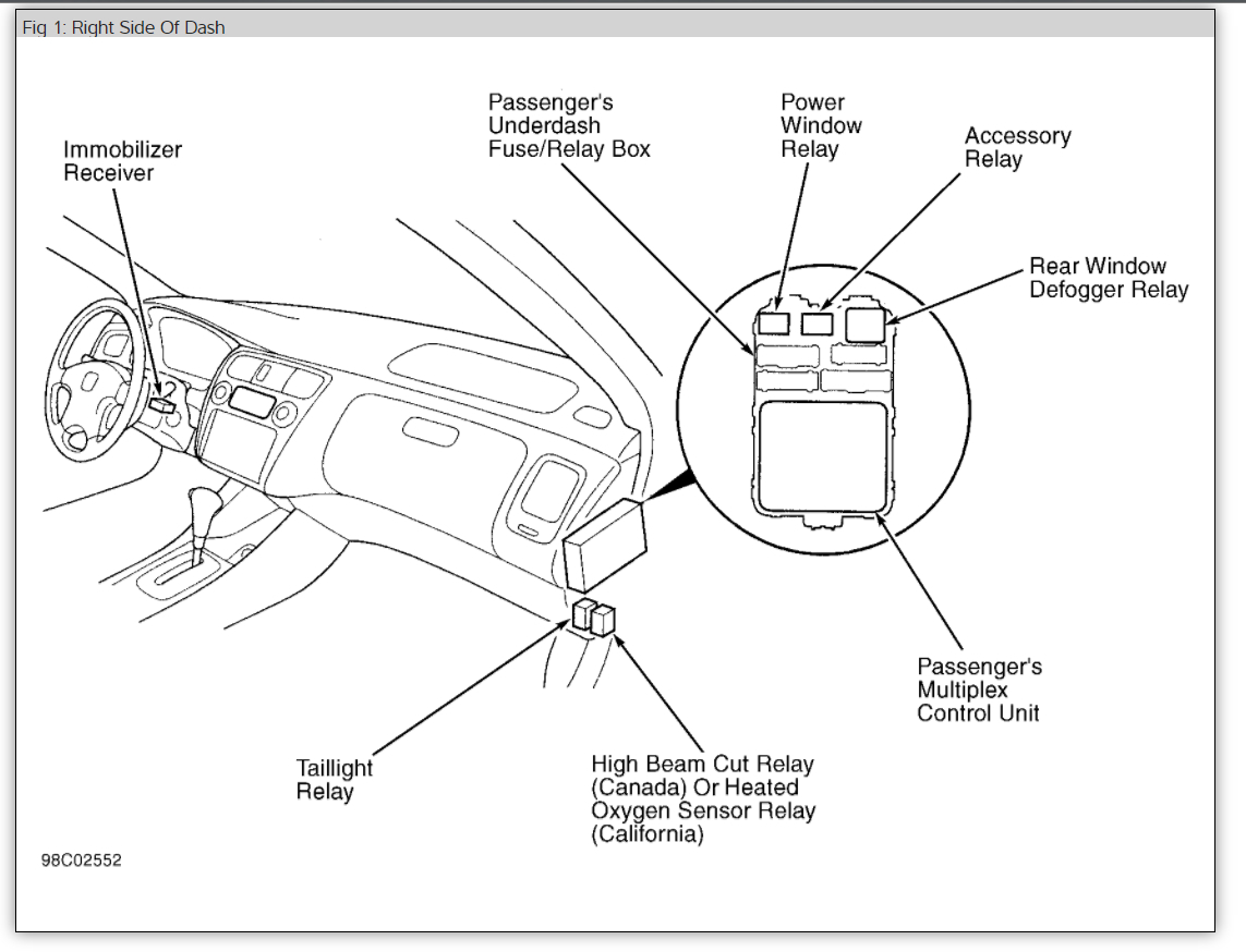

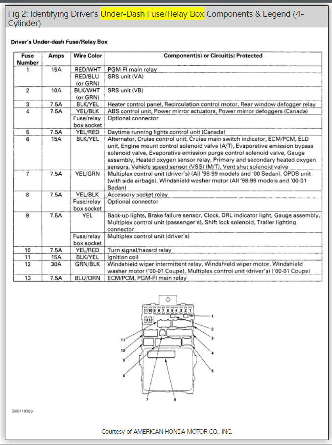

I am looking to replace the A/C fuse for my car. Also, the fuse for left driver side window. Where is it located and what numbers are they? I am a female who knows nothing about cars but I think this would fix my A/C problem. It is hot here in Florida.
Aug 15, 2017 at 3:31 AM
  • 55,381 POSTS
Here are the locations for all of the cars fuses and relays with a guide to show you how to check them.
