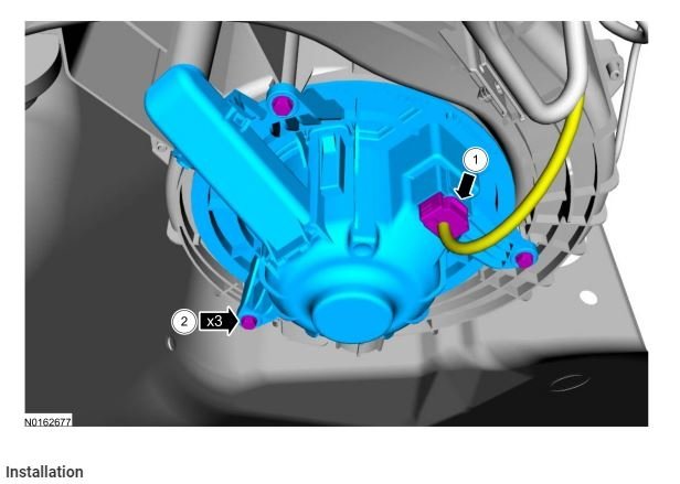

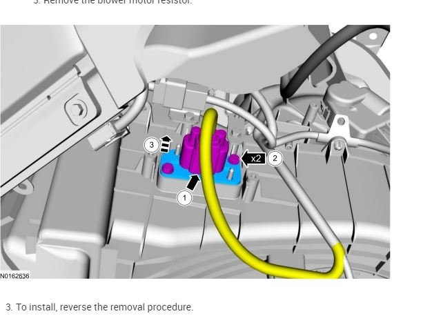

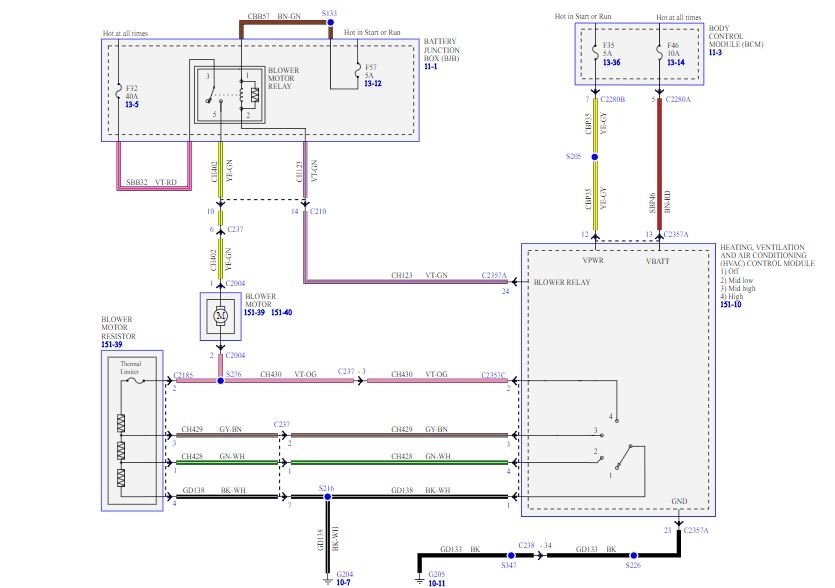

My AC unit is not blowing out the front. However, the back is working fine.
May 5, 2018 at 11:44 AM
good afternoon.
It sounds like the blower motor is not working. You need to check for power to the blower motor itself. Use a test light or volt meter.
Procedure for resistor
Removal and Installation
Remove the passenger side lower instrument panel insulator.
Disconnect the ambient lighting electrical connector (if equipped).
Remove the passenger side lower instrument panel insulator pin-type retainers and remove the insulator.
Remove the blower motor resistor.
Disconnect the blower motor resistor electrical connector.
Remove the blower motor resistor screws.
Blower motor location
Removal
Remove the passenger side lower A-pillar junction box cover.
Remove the blower motor.
Disconnect the blower motor electrical connector.
Remove the blower motor screws and remove the blower motor.
I also attached a wiring diagram for you. check the fuses listed for the relay for power on both sides

It could be the connector on the motor or the resistor. Try wiggling them and see if the motor comes on.

Okay, it kicked on again without moving the wires but the wires coming from the blower got hot after about five minutes. But when I turned the AC off the wires cooled back down. I surely do not need a fire.
May 5, 2018 at 3:45 PM
It sounds like the blower motor is drawing way too much current. I would replace the blower based on that alone.

Any shop or DIY it. That blower motor is easy to change out. The insulator panel is held in with push clips. Disconnect the light sensor, remove the panel. Look up at the bottom of the HVAC housing and you are staring at the blower motor. Depending on which motor you actually have it will either have three screws or a twist in/out retainer. Disconnect the electrical connector, remove the screws or release the lock and twist the motor counterclockwise and it will fall out in your hands. I would get the replacement part BUT do not unbox it until you get the old one out. High currant draw can be from a bad motor but it can also be from debris getting into the blower housing.
However being this is a 2016 and 80,000 miles you might want to see if it is a covered item.
