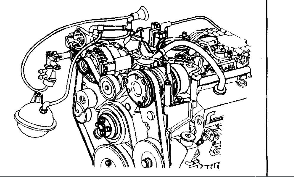

The A/C system in this van gets really weak or diminishes whenever I approach uphills or freeway up slants. It either slows down blowing cold air until the road gets to even parallel.
Saturday, June 2nd, 2018 AT 3:01 AM
  • 52,797 POSTS
Good morning.

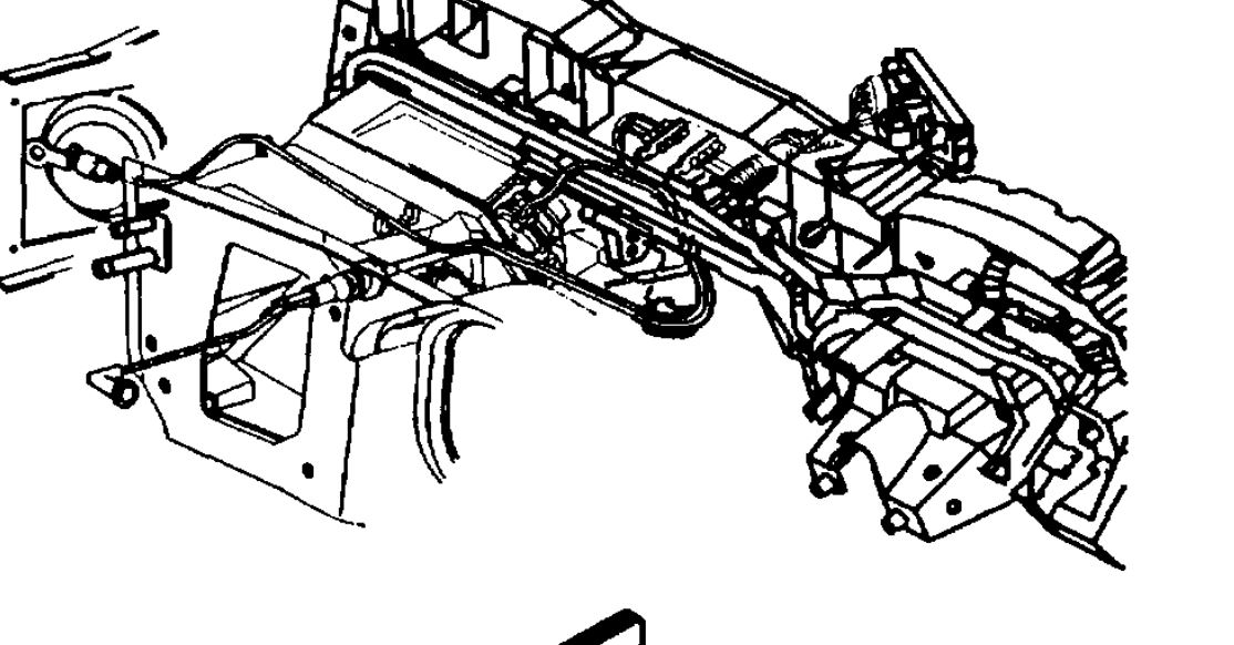

This system work on vacuum to keep the blend doors in one position when commanded. Under a load, there is a tank or check valve that should keep the doors in the correct position until you let up on the accelerator. You either have a vacuum leak from a hose or the check valve or tank is leaking.
Check the vacuum lines carefully for any breaks or leaks. If none are found the tank needs to be replaced.
