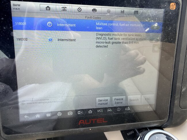

I scanned it nothing under the hvac only thing under engine module are:
190302
118001
Takes about 6-7 seconds to start. Fan not on when first started and ac is off.
Soon as i turn ac on even on lowest sittings the fan goes on high. The after 10 seconds it goes down to normal spedi
After the engine started i rescanned the dme and found
140002
140010
140302
140310
140402
140410
I increased ac fan blower speed 2 notches and heard the fan a bit faster.
If i increase it more and it toes on faster.
Lower it down and it goes down quieter
