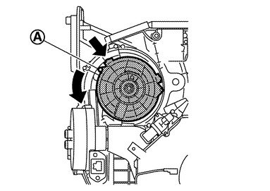

How do I take out the fan blower motor? It's on the driver's side. I can't find any videos, manuals, and every shop I call says no material is available for only my year car.

Here are the directions specific to your vehicle. There are several things that need removed, so if you need help with any of them, let me know. Pic 1 correlates with the directions.
2016 Nissan-Datsun Versa Sedan L4-1.6L (HR16DE)
Blower Motor - Removal and Installation
Vehicle Heating and Air Conditioning Blower Motor Service and Repair Removal and Replacement Blower Motor - Removal and Installation
BLOWER MOTOR - REMOVAL AND INSTALLATION
REMOVAL
Disconnect the negative battery terminal. Refer to Removal and Installation.
Remove the lower knee protector (LH). Refer to Exploded View.
Remove the accelerator pedal assembly. Refer to Removal and Installation.
Remove the brake pedal assembly. Refer to Removal and Installation.
Disconnect the harness connectors from the blower motor.
Disconnect the harness connector from the thermo control amp.
Remove the blower motor screw (A).
Picture 1
Press the flange holding hook and turn blower motor counterclockwise.
Remove the blower motor.
INSTALLATION
Installation is in the reverse order of removal.
Let me know if this helps or if you need anything else.
