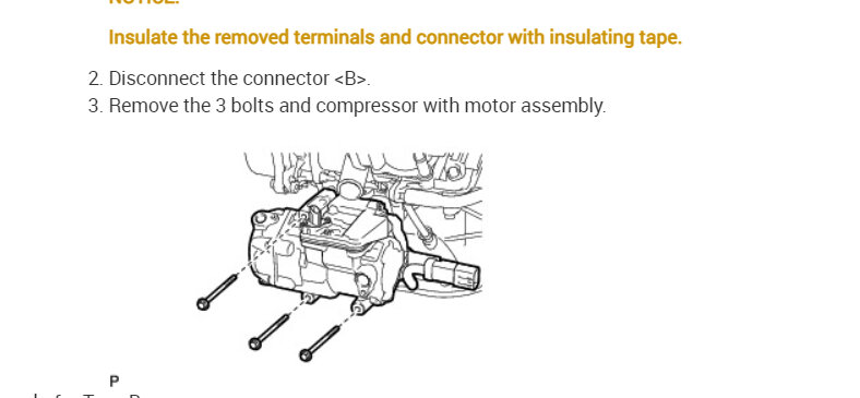

Serpentine belt missing?
Feb 7, 2023 at 12:12 AM
Experienced Mechanic
55,721 POSTS
There is no A/C compressor belt on this engine, please check the image below to confirm, also upload an image of what you see as well. Check out the images (below). Please let us know what happens.
