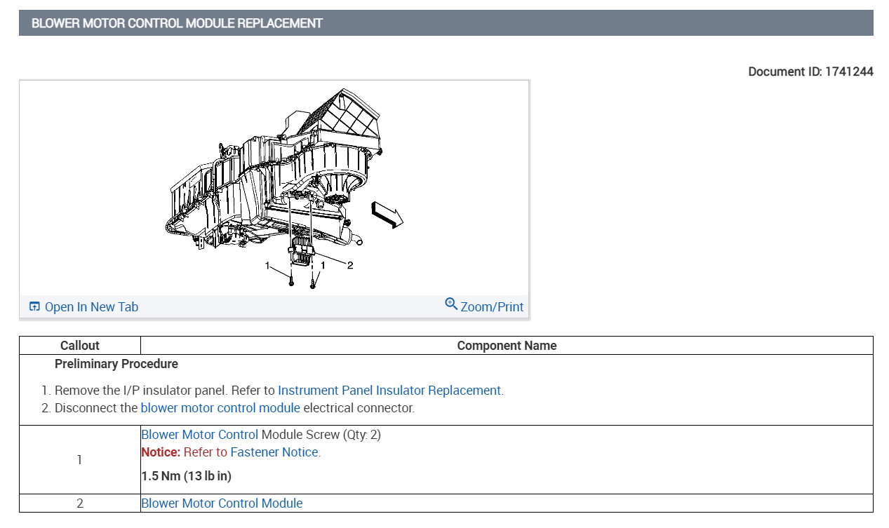

Blower motor fan will not shut off?
2007 CHEVROLET SILVERADO
118,000 MILES
CARL TROEHLER

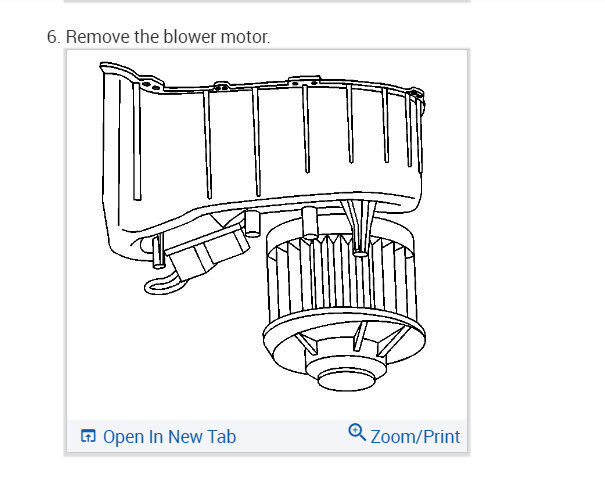

Blower motor fan not shutting off.
Oct 16, 2022 at 3:20 AM
  • 55,423 POSTS

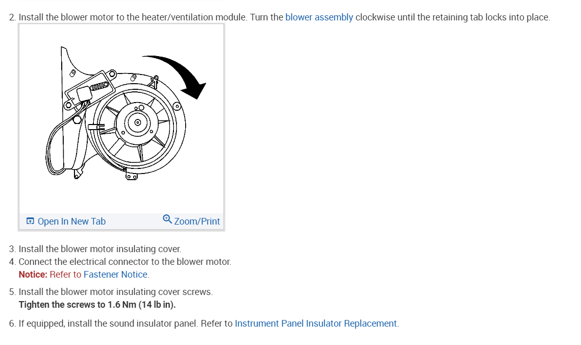

This is common when the blower motor speed controller goes out, this can be because the blower motor is pulling too many amps which can cause the controller to go out so I would replace them both. here is the location so you can do the repair. Check out the images (below). Please let us know if you need anything else to get the problem fixed.
Oct 16, 2022 at 6:45 AM
CARL TROEHLER
Thanks a ton, I'm pleasantly surprised to have such a prompt, professional response. I've replaced the blower motor, which was fried, the fuse under the hood, which was blown, and the control module, but I got one online so it might not have been good. I'll be getting one from a local parts store and I'll let you know how that goes. Thanks again, Carl.
