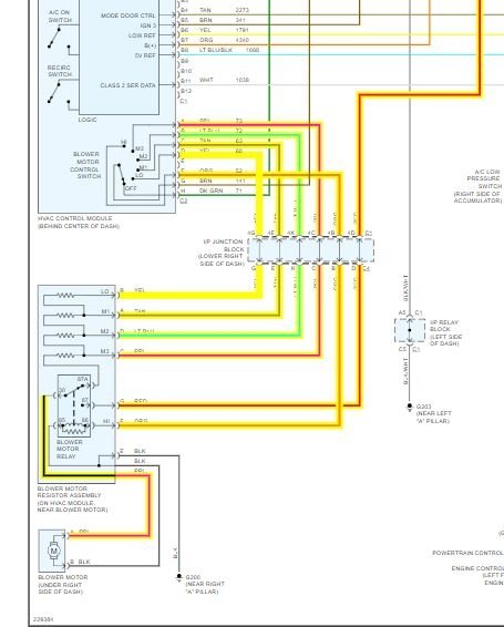

I attached a diagram for you to view.
The blower switch provides power to the blower resistor in 1-4. 5 is a direct bypass from the blower switch to the resistor and to the blower motor.

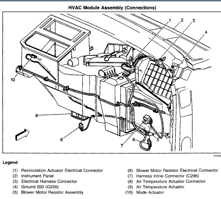

Sounds like the Blower Motor Resistor. It is located in the duct work under the passenger dash. Looks like this...
https://images.2carpros.com/forum/automotive_pictures/188069_05silverodo_1.jpg
Apr 30, 2021 at 8:23 AM (Merged)

Quick question first. Was the interior submerged with water? If not a common problem with these trucks are the blower motor resistor. It's mounted on the HVAC box next to the blower motor. I've attached a picture below of its location (#5). They have had a problem melting/poor connection/loose wires. Hope this helps and thanks for using 2CarPros.

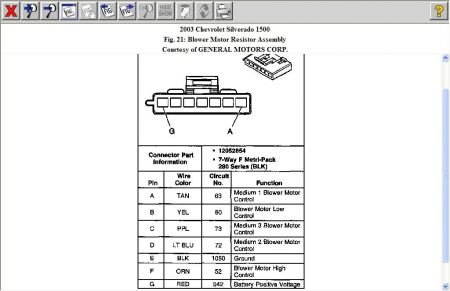

You can use a testlite on the wires for the blower speeds. In the diagram you have one wiring color for each speed, take the connector loose from resistor assembly. key on, havc turned on, switch through the speeds, while you use a testlite at the proper wiring color at connector. If everything is hot, probably ok up to that point.
https://images.2carpros.com/forum/automotive_pictures/170934_silverado_blower_resistor_1.jpg
The resistor assembly is under passenger side of dash, number 5 in the picture.

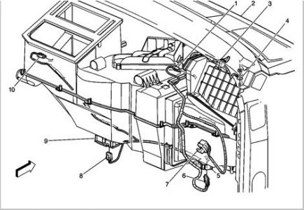

Hello, It is most likely your Blower Motor Resistor it is located near the blower motor under right side of dash and it looks like this.....
https://images.2carpros.com/forum/automotive_pictures/188069_05silverodo_2.jpg

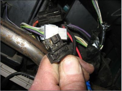

Hello and thanks for the donation! There is a common issue with this year's HVAC fan only working on the Low & Medium speeds. There should be a 2 or 3 wire cannon plug in-line between the blower relay and the 50-Amp fused circuit from the underhood fuse / relay box. This plug and another share a niche rolled up in adhesive foam in the vicinity (top of airbox, right of the relay) . This plug commonly burns up and fails. (SNAPSHOT OF FAILED PLUG)
https://images.2carpros.com/forum/automotive_pictures/261618_Noname_726.jpg
