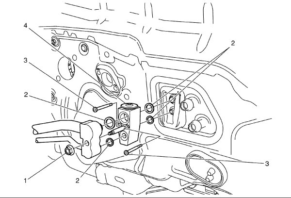

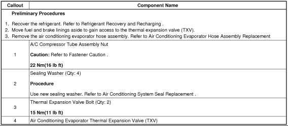

Where is the AC expansion valve located?

I posted two diagrams from "Alldata" (click on them below).

The expansion valve is under the hood mounted on the firewall, right next to the heater core hoses. I have attached a picture for your review.
