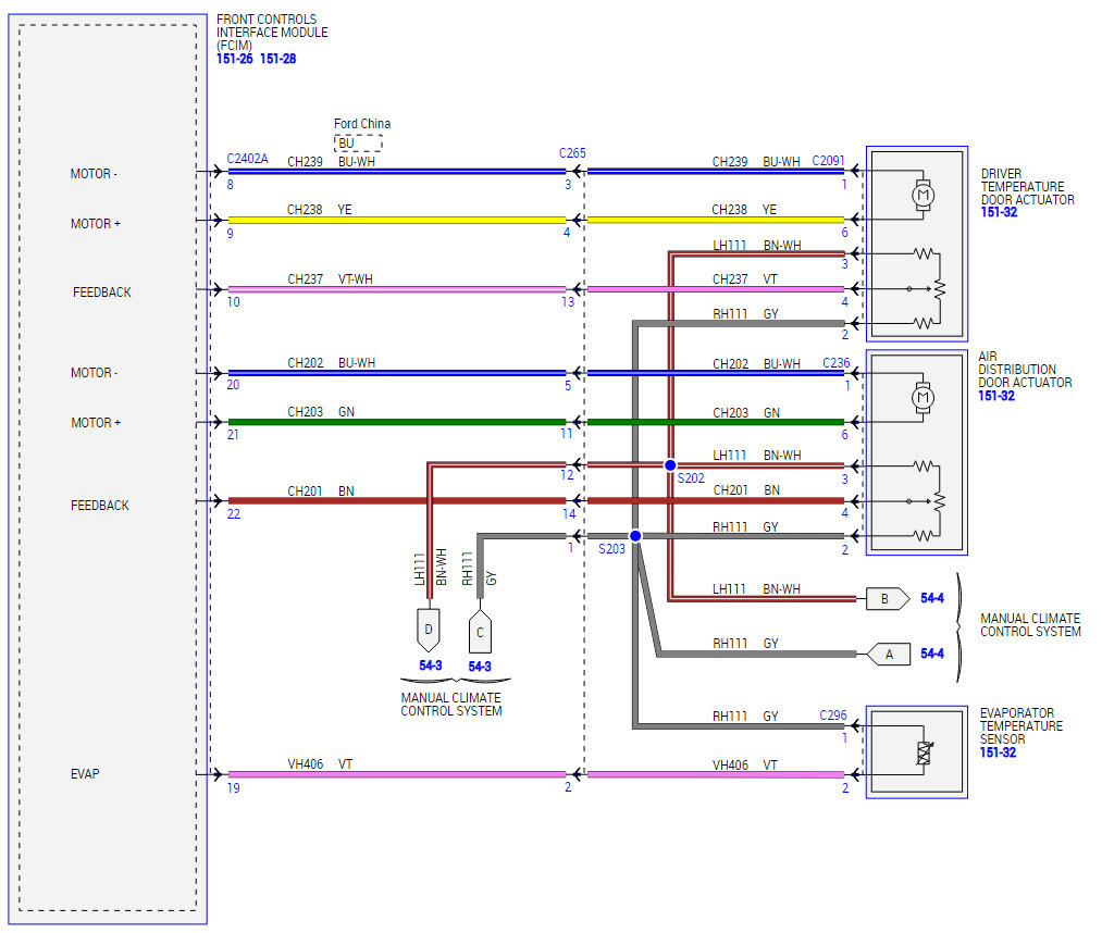

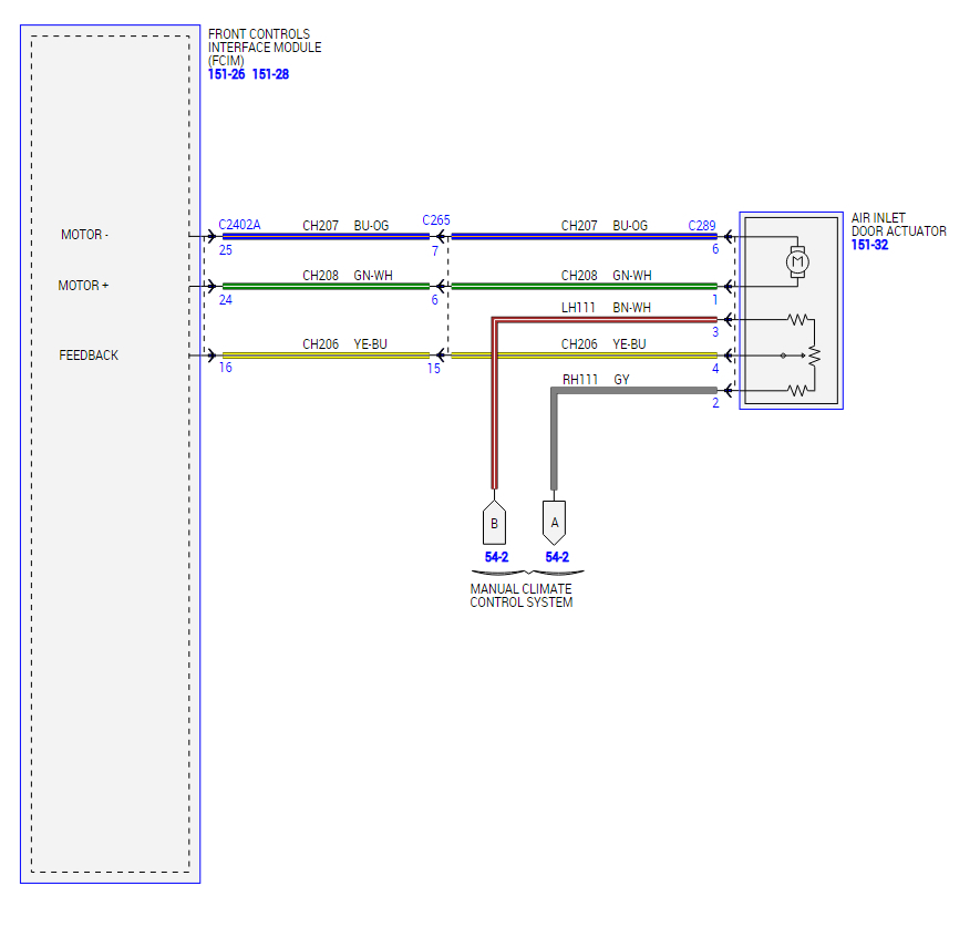

What color are the wires that I need to bypass the evaporator temperature sensor until I get the actual sensor replaced?

Just want wiring diagram for HVAC in cabin to bypass evaporator temperature sensor.

They've replaced everything except the evaporator temperature sensor and will not do that because of labor involved on these models.

Got it. Do you have automatic or manual HVAC system on that fusion?
Let me know and I will get you the appropriate wiring.

It's the single zone manual HVAC in 2020 Ford Fusion S.

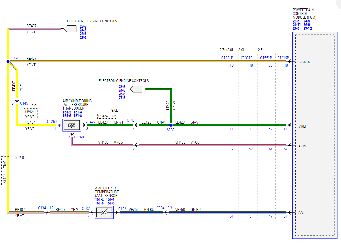

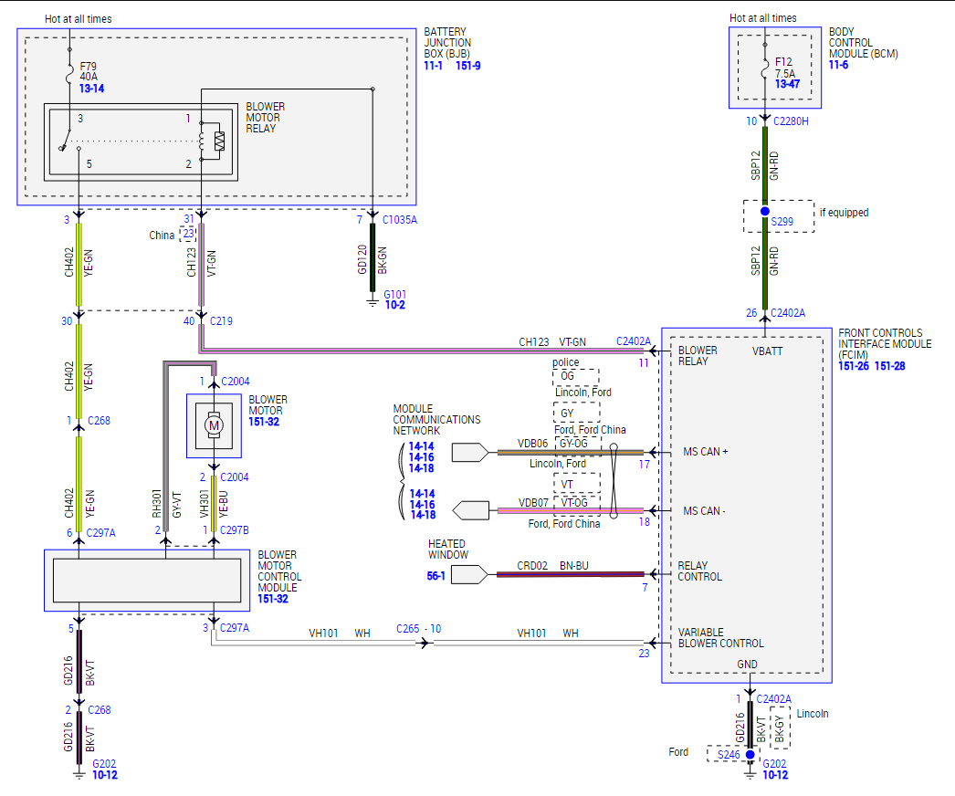

I have attached the complete wiring schematics for the HVAC system.
Look below.
