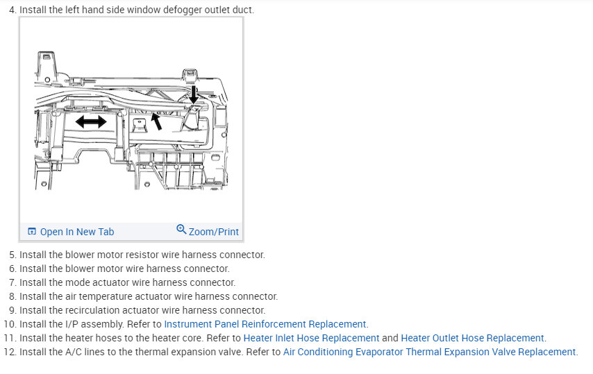

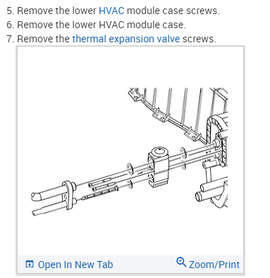

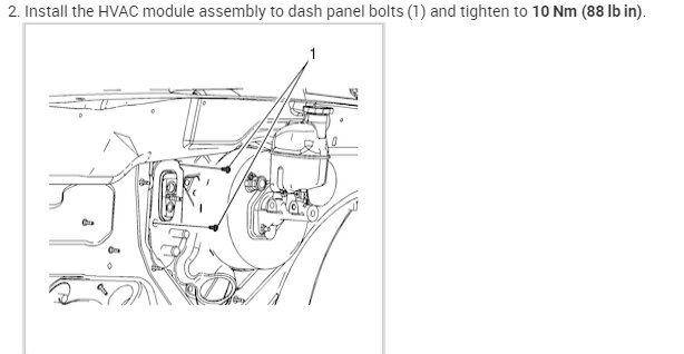

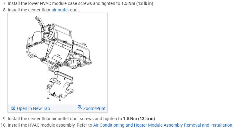

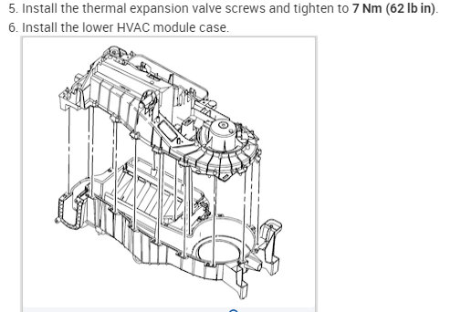

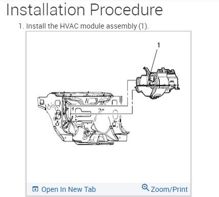

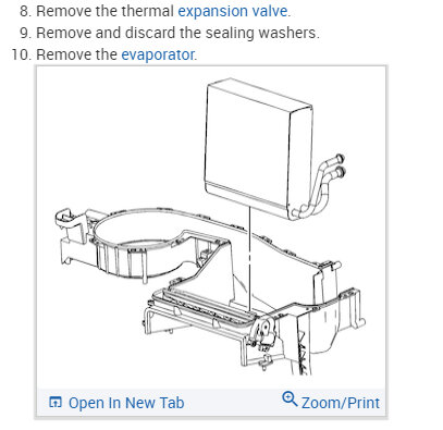

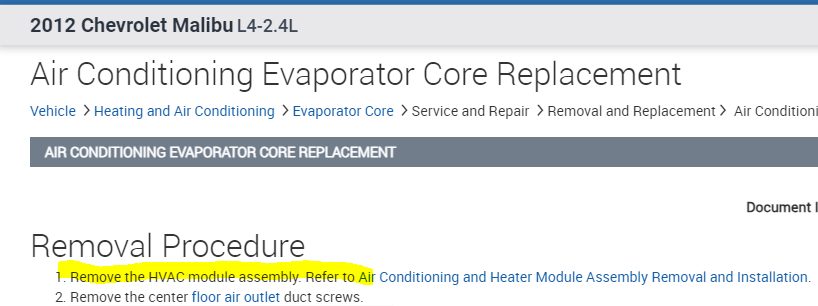

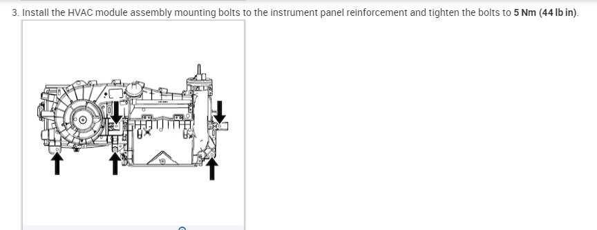

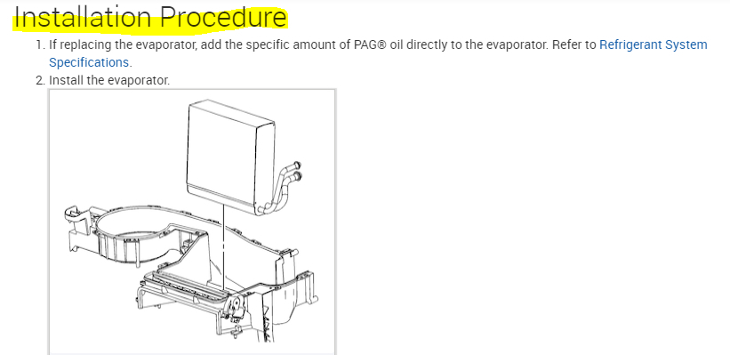

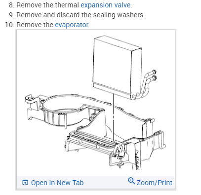

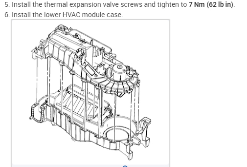

I need instructions on removing evaporator core, with pictures, do you guys have these?
Sep 9, 2023 at 1:29 PM
  • 110,244 POSTS

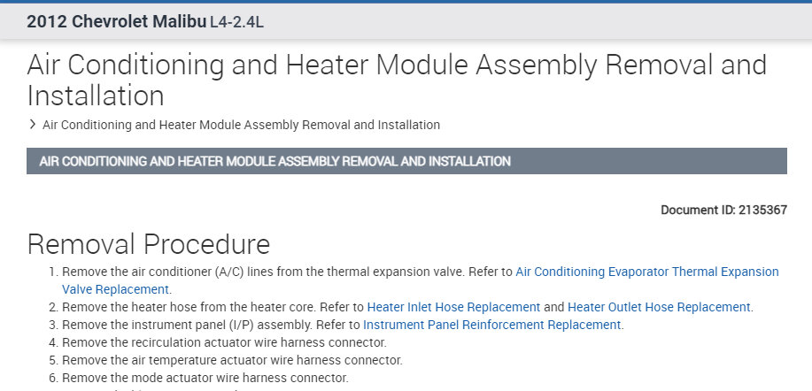

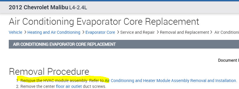

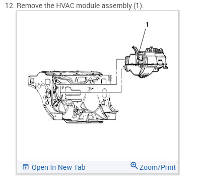

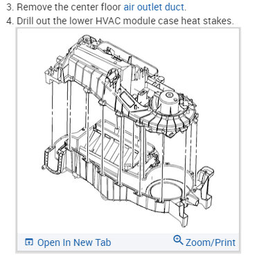

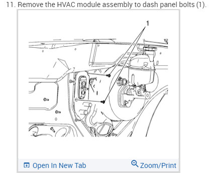

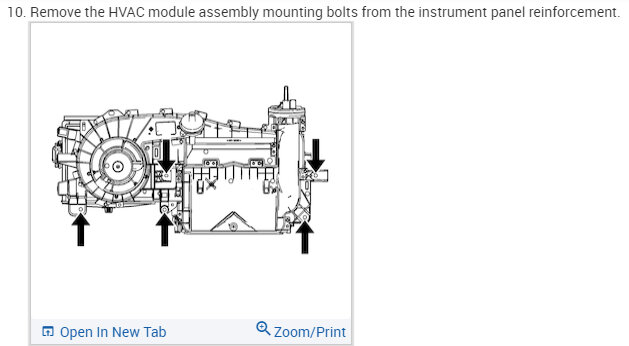

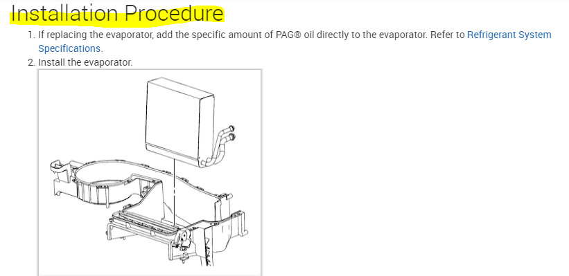

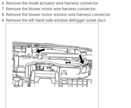

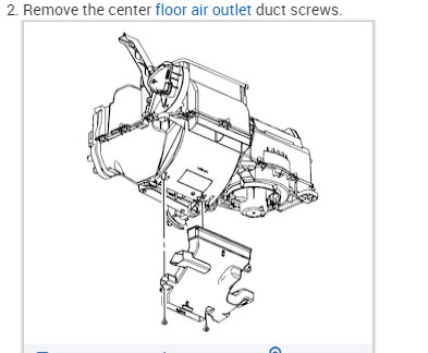

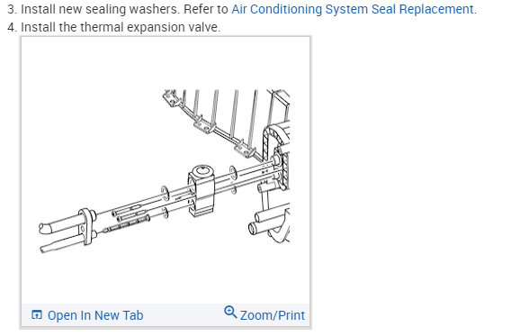

The first thing in the directions is to remove the HVAC module assembly. If you look below, I attached the directions for removing the module assembly first. After that, the directions for replacing the evaporator core.
Take a look through the directions and let me know if that is what you need or if you have questions.
