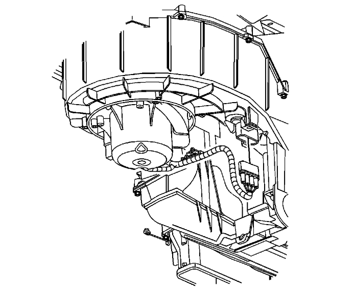

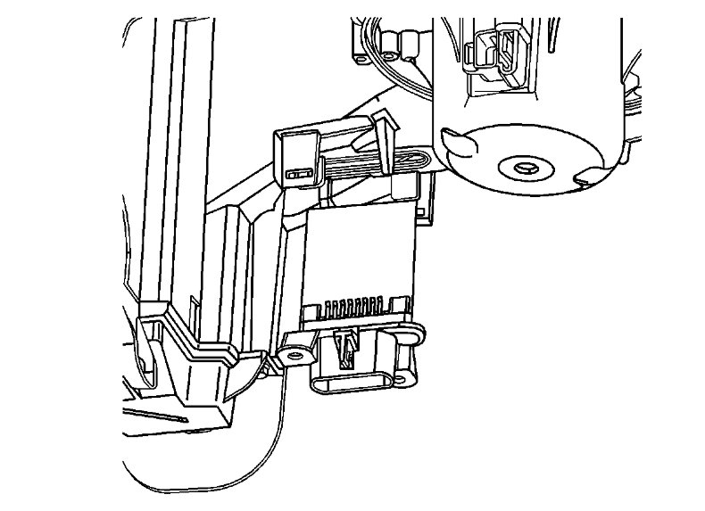

Resistor
REMOVAL PROCEDURE
1. Disconnect the blower motor resistor electrical connector.
2. Unsnap the blower motor resistor from the HVAC module and remove.
