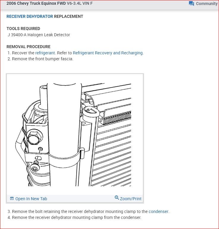

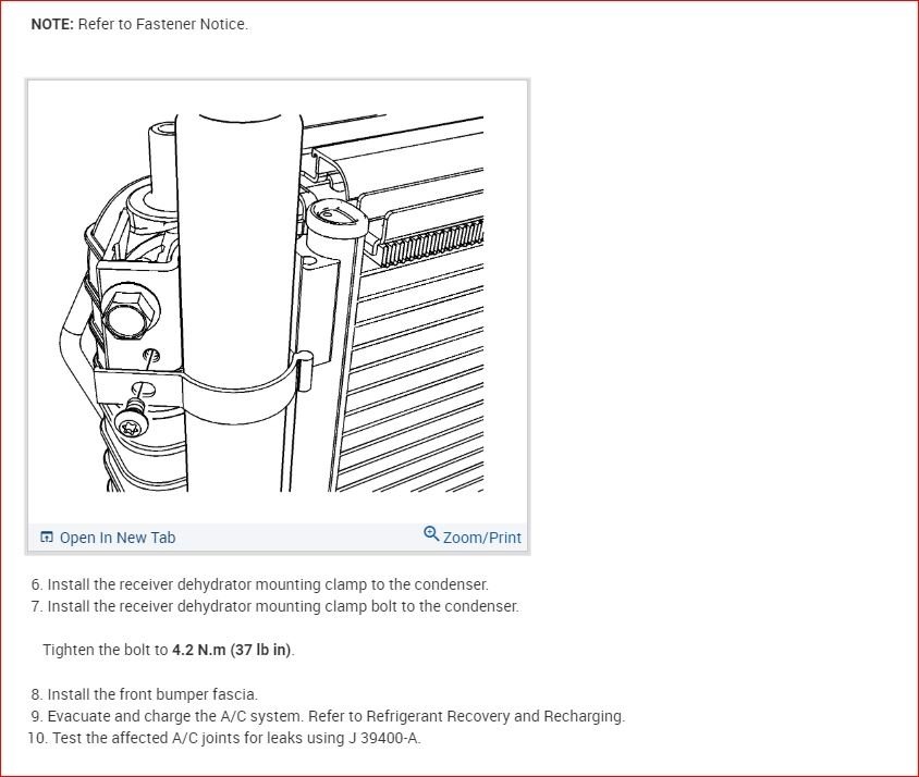

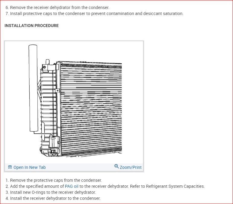

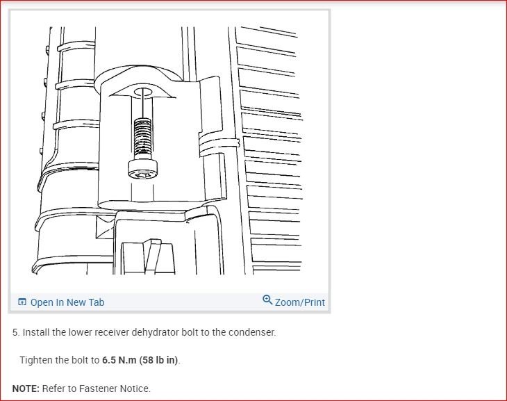

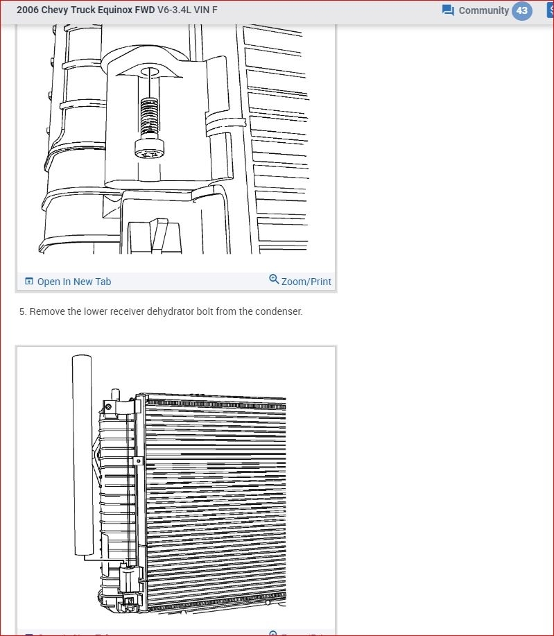

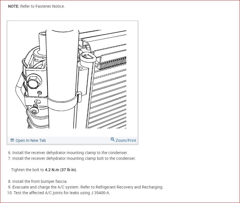

How do you replace the AC dryer?
Wednesday, June 5th, 2019 AT 4:50 PM
Hi Kevin,
Here is the procedure for replace the dryer. Keep in mind you will need to evacuate the system before and after and pull it into a vacuum after you are finished. You need to make sure you do this after because you have to get the moisture out of the system or it will damage the compressor.
Let me know if you have more questions and I will be happy to assist. thanks
