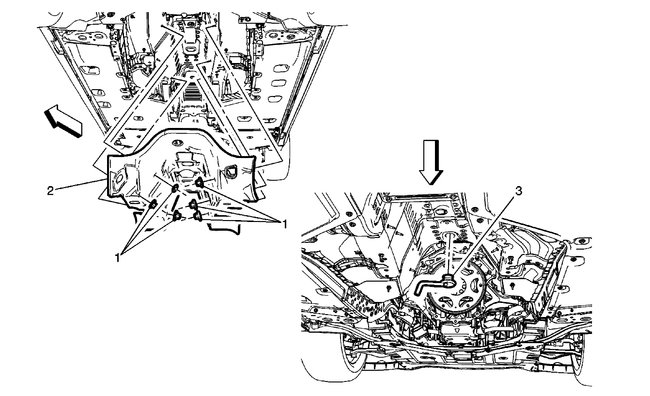

I’m trying to locate a diagram or blueprint for where the A/C drain is located for my car listed above luxury sedan? A/C is leaking onto floorboard and stinks.
Aug 18, 2022 at 2:32 AM
  • 55,743 POSTS

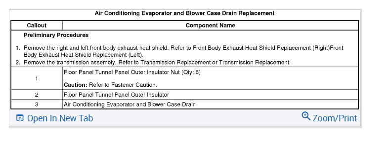

Here is a video that shows how to find and clear out the drain tube. I have included in the images below the location for the A/C drain tube for your car which is directly about the transmission, it does have a hose attached to help guide the water to the side. You will need to raise the car to get at it, this guide can help as well:
