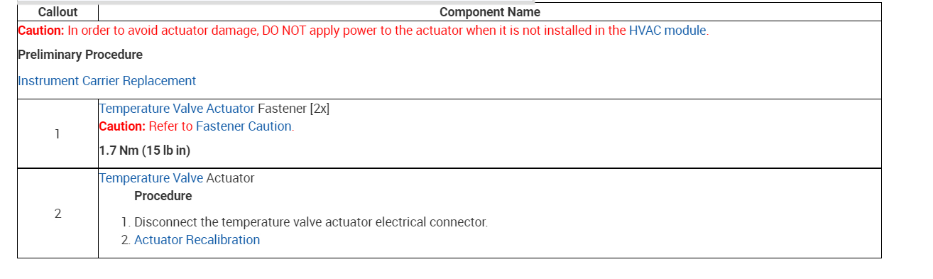

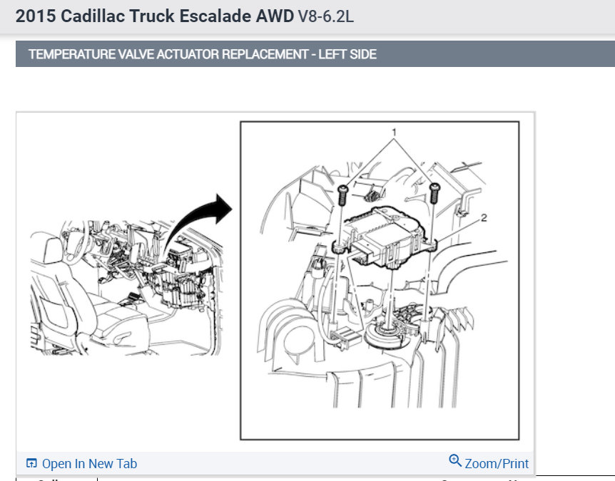

I need to change it. Do I have to remove the dash to change it? or it can be changed from a pathway other than removing the whole dashboard?
Aug 23, 2022 at 6:20 PM
  • 55,732 POSTS
It is the one that is on top of the HVAC unit, but I have seen people get at the actuator through the glove box for some of the screws, and one screw by the accelerator pedal. Here is a guide to help you see what you are in for and the instructions to replace the left side actuator in the images below.
