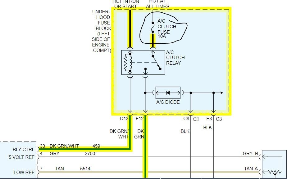

It just blows hot air, it does not work at anytime. I checked the relay the fuse the fan seems to be working. I also used Freon and pressure is where it's supposed to be. what could it be?
Jul 12, 2019 at 7:55 AM
Good evening,
What are the high and low side pressures?
Does the compressor engage when you turn on the AC?

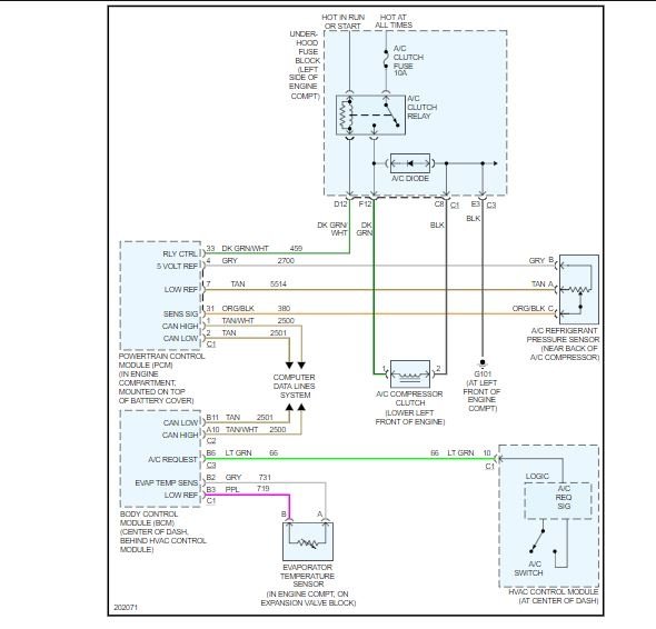

I attached a wiring diagram for you to view. Check the fuse I listed and circled for power on both sides of the fuse.
Remove the relay and test the 4 terminals. 2 terminals should have power with the key on.
