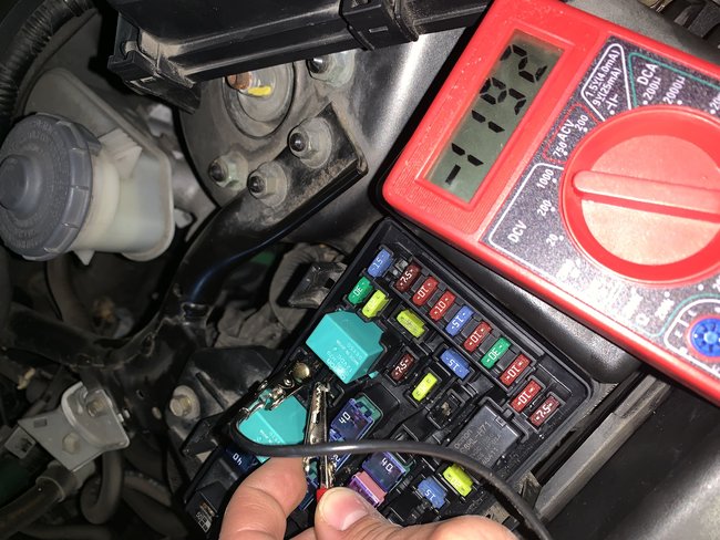

Hello, I'm sorry to bother you.
I have a problem with the A/C.
I start to test if the power goes into the compressor and there is no power. I went up to relays and change all of them. It does not help. I checked the power on each relay and there is.
Right now I'm thinking about A/C button on the dashboard, that it could be the problem. Am I on the right track? Or you would recommend me to check something else?

NICK ONYSHCHUK
Sorry, it took awhile to test everything.
I started from AC clutch. There is a good ground but no power. I plugged the compressor directly from battery and it worked.
Then I moved to relays. I test all of them, bought a set of new relays and replace them. No effect.
I test voltage and resistance in each relay port and only one has weird numbers (ac clutch one) see attached picture.
Then I took the relay and connect AC clutch circuit and AC started.
My thoughts that the problem with ground. What do you think?
Last thing I wanted to check is the ground wire from ECM but cannot find arrangement of wires so I can find the right one. I would be sad if the problem in ECM.

NICK ONYSHCHUK
Sorry, I said “ground wire from ECM” but I really mean power wire which goes to ACC so I can ground it and see if AC will start. I think in this case I will confirm that computer does not send the ground on AC relays.

Welcome back:
If you take power direct to ground, it will pop a fuse or cause damage. Is that what You mean?
