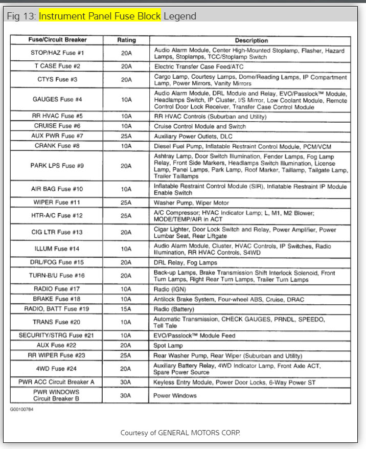

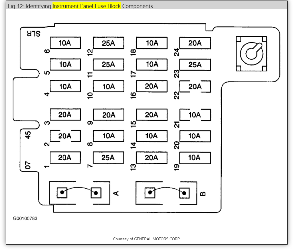

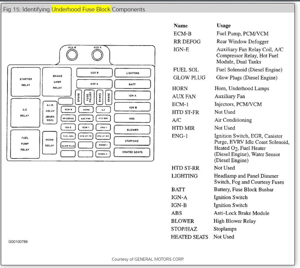

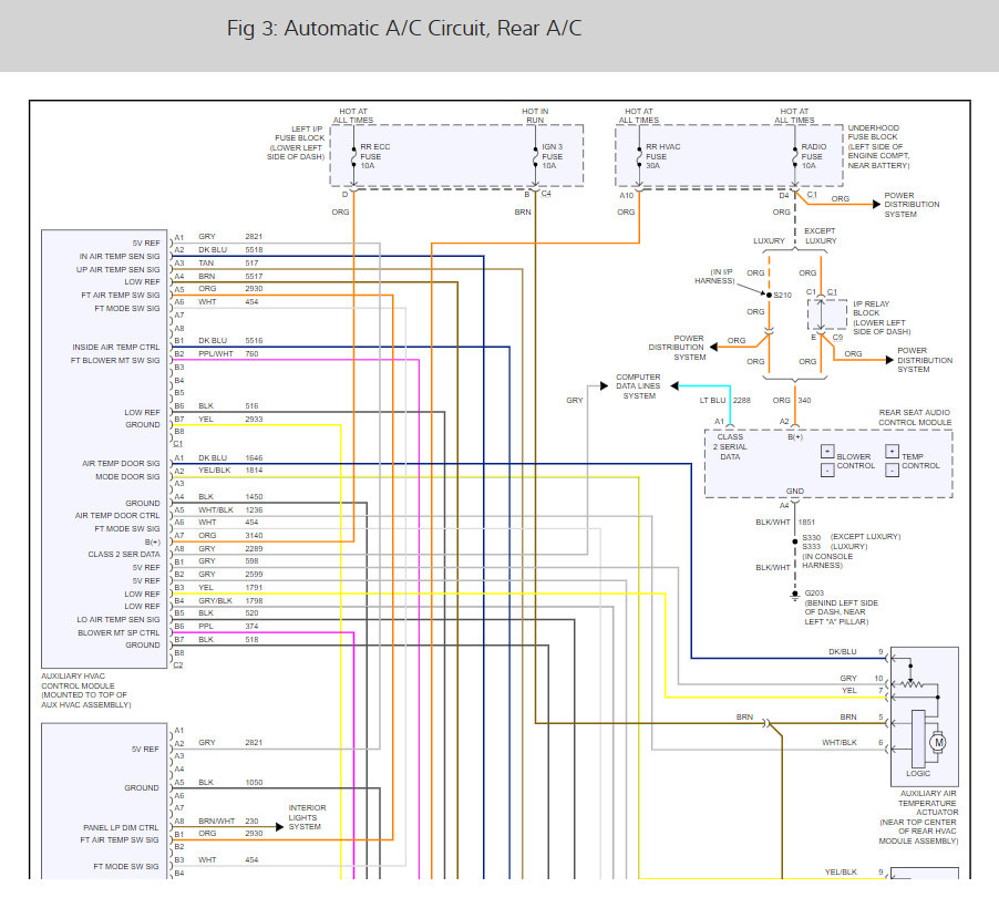

Replaced blower motor and control module. Also replaced the 10 amp fuse under the hood.
Jul 21, 2019 at 4:15 AM
  • 55,628 POSTS

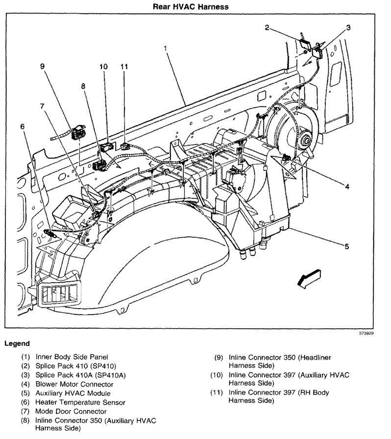

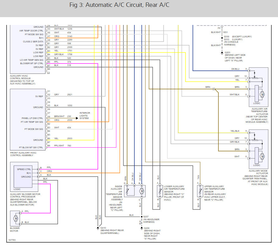

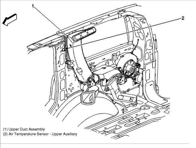

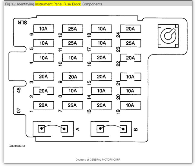

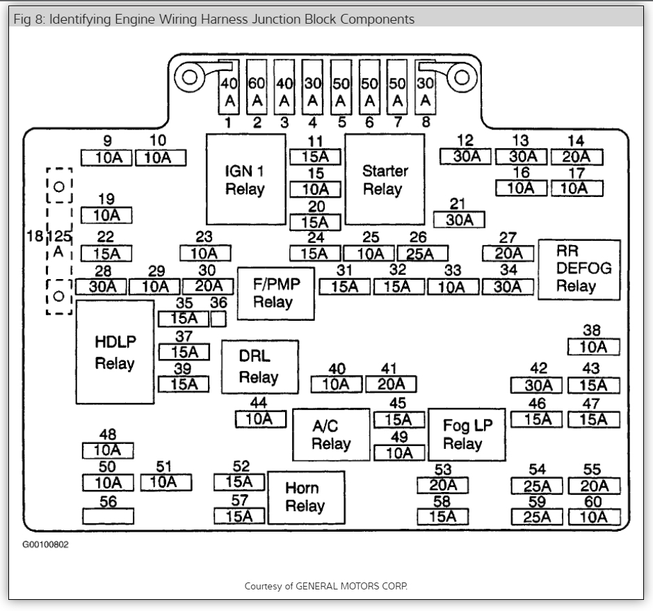

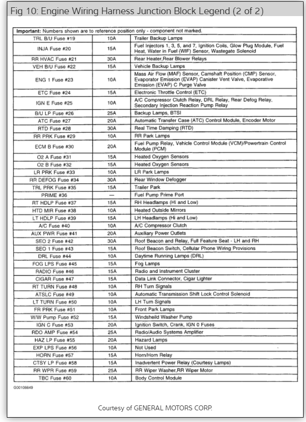

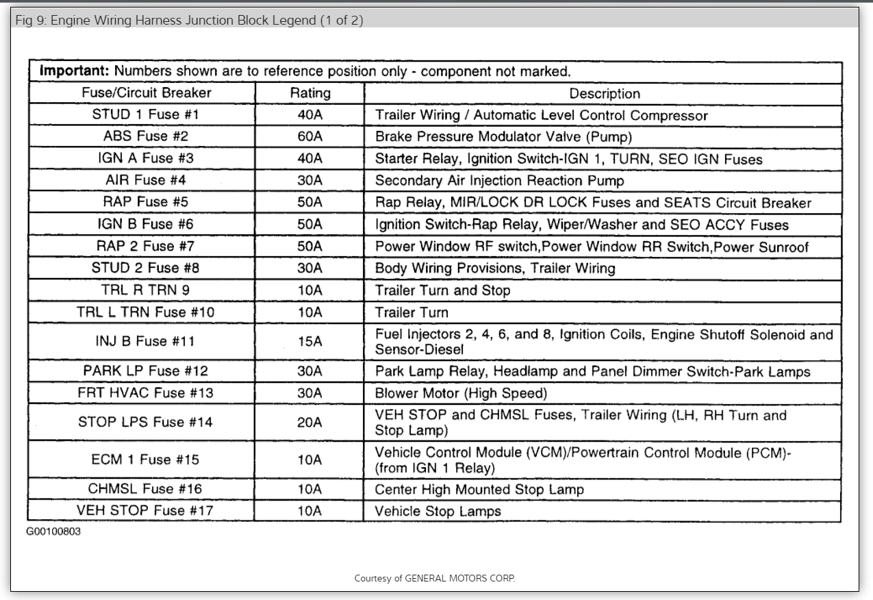

Does the fuse have power this guide will help and there are two other fuses that must be checked as well. Here are the blower motor wiring diagrams so you can see how the system works and which fuses to check also with a guide to help you check for power along with the fuse locations below.
Check out the diagrams (Below). Please let us know what you find. We are interested to see what it is.
Jul 22, 2019 at 8:28 AM
HOT IN PA
Fixed. It was the 40 amp fuse. Must have blown when the AC went out. Thank you.

This sounds like the blower motor has failed but to be sure we can check for power and ground back at the blower motor here is a guide and some diagrams below so you can get the problem fixed.
