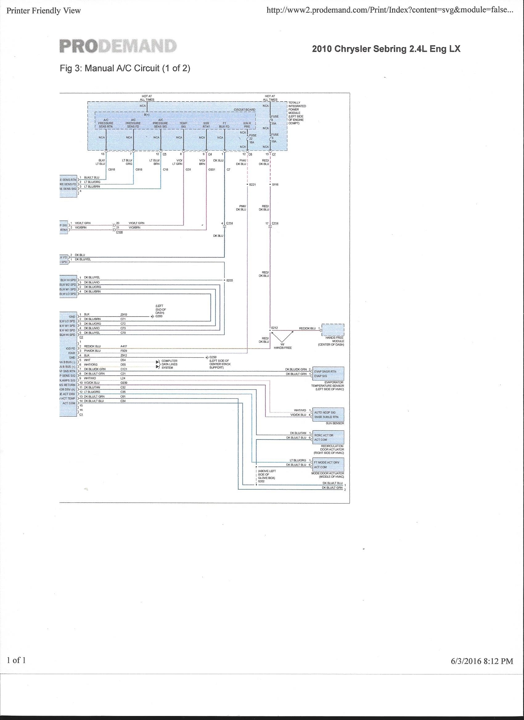

Air conditioner was only working on high and then stopped completely. Attempted repair by replacing blower motor resistor and blower motor. Not sure what else to check. Air conditioning lines under the hood are cold. I can hear a slight drag on the engine when attempting to run the air conditioner, but still nothing seems to engage and blow air.
Jun 3, 2016 at 9:02 AM
WRENCHTECH
  • 20,760 POSTS
the first thing to do is test for power and ground at the motor and that will tell you which direction to go from there. http://i1198.photobucket.com/albums/aa448/Wrenchtech/210618557.jpg https://www.2carpros.com/images/external/210618558.jpg
Jun 3, 2016 at 10:05 AM
WRENCHTECH
  • 20,760 POSTS
Here is another diagram.
