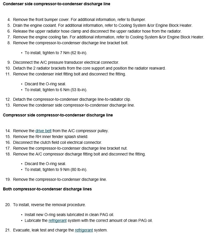

Having serious trouble trying to get the bolts off the lower part of the AC discharge hose on the high-end. Any help would be appreciated. Thanks.

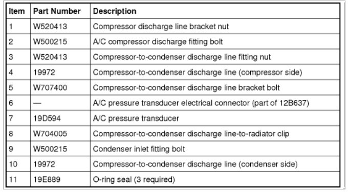

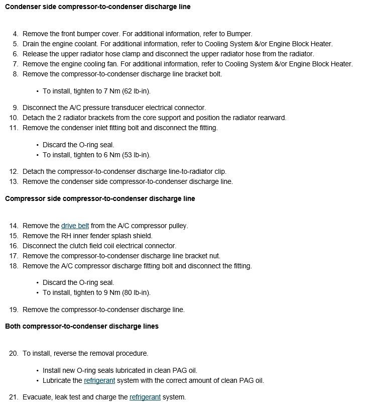

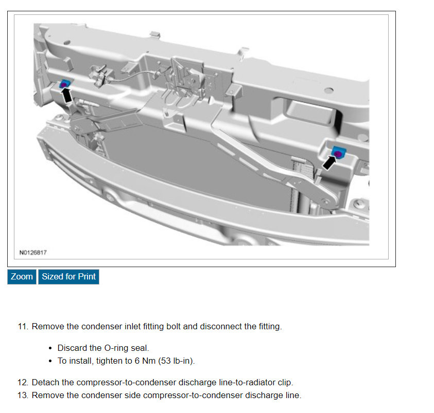

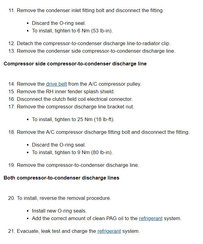

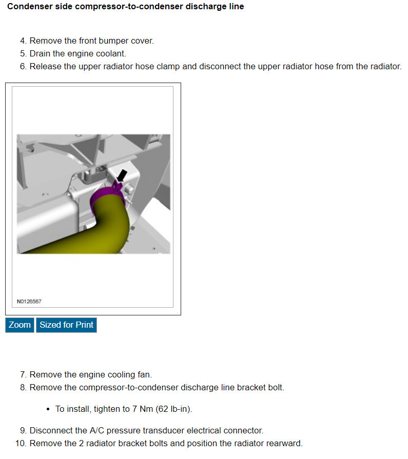

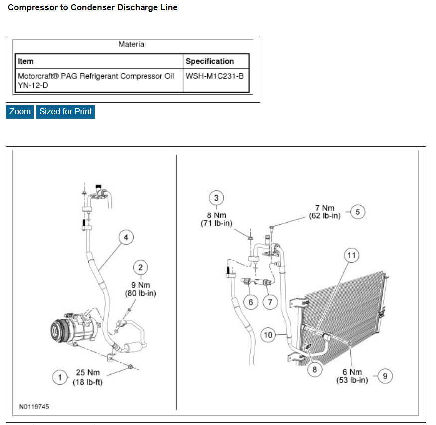

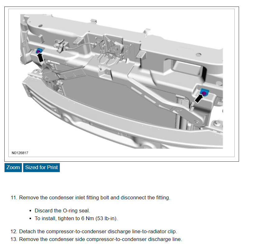

This may help.
May 28, 2018 at 1:08 AM
SCOTT ROBERTSON
This seems like it is not for my Lincoln MKX. I do not think I would have to take all that stuff off just to replace the discharge hose.

Please give us a picture or video of the problem upload them in your reply. Here is a guide to help you vacuum down and recharge the system along with diagrams and instructions to replace the AC system hoses:
Let me know if this is the hose you are talking about.
