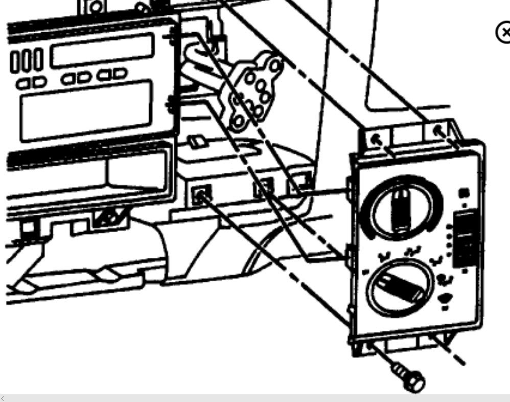

I need to remove the dash AC control unit. The fan control disk (knob) does not work properly and has to come out. How do I proceed without doing any damage to the dash? Does it snap in or are there some screws holding it in the dash?

check bezel for screws and remove them. then take bezel out, it will pry out then undo screws holding control in and disconnect electrical and replace switch. make sure to re-plug vacuum and electrical connections in. We have no pictures.
