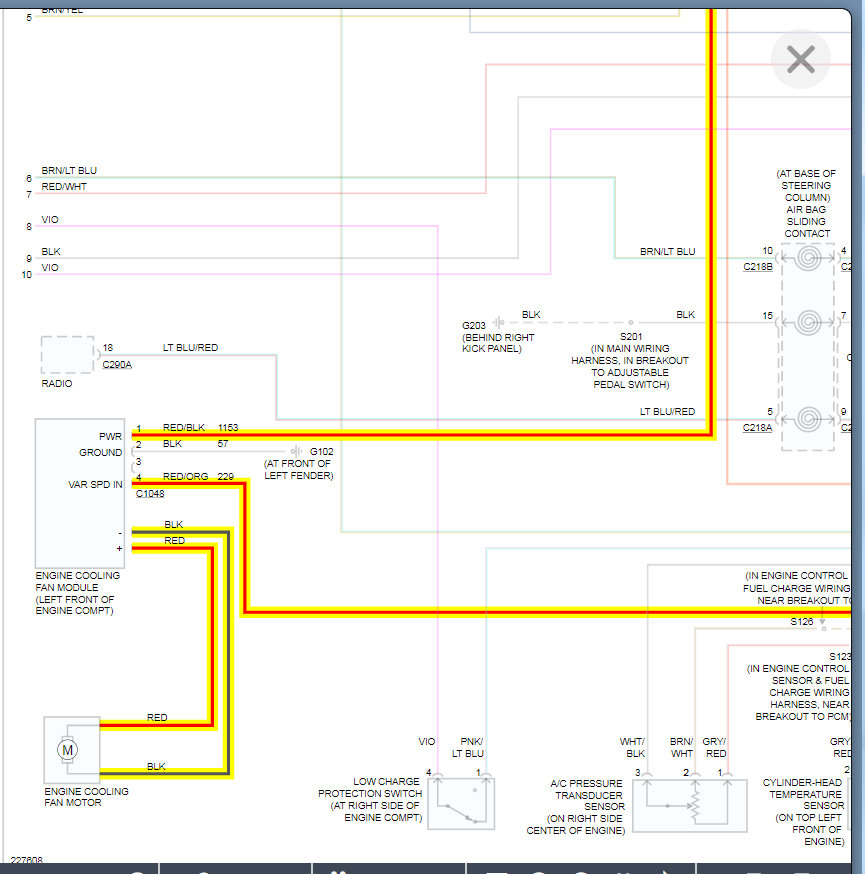

A/C works fine until car reaches operating temperature. Then it starts cycling rapidly and i notice the fan doesn't come on.

I should have explained this better. Everything works great until the car reaches operating temperature. Fans, A/C and all are perfect. It gets to a certain temperature and then the A/C starts cycling and it appears the fan isn't working. Like a relay or sensor is getting hot and failing.

I did evac and recharge system and again it calls for 27 oz and I only put in 24oz. with about an oz of dye. That should be plenty to work properly and not be overcharged. scenario goes like this. Start can and run with A/C off and no issues. turn on A/C and it works fine until it starts to build pressure and then when it reaches about 400 on the high side the system starts cycling and then the car starts to overheat. I have hot wired fans so they ran full blast and then started system and it did not keep system from building excess pressure. I am thinking blockage somewhere in the system that increases as system heats up but not sure if its compressor, accumulator or condenser and don't have an issue replacing all three but don't want to do that to find out it's another issue.
