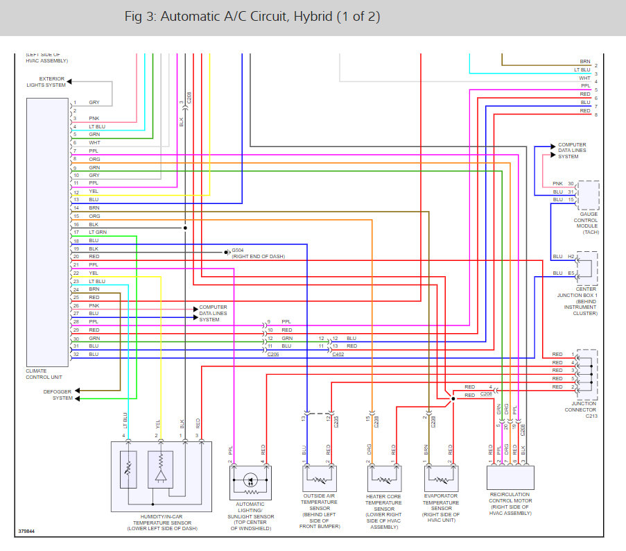

When driving my A/C will automatically go from cabin air (cold air) to outside air (warm air). After a few minutes it will switch back to cabin air (cold). This cycle keeps repeating itself. When it cuts off I cannot manually switch it back on. What could be the cause of this?

Can I ask if the air flow remains the same as these changed occur? I am trying to see if the system is icing up or if it is a blend door issue.

The air flow remains constant. I have also noticed that it happens when the outside temperature is around 100 degrees or above. That occurs nearly every afternoon this time of year in South Texas. It works fine mornings, early afternoon and evenings. Not sure if this added information helps or makes since or not. Thanks for responding!

Thanks for the article. If it is a blend door issue would that also effect the defrost? That doesn't work all that great either.

If the system is down on charge it will ice up causing the air flow to slow and the cold to stop working. So we need to tell if it is a vent issue or an pressure issue. Here is a guide that will help:

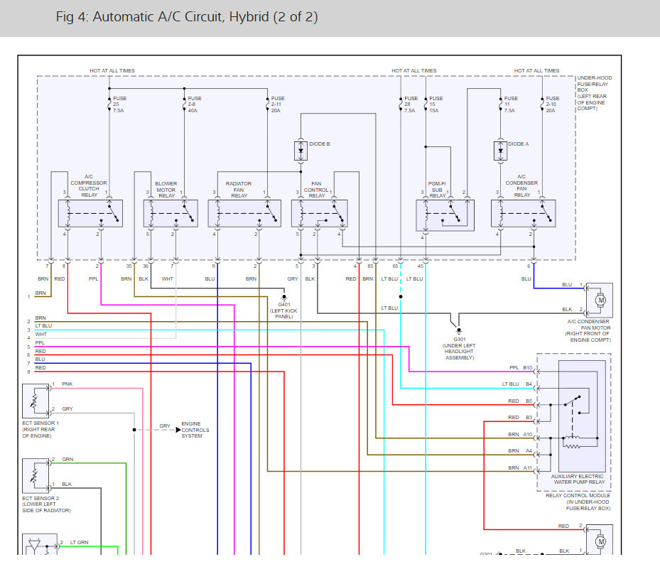

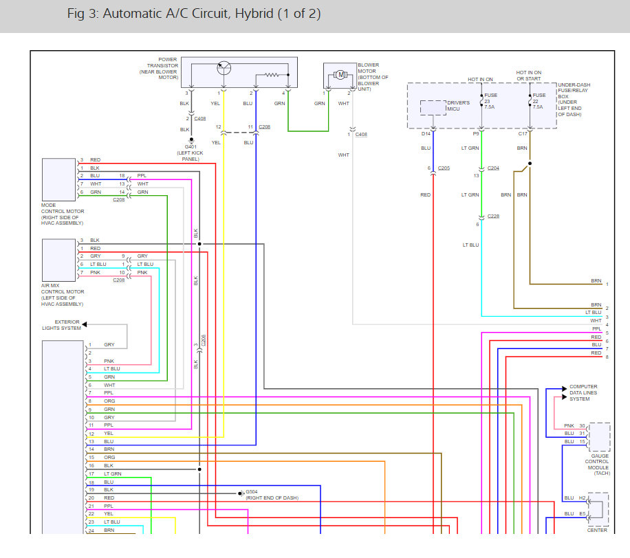

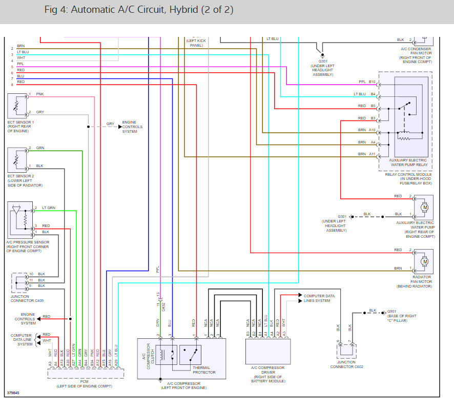

Nice work on the video. One of two things can be happening which we will check for, either the AC compressor stops working (clutch issue) or the mode blend door is having a problem. So this is what I want you to do. When the AC stops blown cold pull over open the hood and using a flashing light see if the compressor clutch is turning. This guide will help:
Next grasp the larger AC tube coming from the firewall to see if it is cold. If the compressor is working and the tube cold it will be a blend door issue. Here are the air conditioner wiring diagrams so we can see how the system works. Check out the diagrams (below). Please let us know what you find.
