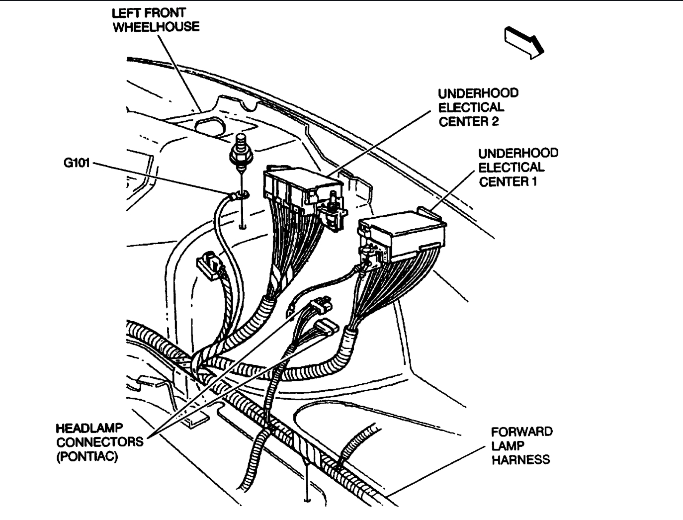

No codes when use reader. AC compressor does not come on when AC selected. Vents and heat work.

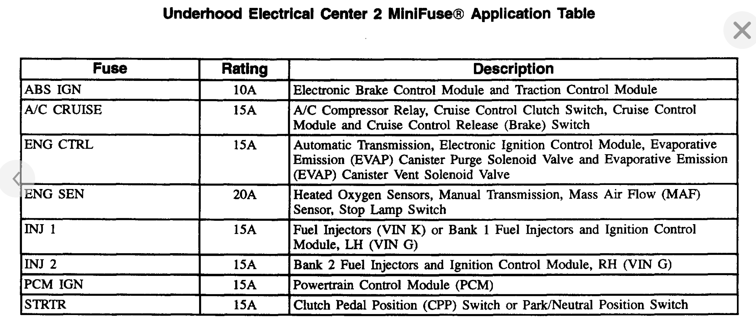

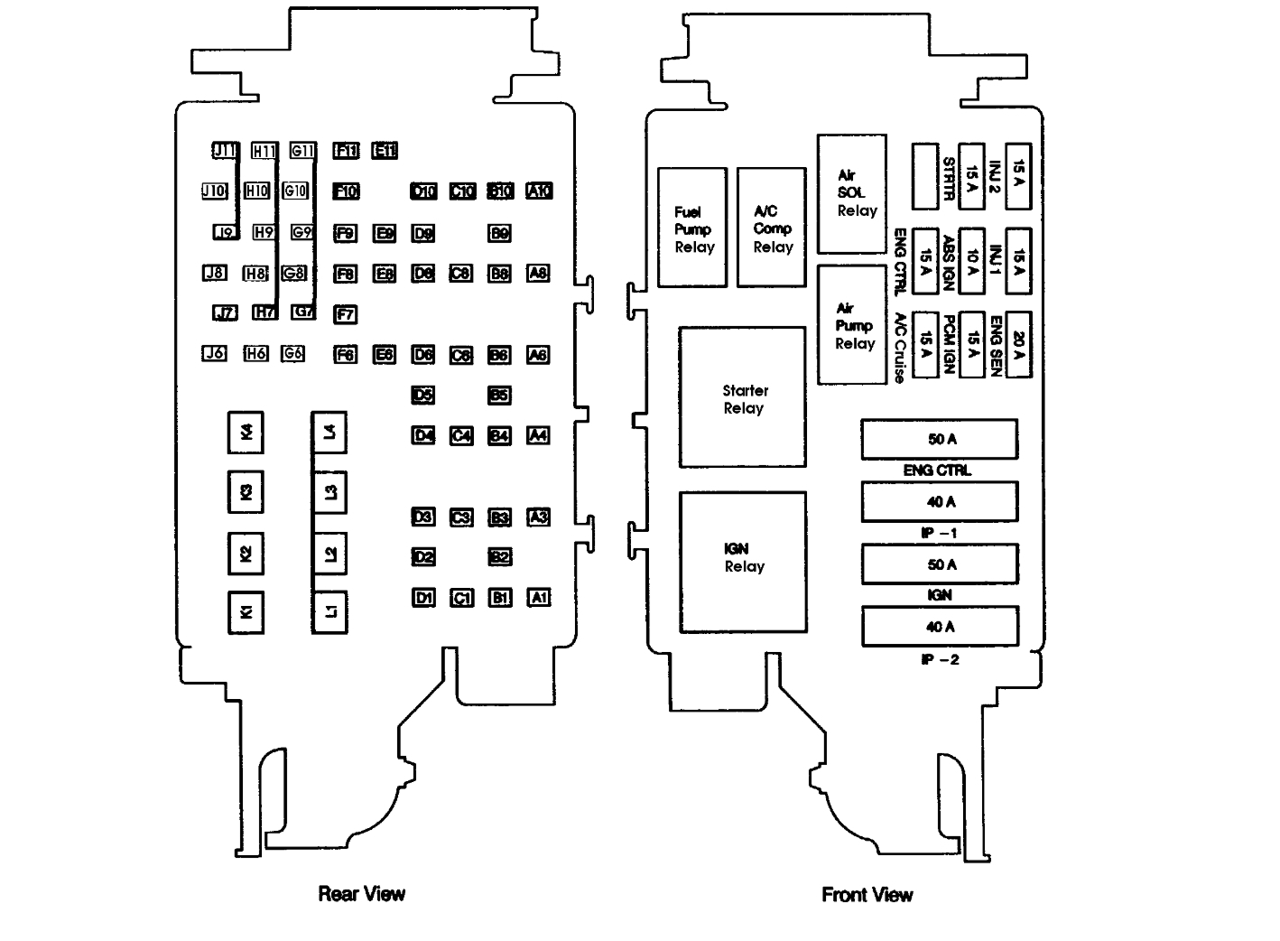

Hey FIREFIGHTER285,
There is a fuse which covers both A/C clutch and cruise control. Most likely your issue.
15A mini fuse.
In the under hood fuse box 2.
I have attached the locations.

Thank you Joe for the quick reply. After I posted my question I looked further into it and found that fuse to be undamaged. I also replaced the AC resistor in the same box. AC still does not work. The cruise control worked one time after replacing the AC resistor. However, I don't know if that is the reason why it worked I guess there could be some kind of short in the cruise control. I can't see a reason why the cruise control would work after replacing the AC resistor. Still searching for a reason why AC does not come on.

Do you mean the A/C relay in that box?
After replacing the relay did you recheck the fuse?

The first test will be to check you have power both sides of the fuse.
The guide i sent you before is great to run you through how to do this.
This fuse is only powered with ignition on/engine running.
Once you are happy you have power to both sides of the fuse we can then run through further tests.
