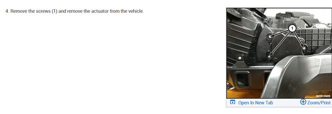

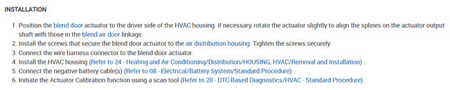

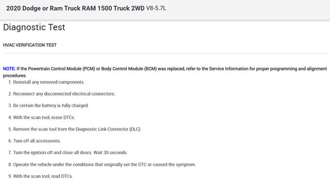

It sounds like the orientation of the blend door drive is not timed correctly or the actuator is defective. Also, it says to Initiate the Actuator Calibration function using a scan tool, did you do this? Check out the images (below). Please let us know what happens.

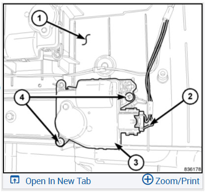

Okay, let's remove the actuator and work the blend door pivot by hand when the system is on low to see if you can actuate the door by hand. This guide will show you what I am talking about:
Please go over this guide and get back to us.

Just the one you replaced, did the system work okay before you replaced the actuator?

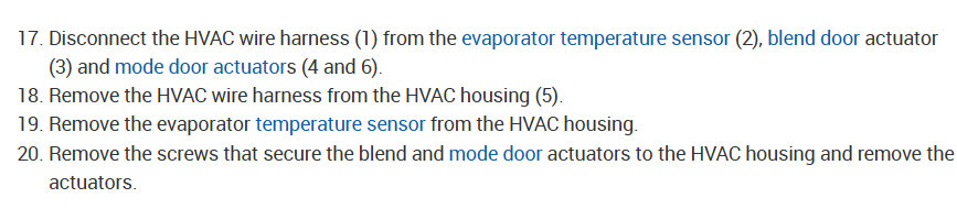

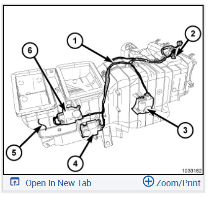

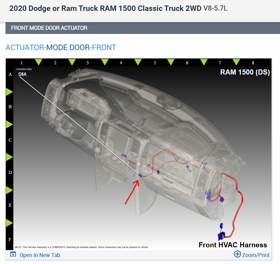

Okay so that works, does the drivers side work okay with the actuator connected? It might be you have a mode actuator that is not working. Lets try the same process for this actuator to see if things change.
Dec 23, 2024 at 5:12 AM
SSHAFFER92
  • 22 POSTS

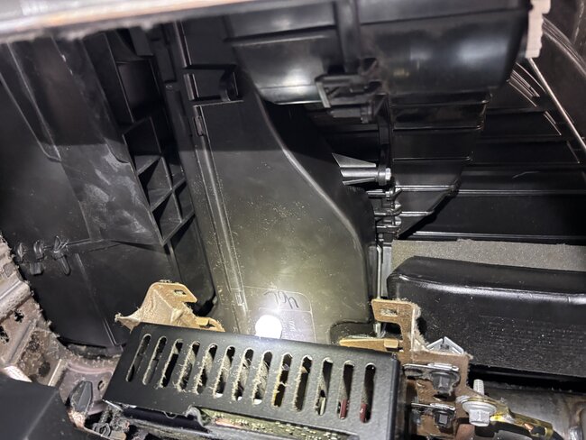

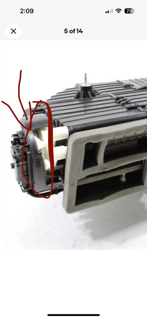

I have the center console removed but not seeing the actuator. Can you give more clarity to where it is?
Dec 23, 2024 at 10:22 PM

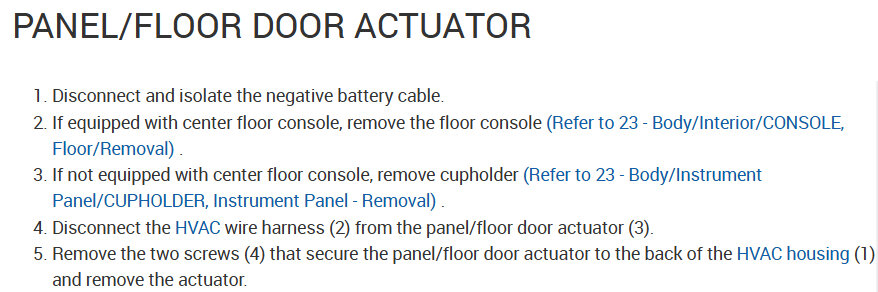

  • 55,748 POSTS
Sure, it looks like it is down low in the middle of the heater plenum. Check out the images (below). Let us know how it goes.

It might be under the plenum. Can you upload some images of what you are seeing?
Dec 25, 2024 at 2:20 AM
SSHAFFER92
  • 22 POSTS

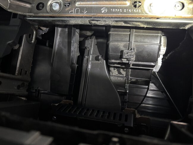

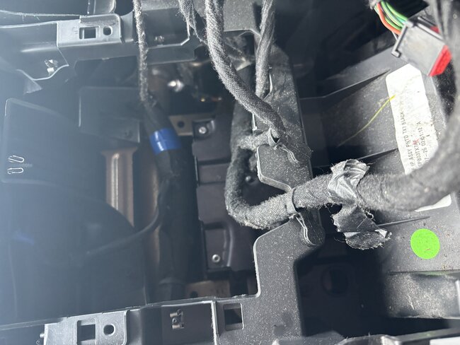

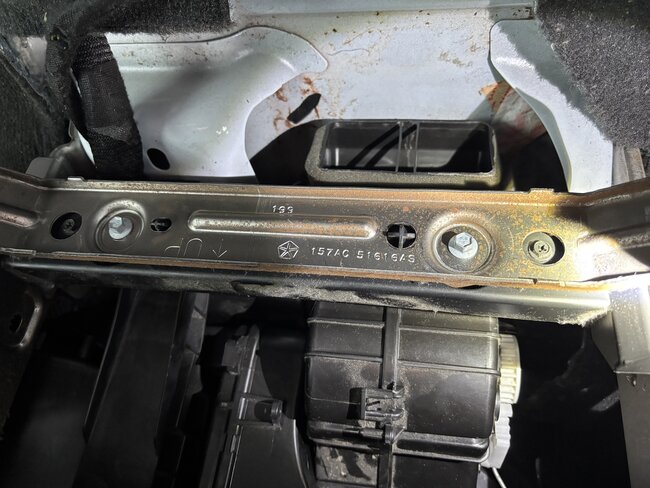

This is behind the center console and radio.
Dec 25, 2024 at 10:36 PM
  • 55,748 POSTS
Hmm, I don't see it either, does this truck have dual zone climate controls? It might be further under the HVAC plenum, this is all they show for the location.
Dec 26, 2024 at 4:01 AM
SSHAFFER92
  • 22 POSTS

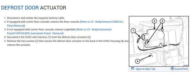

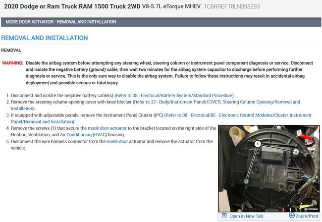

I found the mode door actuator it was the one by the steering column. I realized it was working properly, but the gear plate it is on is out of alignment. Do you have an image of it in alignment?
Jan 2, 2025 at 9:43 PM
  • 55,748 POSTS
Nice work, I found it as well, it is called the mode actuator 2. I don't see the gear you are talking about though. This shows all of the actuators.

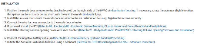

Right behind the actuator it has a cover then instead is a plate with slots in it that align to move the doors. I can’t get the alignment right for some reason.
Jan 3, 2025 at 4:14 AM
  • 55,748 POSTS

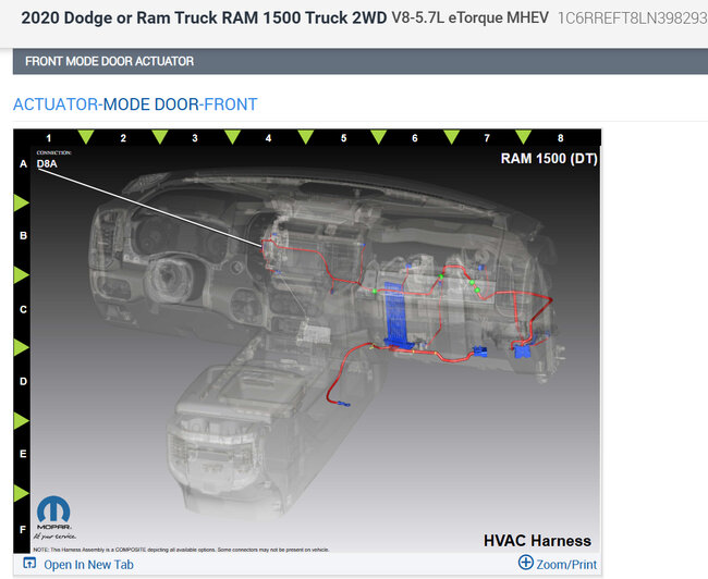

So this is strange, they don't show anything like that, can you give me your VIN so I can look it up that way?
Jan 4, 2025 at 3:09 AM
SSHAFFER92
  • 22 POSTS
The VIN is 1C6RREFT8LN398293.
Jan 4, 2025 at 10:47 PM
  • 55,748 POSTS

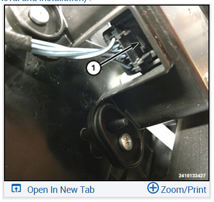

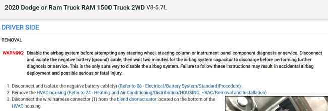

I see the truck is a hybrid. Here are the instructions for the blend door and the linkage, this should help. Check out the images (below). Please let us know what happens.
