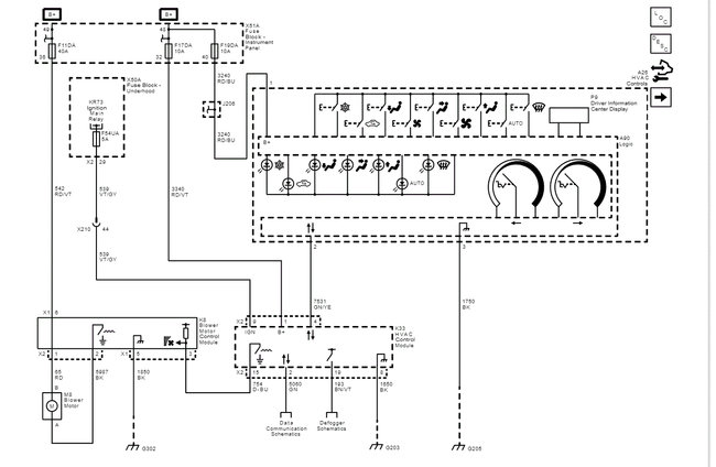

Hello! i just destroyed the connector terminal that goes into the A/C Panel. now i want to rewire the connector but i am not sure in which order the three cables should be connected. Anybody here that can help me?

That doesn't sound good. Listen, I would be happy to help but I need to know if you have automatic or manual climate control.

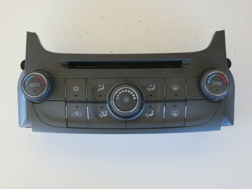

That’s how the panel looks like.

The connector is just a terminal socket with three cables going in.

That's for automatic climate control. I attached the wiring schematic below for the controller and control module.
Take a look through it and let me know if it helps. Also, here is a link you may find helpful:
See pic below.
