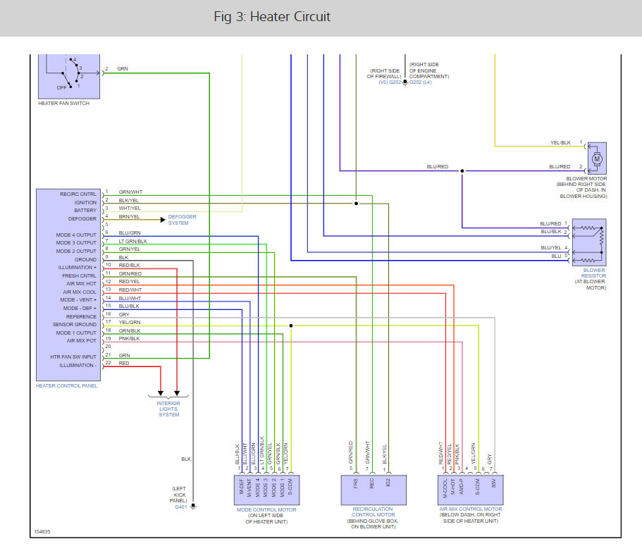

A/C Control panel intermittent, is there a way to troubleshoot the power supplies on the control board?
2002 HONDA ACCORD
180,000 MILES • 4 CYL • 2WD • MANUAL
JVTECH7

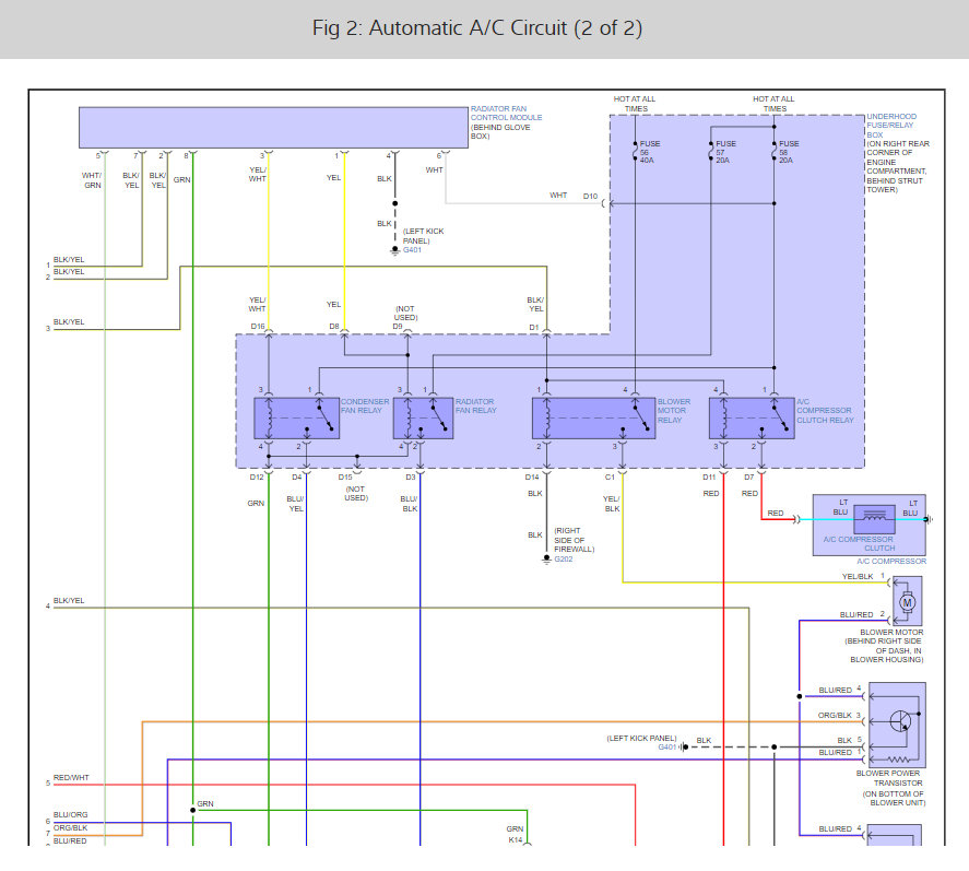

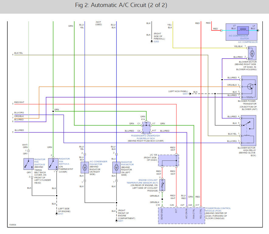

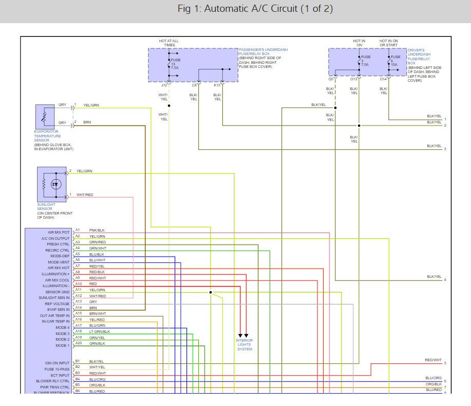

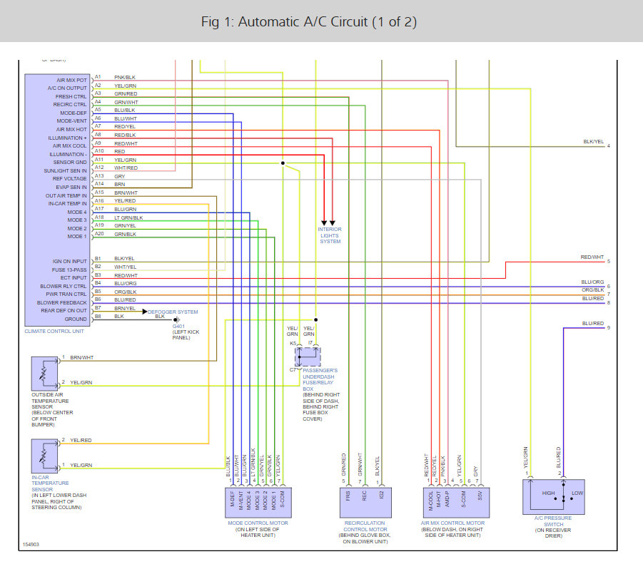

When working all functions seem to work normally. Turning fan control from off, if mode LED illuminates, system works, air controls direct air properly heat/cold respond. When LEDs do not illuminate, fan speed functions but no other functions work. Is there a way to troubleshoot the power supplies on the control board?
Jul 25, 2022 at 9:03 PM
  • 55,433 POSTS

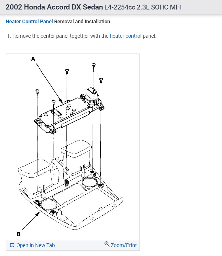

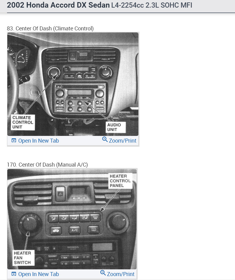

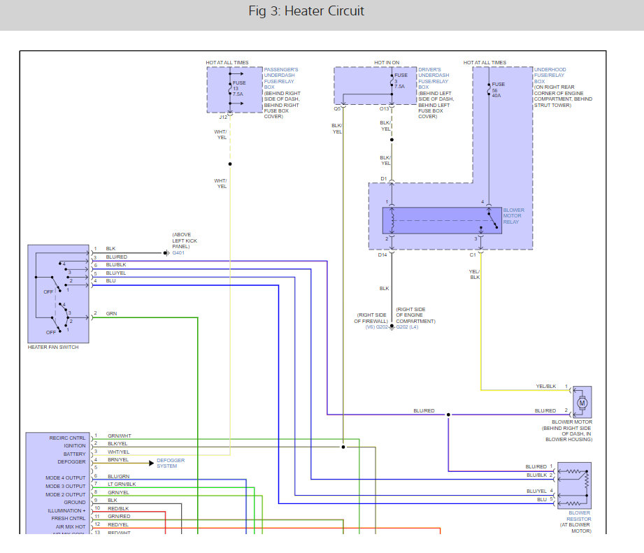

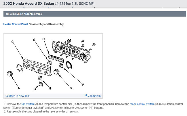

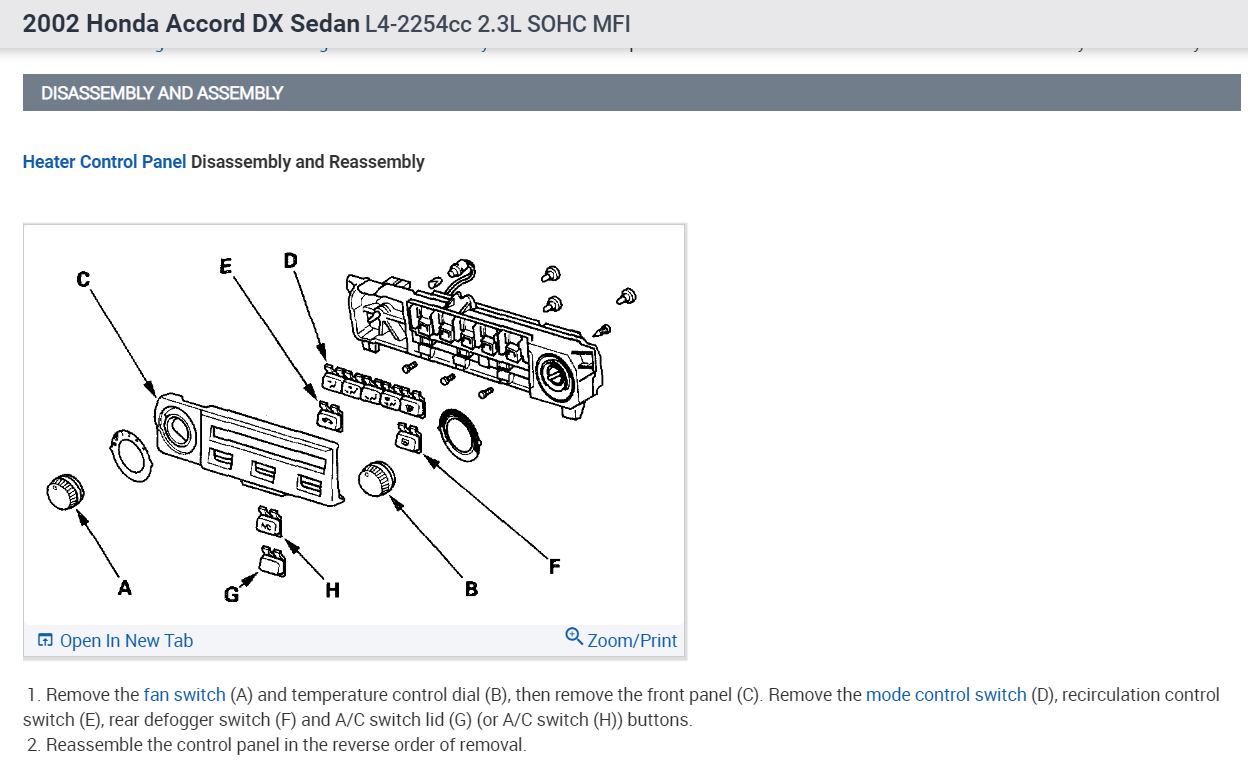

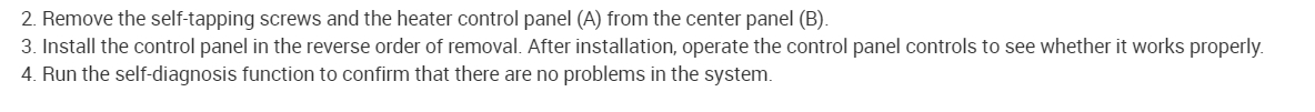

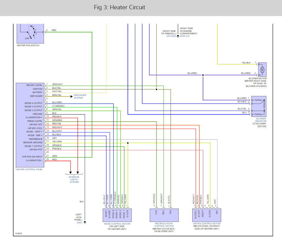

It sounds like you have an HVAC control panel that is going out, but to be sure here is a guide to help you check for power and ground with the HVAC wiring diagrams so you can see which wires to test in the images below. I have also included how to replace the control panel as well.
