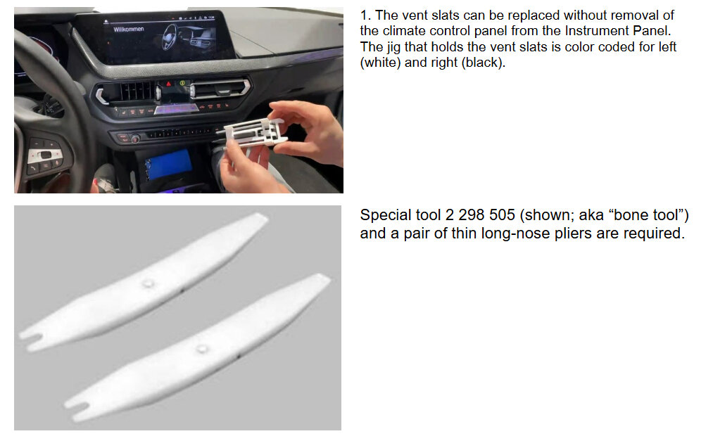

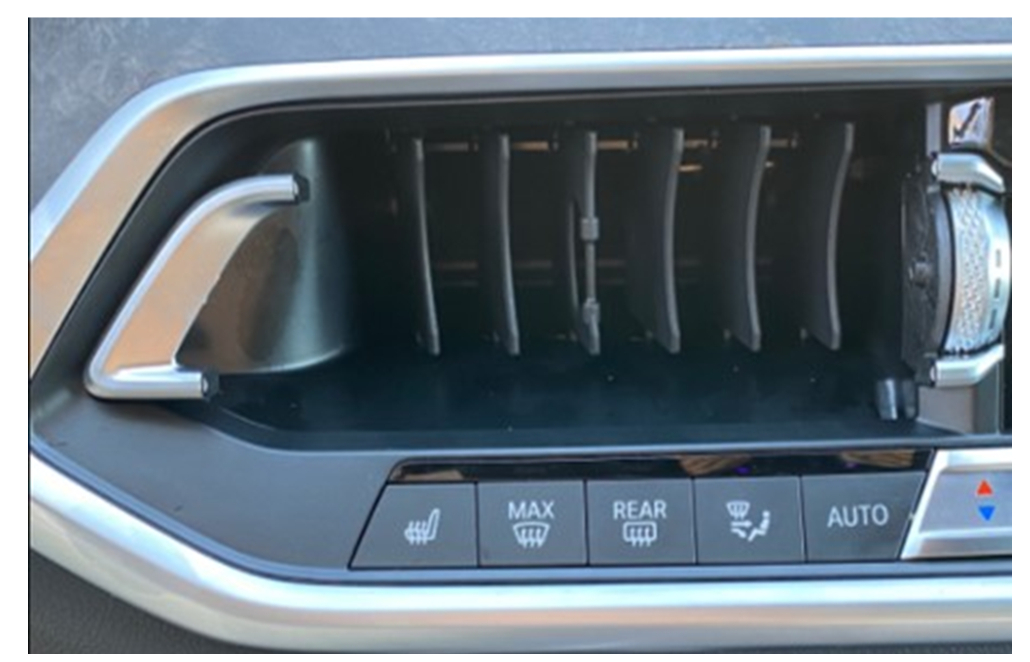

I need instructions on how to remove the A/C control panel and replace the A/C vent because mine is broken.
Jan 26, 2025 at 3:47 PM

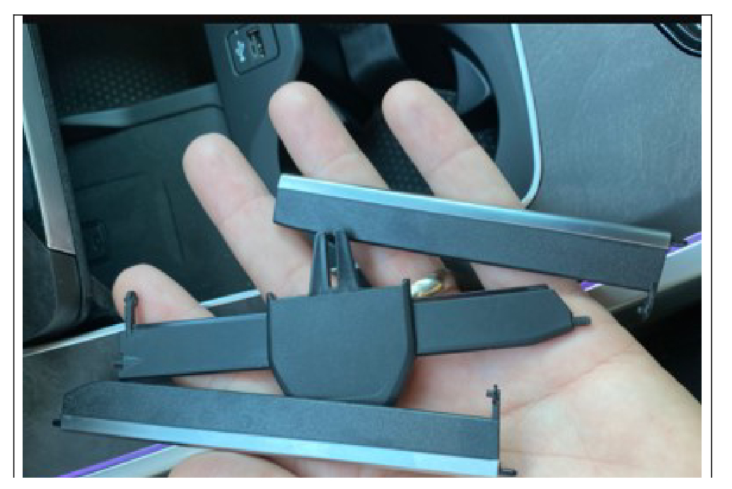

AMOOMAND
Photo of part i need to replace.
Jan 26, 2025 at 3:50 PM
  • 55,214 POSTS

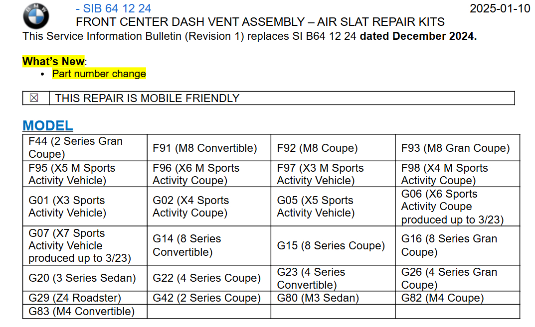

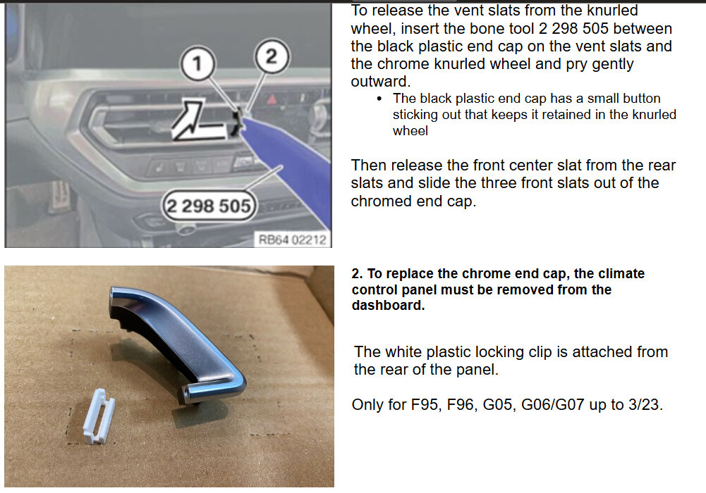

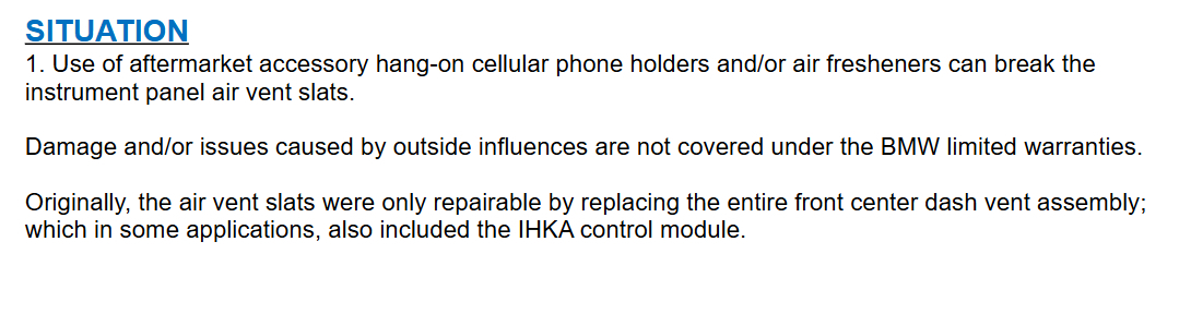

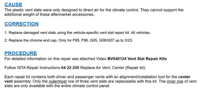

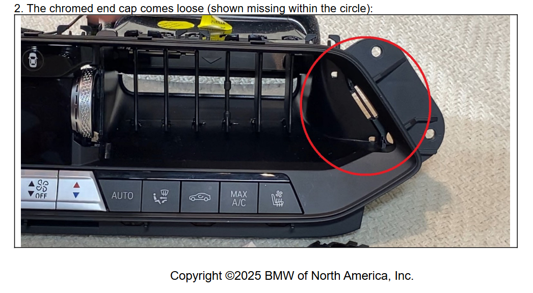

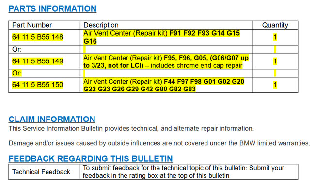

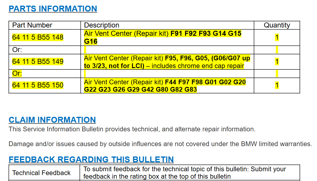

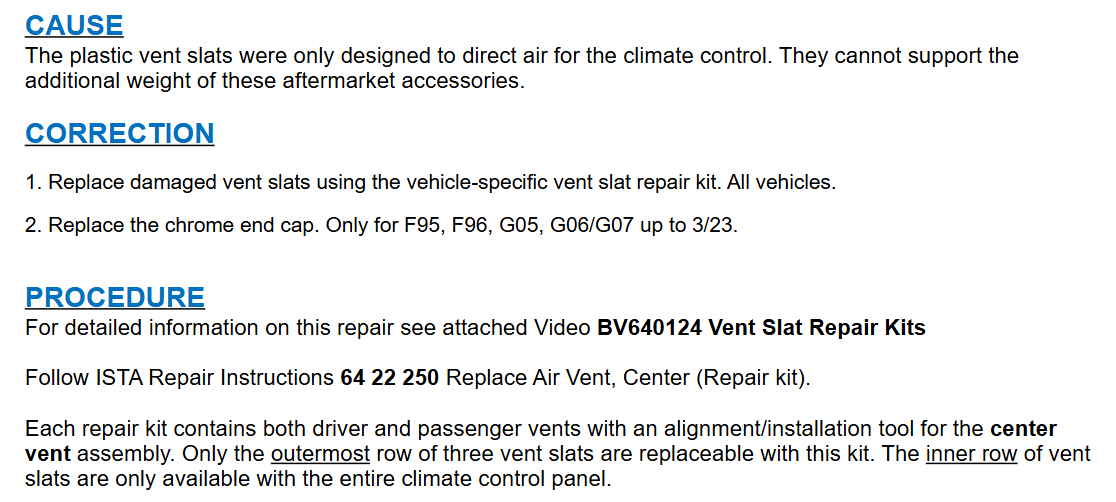

Yep, there must be a problem with these vents because there is a service bulletin for this repair. Here is how the job is done but you will need a special tool for the repair FYI. Check out the images (below). Please let us know what happens.
Jan 27, 2025 at 3:11 AM

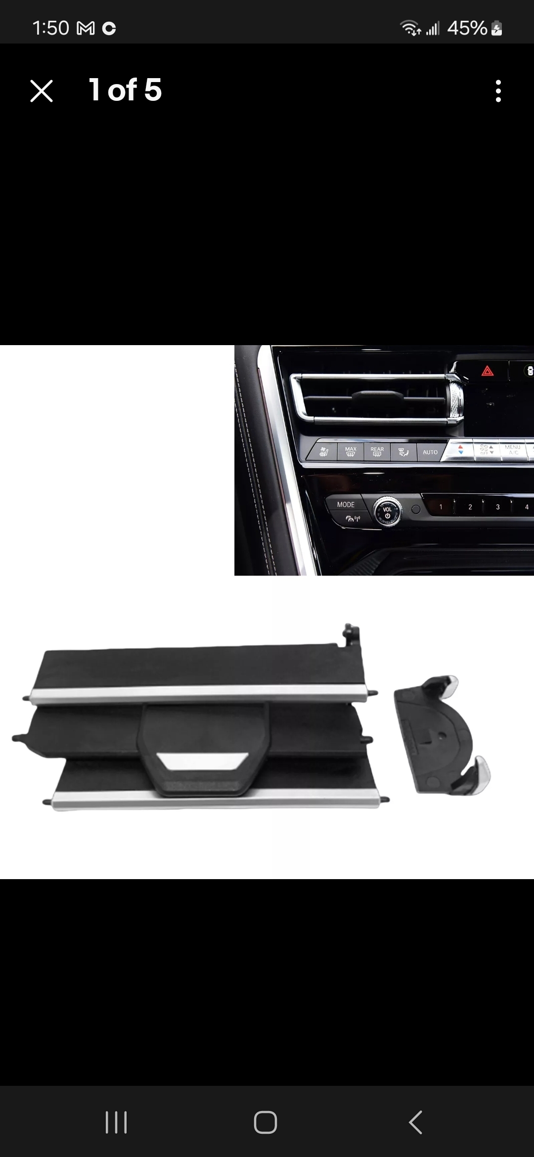

AMOOMAND
Man I fixed it lol. And I did it the way they say isn't possible. I bought a used ac control unit for $200 on eBay and took the vents from it and put it in my original. It's a little bit of a pain but so much easier than taking apart the whole dash.
