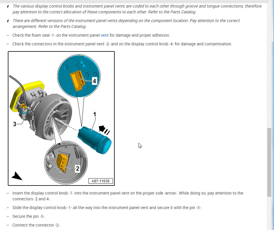

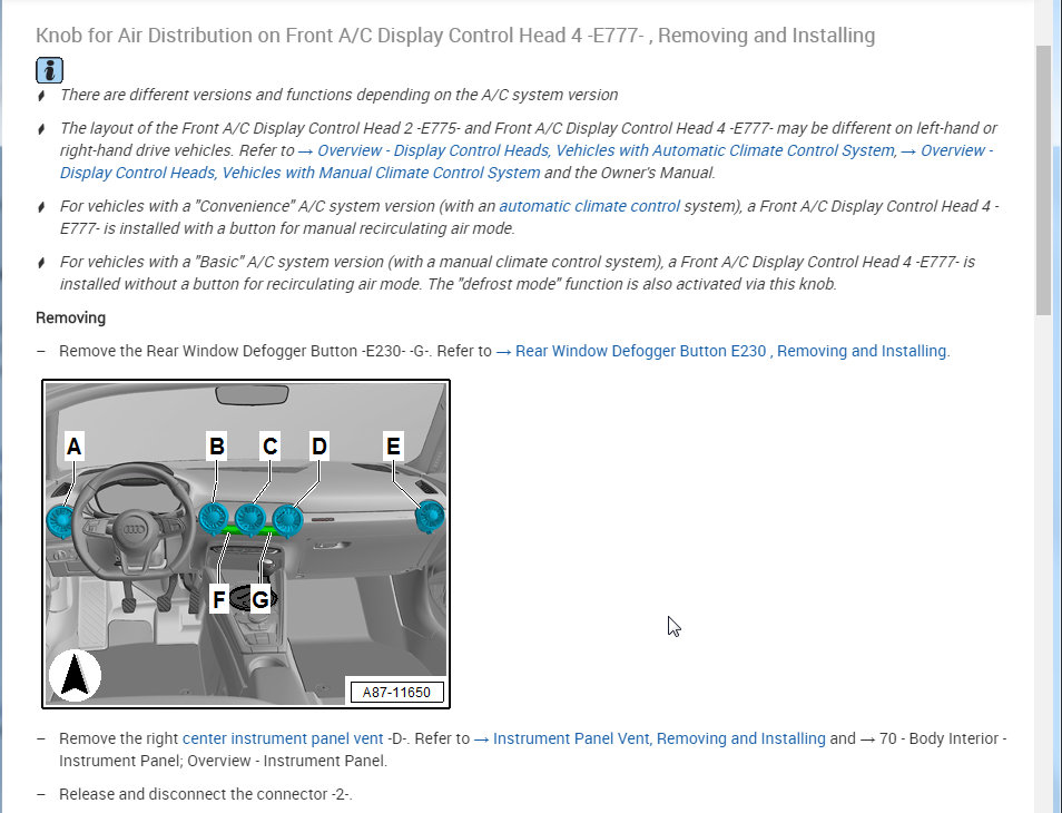

Does your A/C control panel need to be coded if replacing?
May 27, 2020 at 2:56 AM

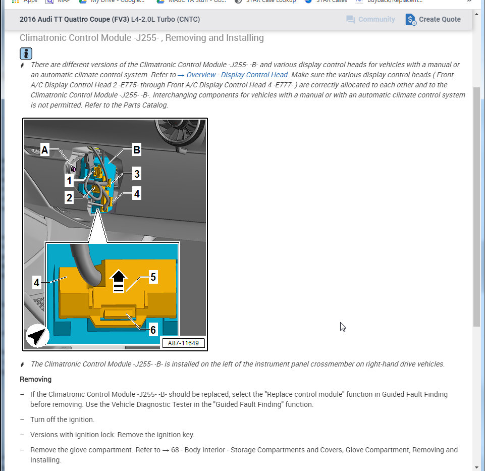

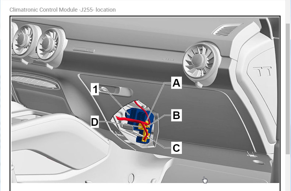

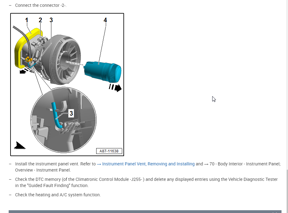

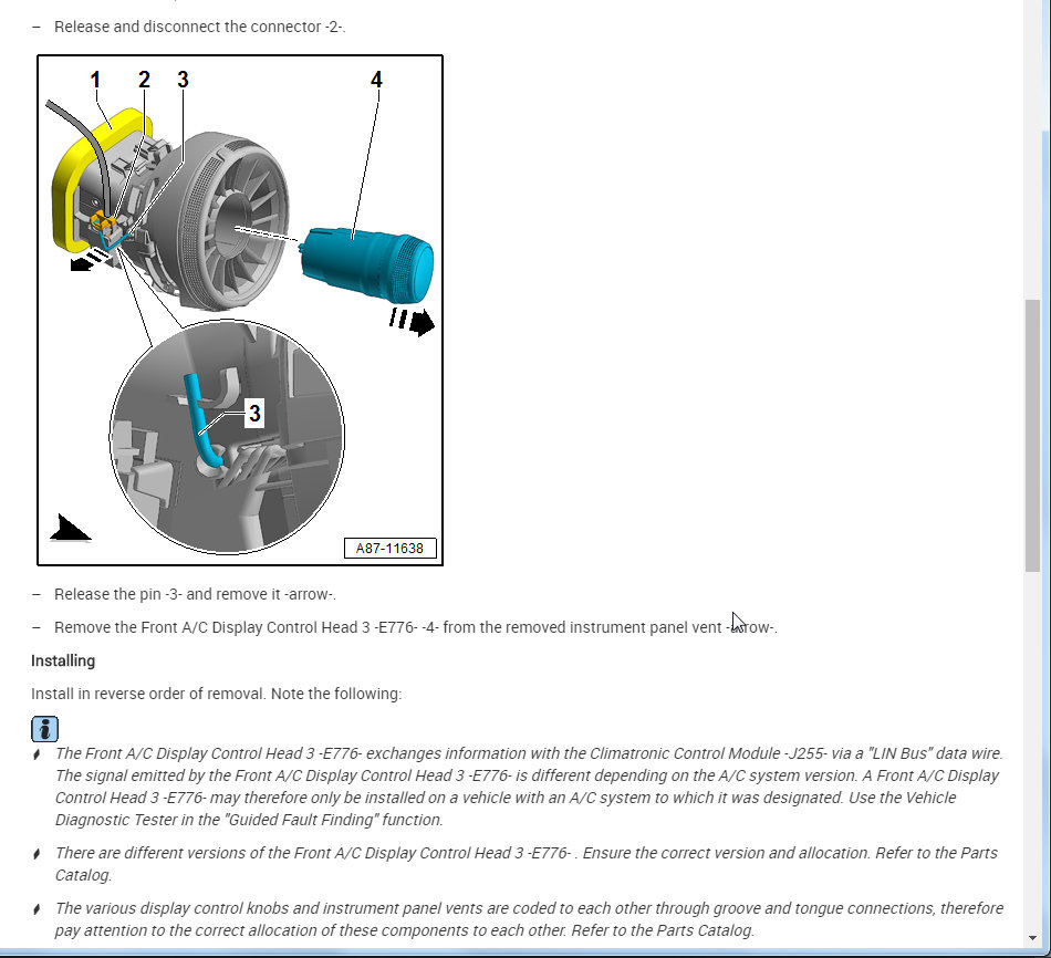

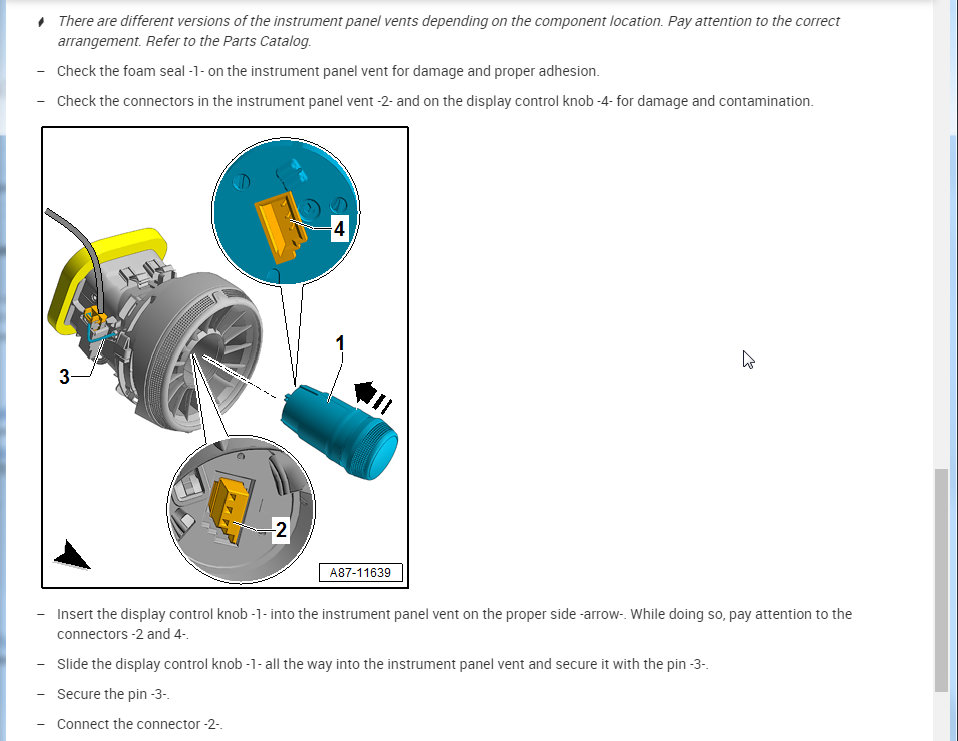

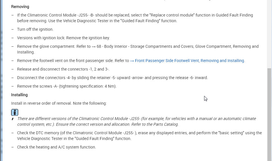

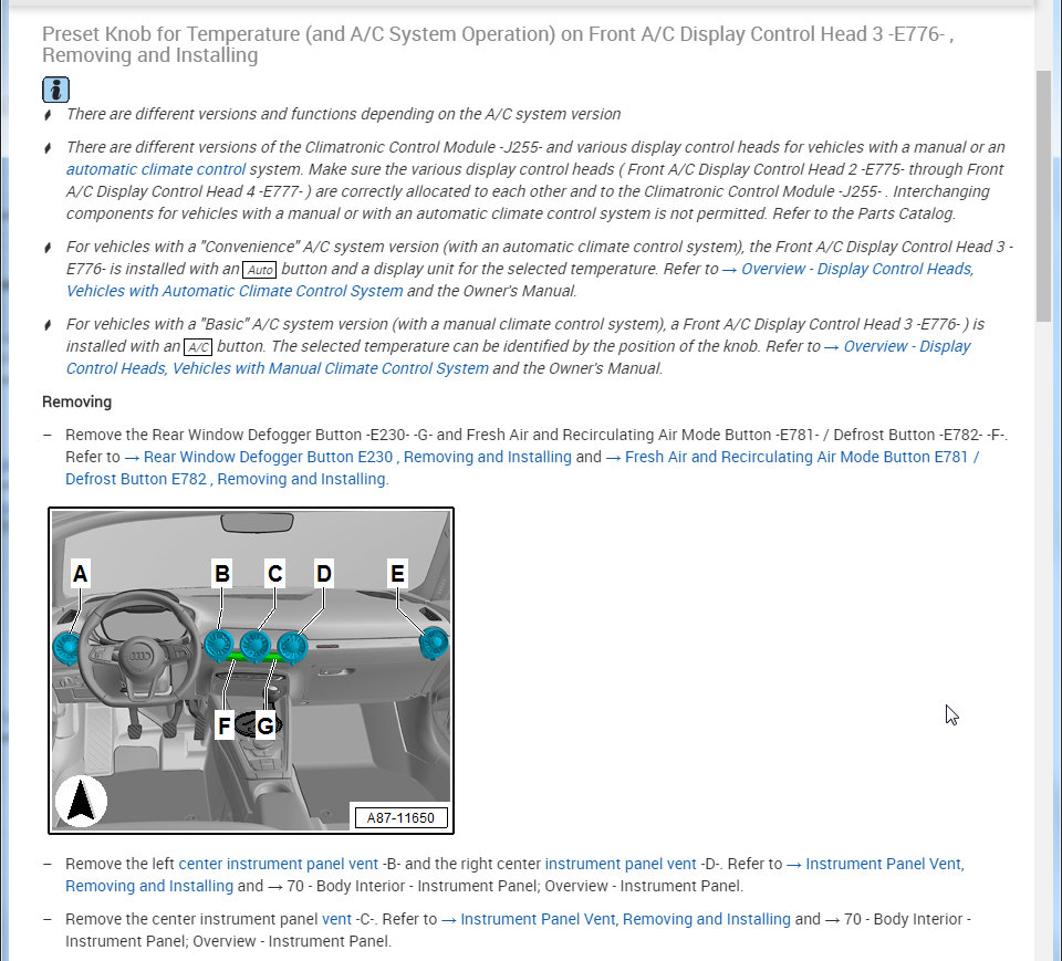

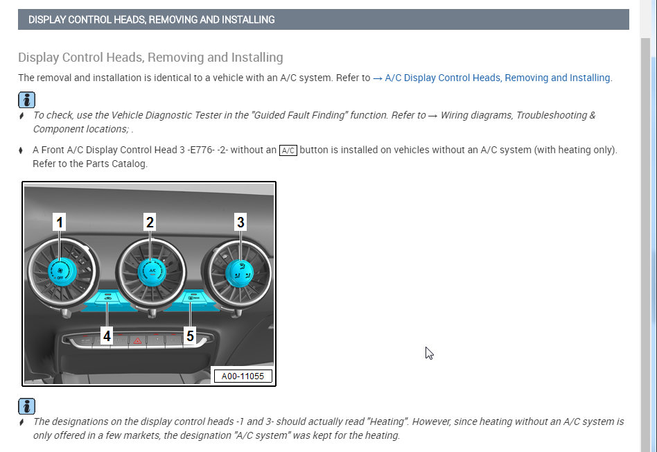

When you say control panel, I assume you are talking about the buttons that your press shown in the last attachment. Or do you mean the control module? The control module does require a procedure run after replacement. I attached the process. The control buttons on the dash do not require any programming after replacement.
Hopefully this helps. Thanks
May 27, 2020 at 11:14 AM
MIGUEL ANGEL SERNA

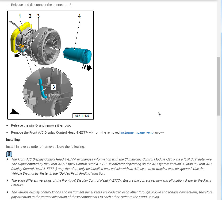

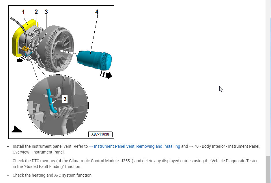

Thank you so much that was very helpful. Yes, I was talking about the buttons to control the temperature and air flow. They told me that needed coded but it didn’t seem right. do you have any diagrams that will help me replace the panel?
May 28, 2020 at 10:36 AM
I am sorry. I thought I sent that to you. Clearly I didn't. Here is what the manual has for replacing these. Let me know if you need more info. If so, we may have to try and find some videos online because the manuals don't have any other info for this specific process. Thanks
