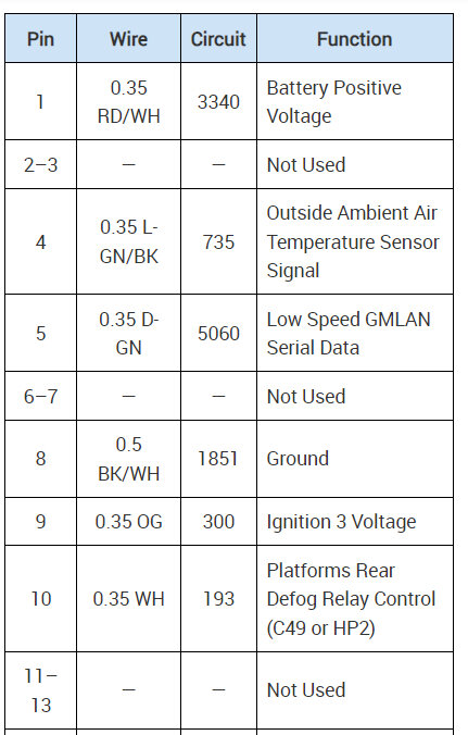

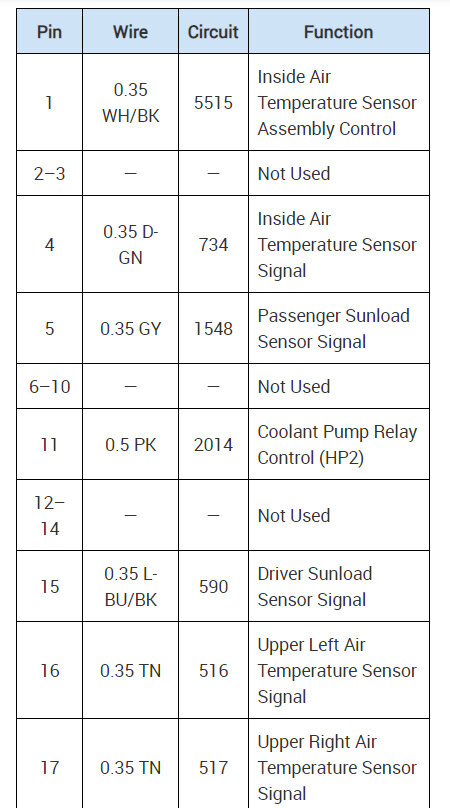

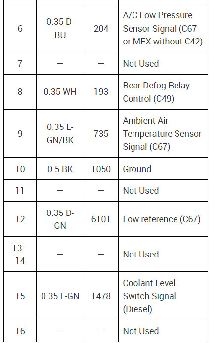

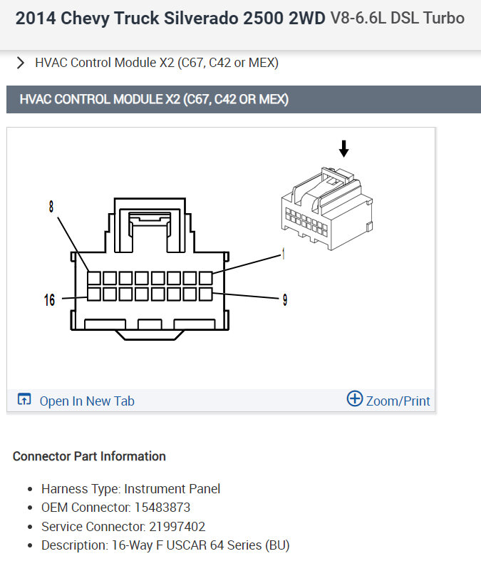

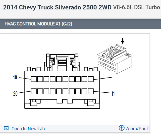

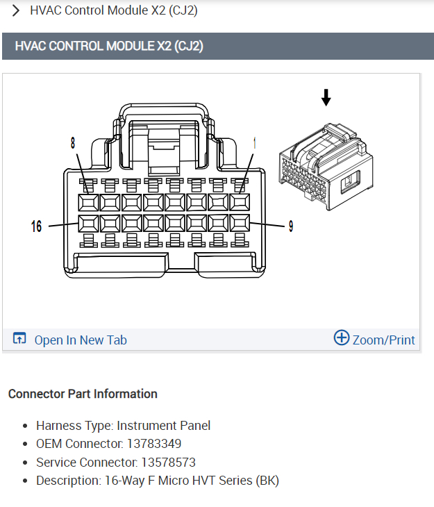

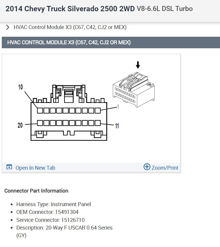

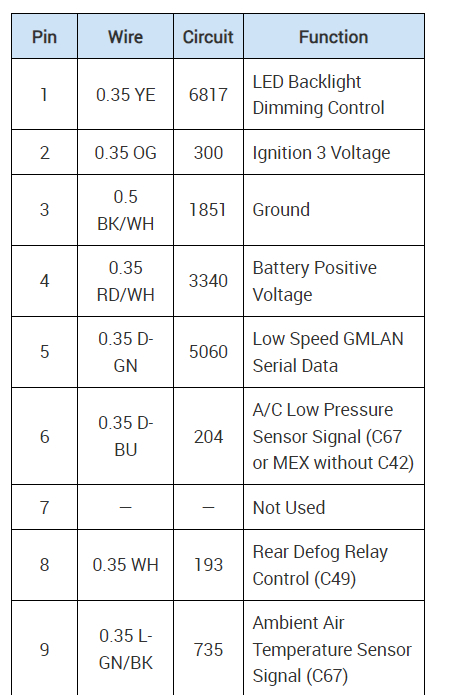

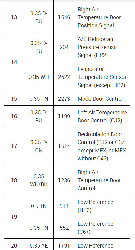

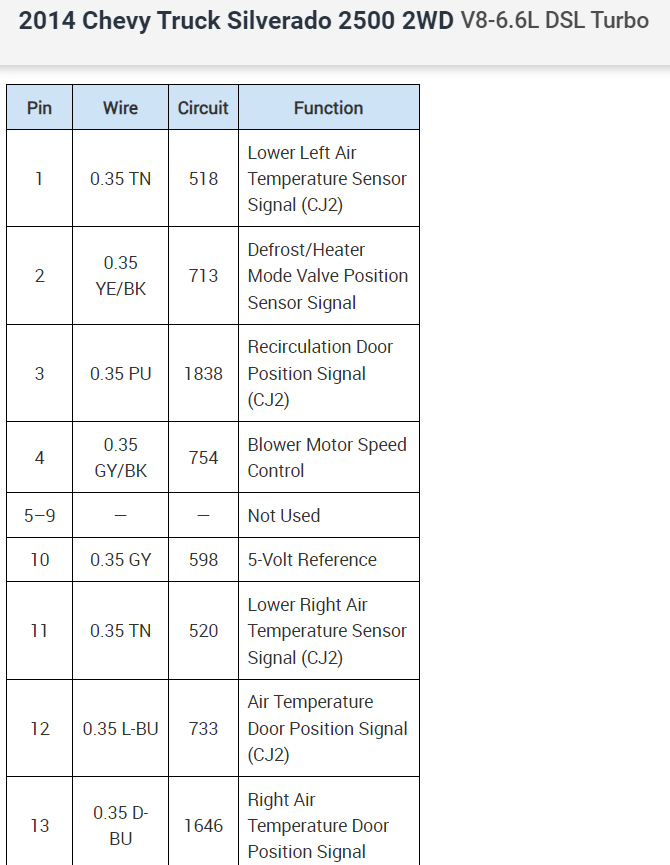

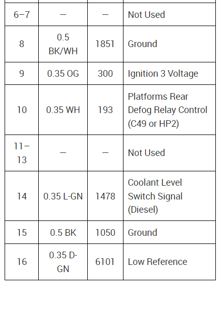

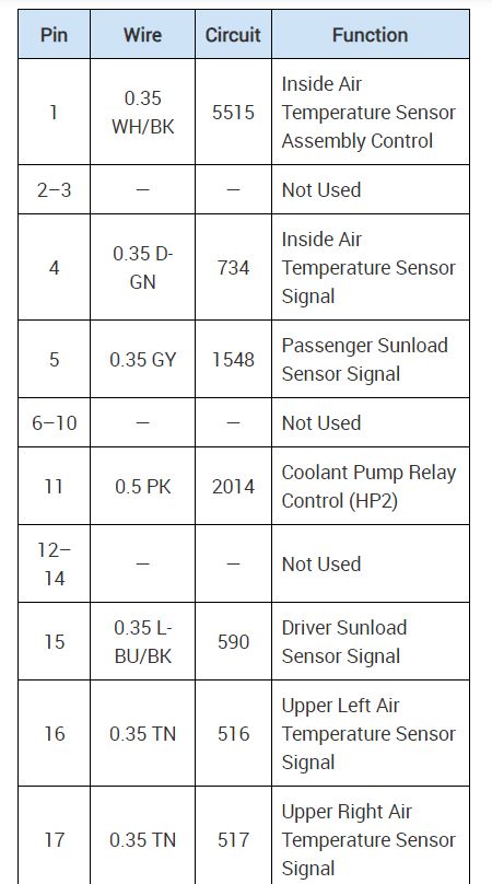

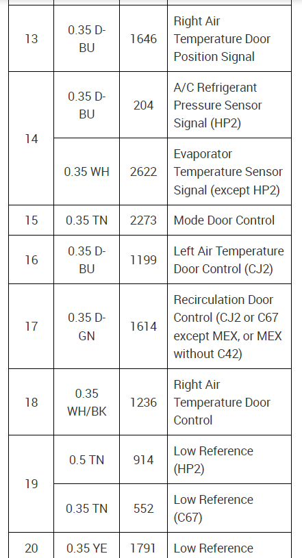

Someone broke in my truck and cut the big wiring harness that goes to my A/C control module, and I ordered a new one but I'm not sure how to pair the wires back up. It has 3 plugs on the back of the module J1, J2, J3.
Aug 24, 2024 at 12:38 AM
  • 55,399 POSTS
Sorry to hear about your truck break in. Here are the pin-outs for the HVAC controller as requested, Check out the images (below). Let us know if you need anything else.
