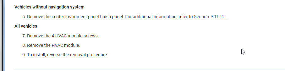

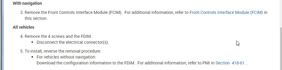

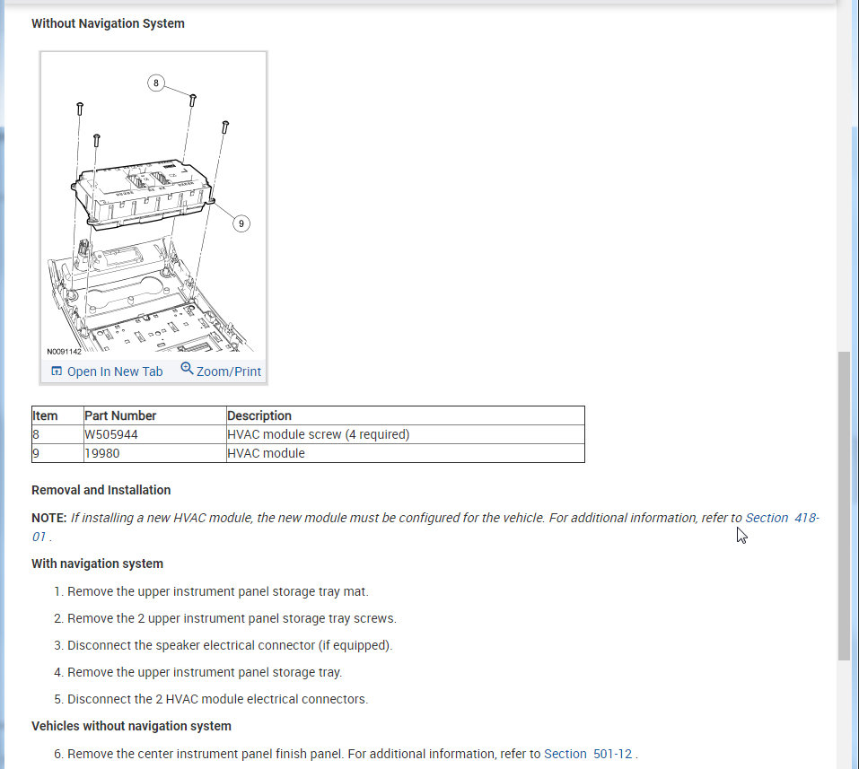

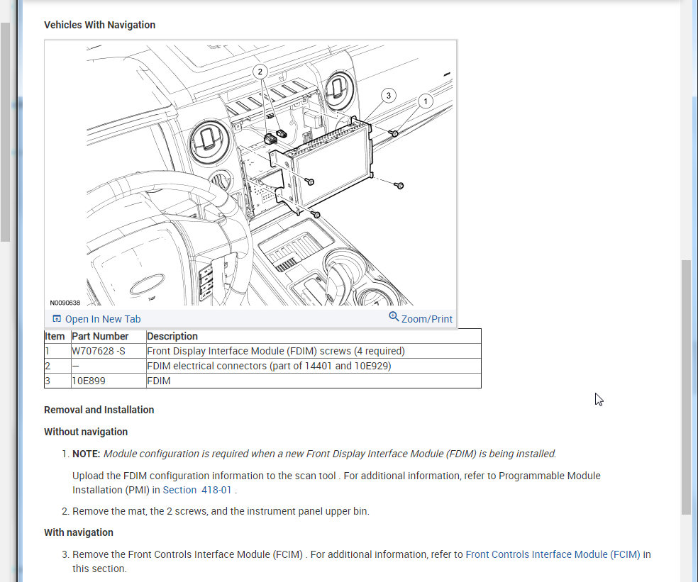

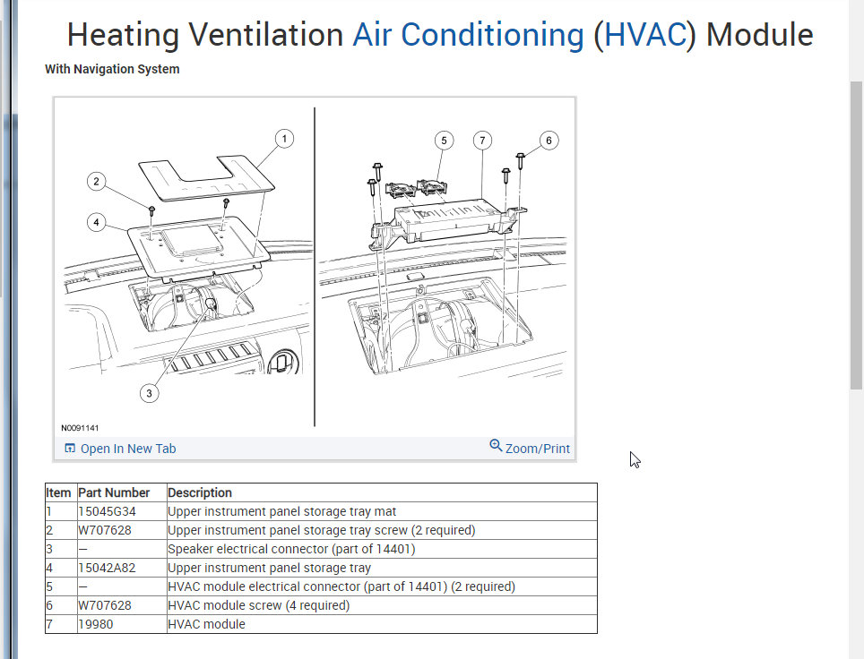

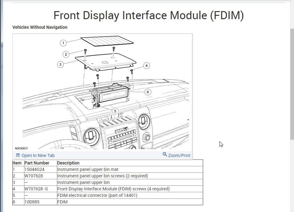

My truck has an AC control head module that has gone bad, but upon calling Ford the part I need has been discontinued. Is there a way I can use one of the different part numbers to fix this and be okay?
Nov 13, 2017 at 5:15 AM
Sure. Here is the process for both the module and the display module depending which you are looking for.
Please run through this and let us know what you find. Thanks
