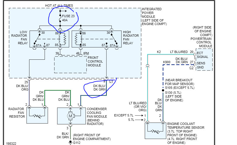

Could this cause engine temperature to ride as well as warm air instead of cold?

Good morning,
If the A/C fan is not working, the A/C inside temperature would be warm at idle and cool off while driving.
https://www.2carpros.com/articles/how-an-electric-cooling-fan-works
If the engine is running hot, the A/C system will not perform correctly either.
Image (Click to make bigger)
