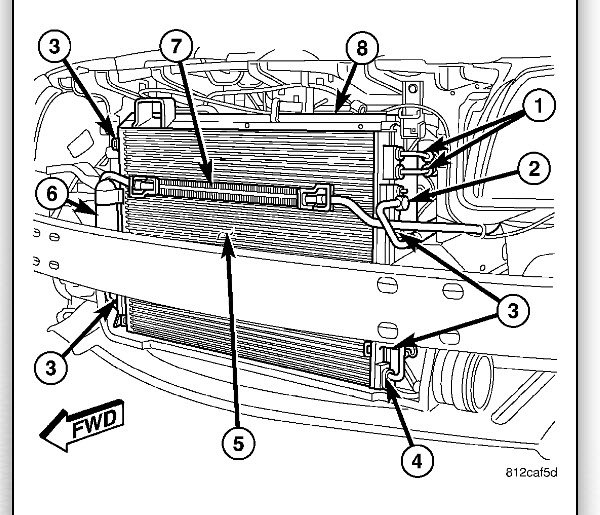

When installing a new condenser with the receiver/drier attached, do you have to add PAG46?
Jul 23, 2017 at 1:43 AM
HMAC300
Experienced Mechanic
48,601 POSTS
to replace the oil that was in old condenser so you do not burn up the compressor. it takes one ounce. See picture and video.

The new compressor came with five ounce's . Do I add an ounce in the new condenser?
Jul 23, 2017 at 7:06 AM
HMAC300
48,601 POSTS
Yes it will circulate all through the system.
