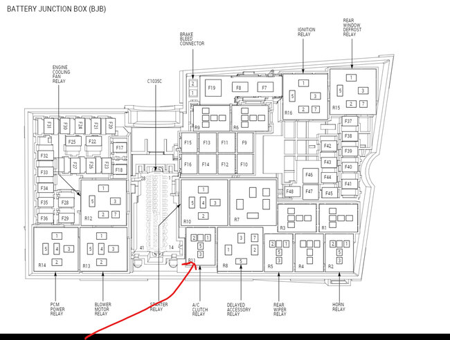

Ac compressor relay location please?
Nov 3, 2022 at 1:11 AM
Experienced Mechanic
55,628 POSTS
The A/C compressor relay is inside the BJB battery junction box on the left side of the engine bay. Here is a guide to help test it and the location inside the BJB in the images below:
Check out the images (below). Please let us know if you need anything else to get the problem fixed.

How do i junp it? Pins 87 and 30?
Nov 5, 2022 at 8:50 AM
BHAMDOC1973
MEMBER
2,007 POSTS
Jumped it and compressor started, added Freon and all is good.
