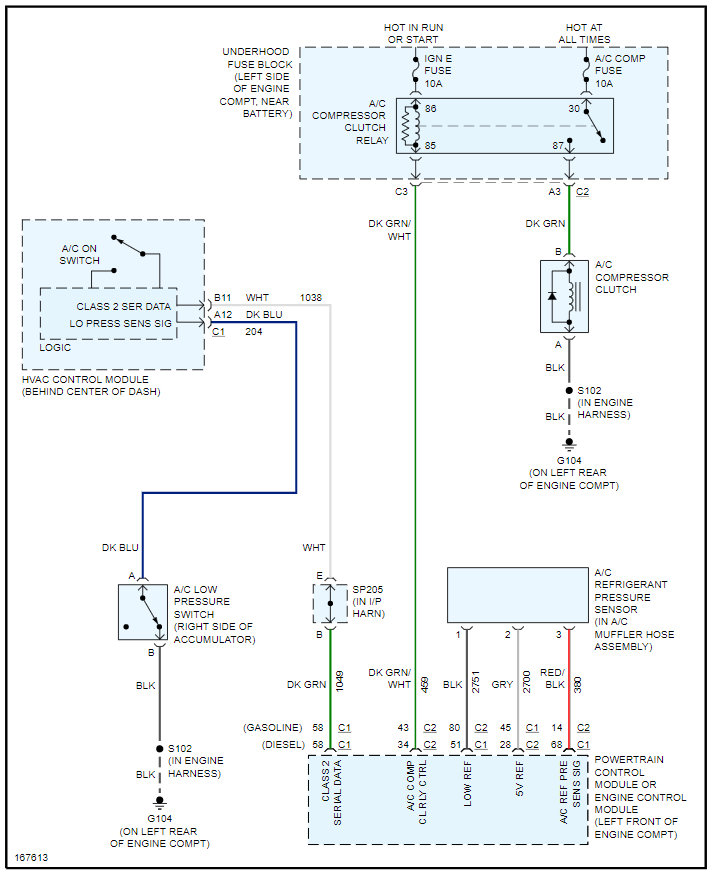

I have the truck listed above A/C compressor not coming on. I know that on relay the following:
Pin 86 has power key on
Pin 30 no power
Pin 85 no ground from ECM
Pin 87 no power to compressor
I did get the compressor to come on by jumping pin 30 with power and grounding pin 85
My question is, what is likely the problem? The fuse box underhood could it be a burnt wire under there? Or a burnt wire coming from ECU to relay? If I run a wire to a toggle switch in place of ECU ground will the compressor still cycle on and off? I also noticed no power to high pressure switch and no power to no power to low pressure switch. I have ground on both.
What sends power to high and low switches?
Jun 16, 2021 at 3:12 AM
Let's start with the relay issue because I suspect that will solve all the issues including the switch issue.
Take a look at the wiring diagram below. You will see that you have a fuse that is responsible for sending power to pin 30. If you have to put 12 volts to 30 then that fuse is most likely the issue.
However, the way this works is power is supplied to pin 30 and 86 from the fuses.
Then the PCM grounds the relay on pin 85 which then closes the relay and sends the power from pin 30 to 87 and then the compressor and then to ground.
So if we have no power to pin 30 we need to check that fuse. Then we need to address the no ground from the PCM. That could be a switch issue but we need to find out how you tested it.
You need to put your red meter lead or test light clip on battery positive. Then touch the other lead to pin 85 and turn the engine and A/C on. The light should come on or read 12 volts. If it does not then we have another issue.
Let's start with checking the fuse and going from there. Thanks

Can we take a step back and clarify how you tested pin 85? I assume the relay was removed.
If it was then did you put your test light clip on ground or battery positive?
This terminal is a PCM controlled ground. So the way this works is the IGN E fuse supplies 12 volts to pin 86. However, this is an open circuit until the PCM supplies the ground to pin 85.
So to test this you need to put your test light clip on battery positive and then touch the probe to terminal 85. Then start the engine and turn the AC on.
This will test the PCM's ability to ground the circuit.
Then when the PCM grounds this circuit it energizes the relay and it pulls the switch closed and it sends power from terminal 30 to 87 which turns the compressor on.

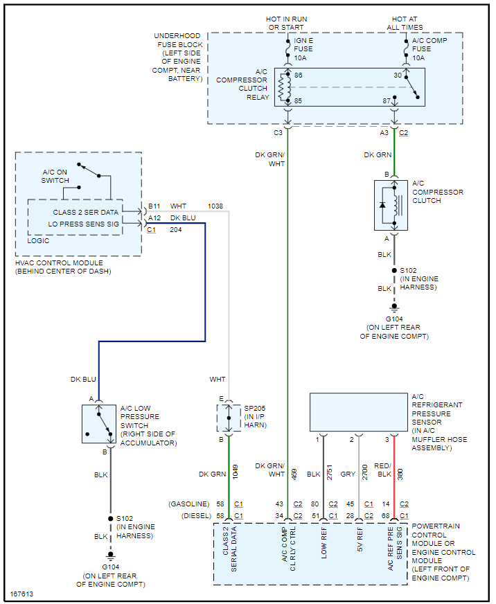

Okay, I did some more testing. I took the black plug off back of fuse box and the green wire with white strip I’m sure is the PCM wire that is supposed to supply ground to relay. I touched it with test light and it had no ground but had power. I have a test light that has a red plug and a black plug to connect to battery. When testing if light is red that’s positive and green if negative. Checked 3 times and had power. The green wire on back of plug I assume is wire to compressor had no power.
Jun 29, 2021 at 1:16 AM
HD2424
  • 190 POSTS
I checked green wire with white stripe and nothing coming from ECM it just power coming from fuse box.
Jun 29, 2021 at 4:01 AM
Okay. Let's pause for a minute. The system is empty now and this is when you were testing if the PCM was grounding the relay?
If that is the case then that is expected as the pressure sensor will tell the PCM not to ground the relay and turn the compressor on as the pressure is too high or low.
If this is the case, then we need to refill the system with the proper amount of freon. You need to jump the relay to get the compressor to start pulling in freon once the can will not fill it any more.
https://www.2carpros.com/articles/air-conditioner-how-to-add-freon
Please let me know if I have this wrong. Thanks

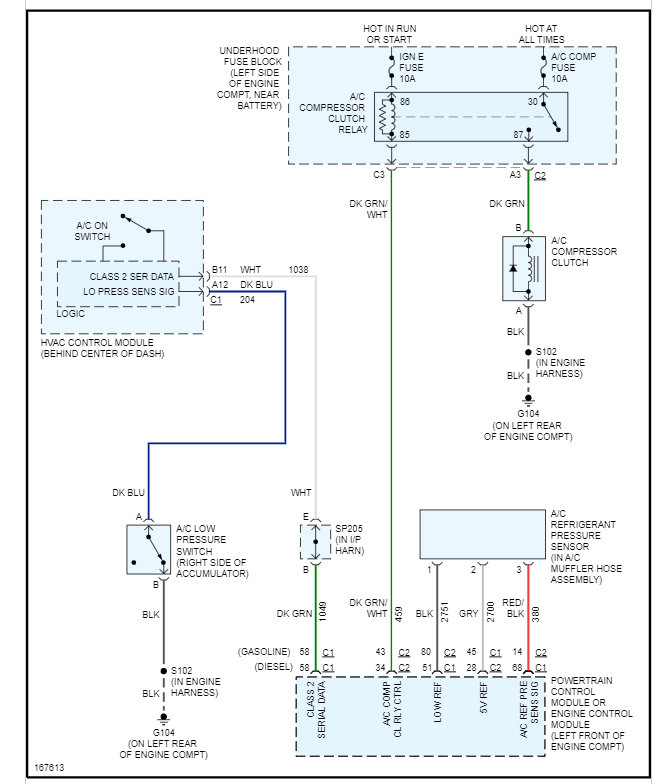

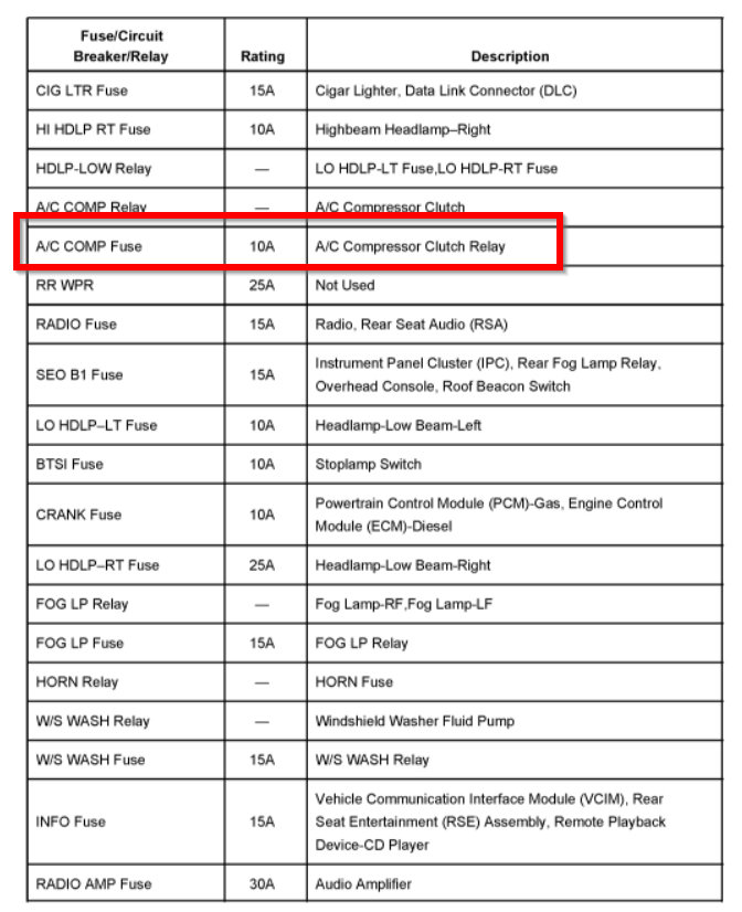

Update: The A/C fuse keeps blowing. I put a test light on the ground wire on the plug going to the compressor and it lights so I have ground from PCM. When I check for power, I have no power. I jump the relay then I get power on A/C plug.
I’m going to ohm out compressor to see if clutch is bad. But could a bad low pressure switch cause fuse to trip or most likely the compressor is bad?
May 8, 2022 at 8:15 AM
Okay. Just to be sure, you are getting the A/C compressor fuse (shown in the diagram below) blowing?
If this is the fuse that is blowing then yes, it is the compressor. If you look at this circuit, then the compressor/relay is the only thing on it.
So, unless the relay is shorted to ground (unlikely) then the compressor is the only thing on the circuit that can cause this. Basically, what is happening is you have a path to ground prior to the load on this circuit which is the compressor. So that is the clutch as you stated is shorted.
