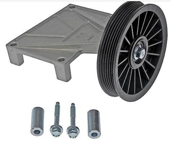

The inner ring is moving so the compressor itself isn’t seized, however the pulley that the serpentine belt sits on is locked up and actually threw the belt. I found out it was seized when I tried to put on a new belt. What’s the cheapest/quickest way to repair or bypass the A/C?

It sounds like you are having an issue with just the A/C compressor clutch being froze up. The compressor can still be good but just the compressor clutch just needs to be replaced. You can also find a company called Dorman that makes a dummy/bypass pulley that goes in place of the compressor and allows you to use the stock size belts/serpentine belt. I've attached a picture below of a dummy/bypass pulley.Hope this helps and thanks for using 2CarPros.

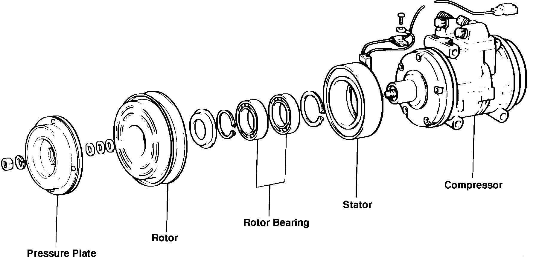

If the compressor is still good, then it must be the compressor clutch that has locked up. The best thing to do would be replace the A/C compressor clutch assembly. Here are directions. The attached pics correlate with the directions.

Fig. 1 Exploded view of compressor clutch assembly. Nippondenso 10 cylinder
1. Using socket and suitable holding device, remove shaft nut, Fig. 1.
2. Using socket and tool SST No. 07112-77010, or equivalent, remove pressure plate.
3. Remove shims from shaft.
4. Using suitable snap ring pliers, remove snap ring retaining pulley.
5. Remove pulley from shaft by carefully tapping with plastic hammer.
6. Disconnect stator lead wires from compressor housing.
7. Using suitable snap ring pliers, remove snap ring retaining stator, then remove stator.
8. Remove bearing snap ring from pulley.
9. Using SST No. 07110-77011 or equivalent, press out two bearings.

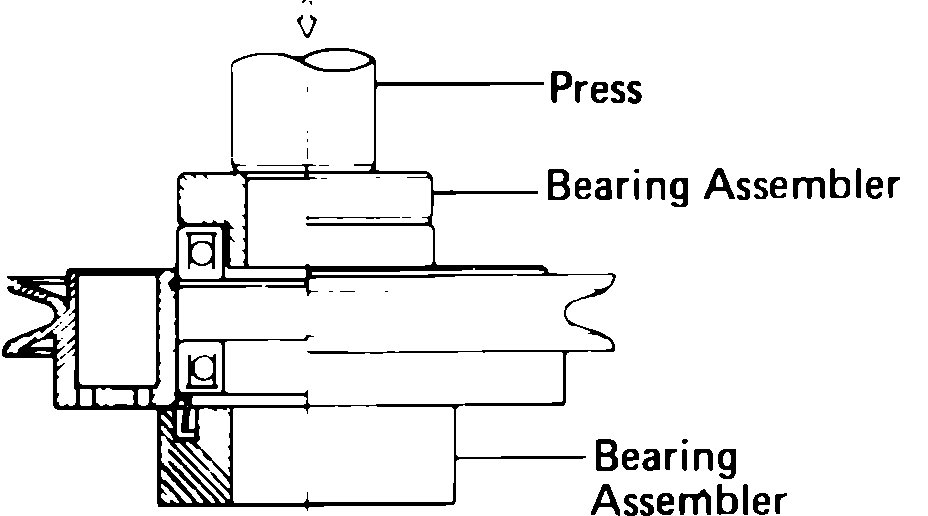

Fig. 2 Installing bearings in rotor. Nippondenso
pic 2
1. Using SST No. 07110-77011 or equivalent, press shield ring and two new bearings into pulley boss until fully seated, Fig. 2.
