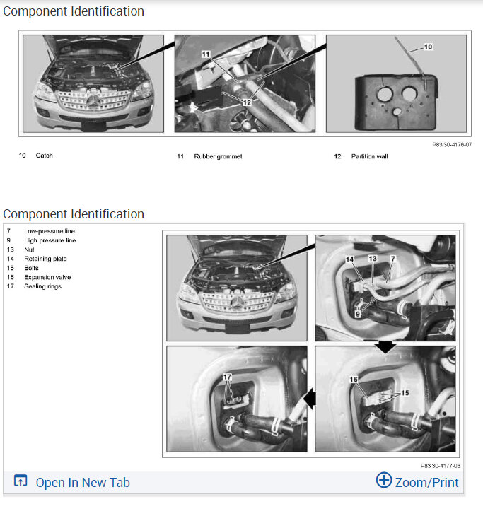

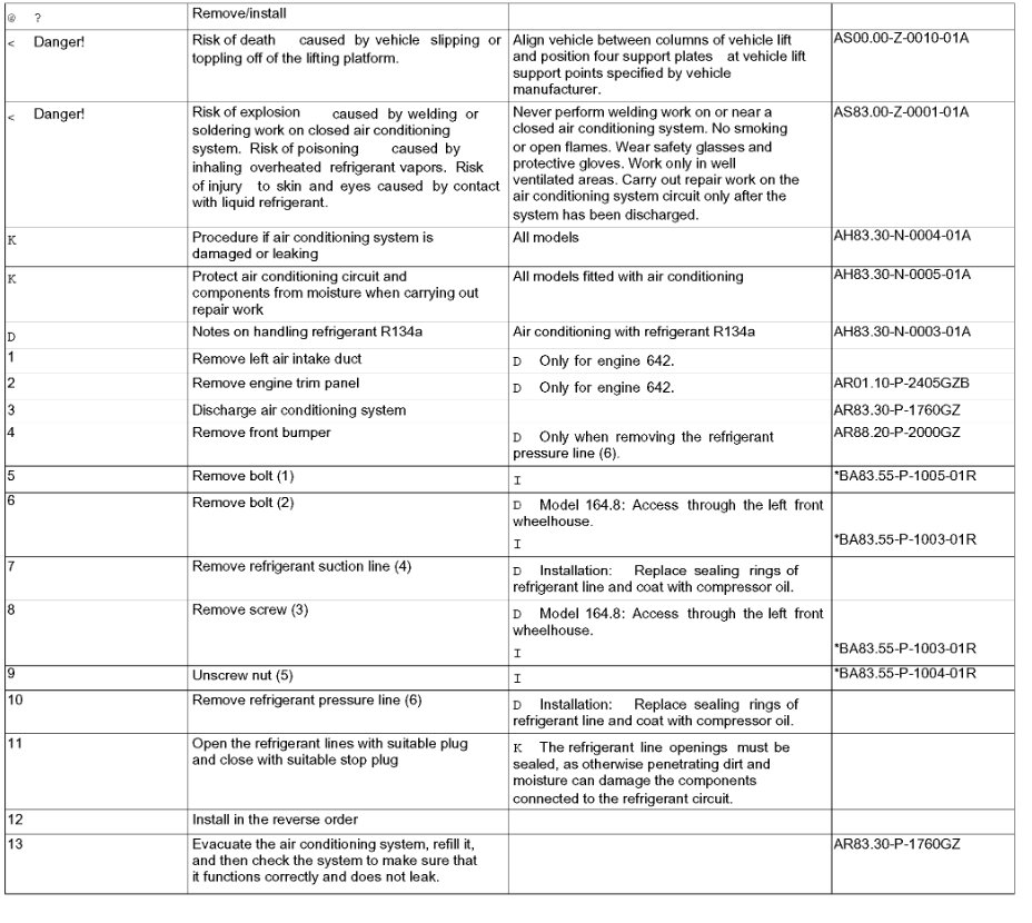

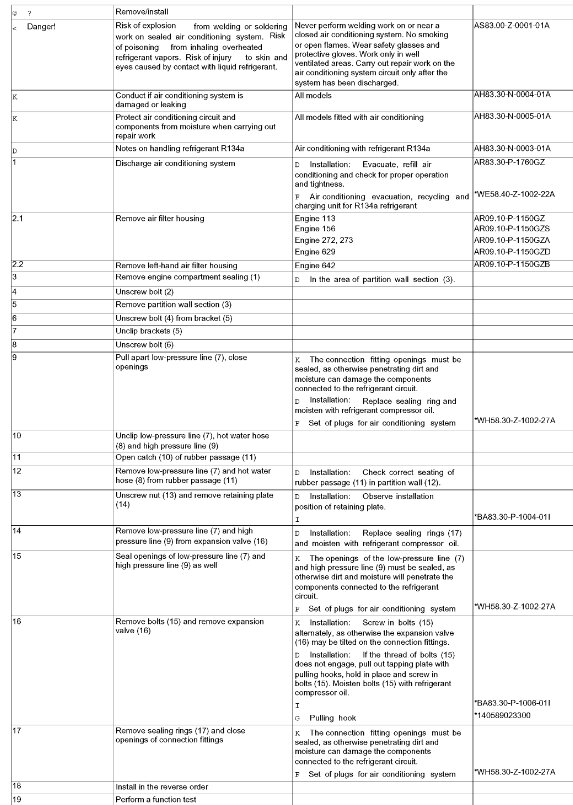

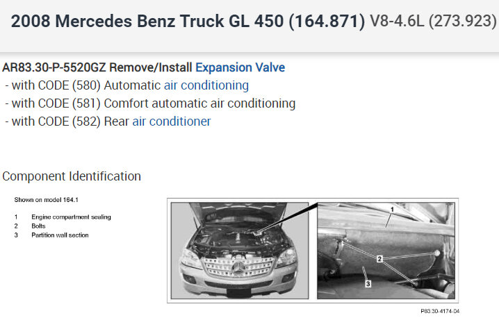

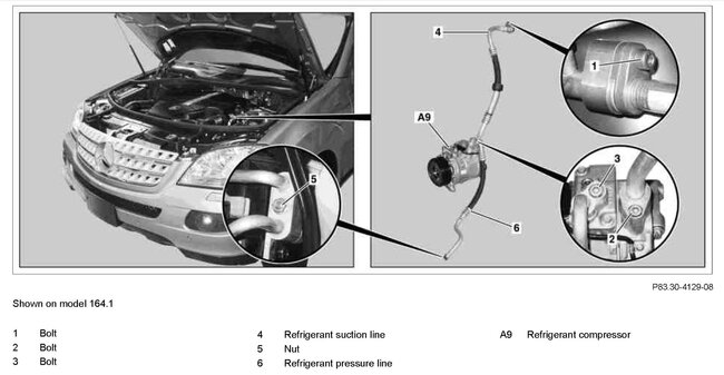

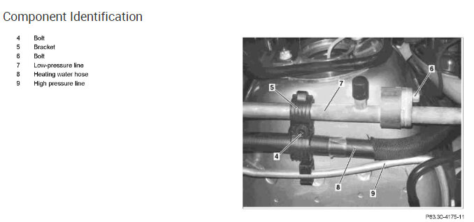

If the compressor came apart internally it will spread metal and seal material throughout the system so it will need to be flushed and the expansion valve replaced. Can you tell if there is debris inside the refrigerant tubes? Here is a video to help with the job and how to change out the compressor and expansion valve.
https://youtu.be/4EqdrBVb0sY?si=tqE2yNp1wekpSNq3
Check out the images (below). Please upload pictures or videos in your response of any problems so we can see what to help you with.
